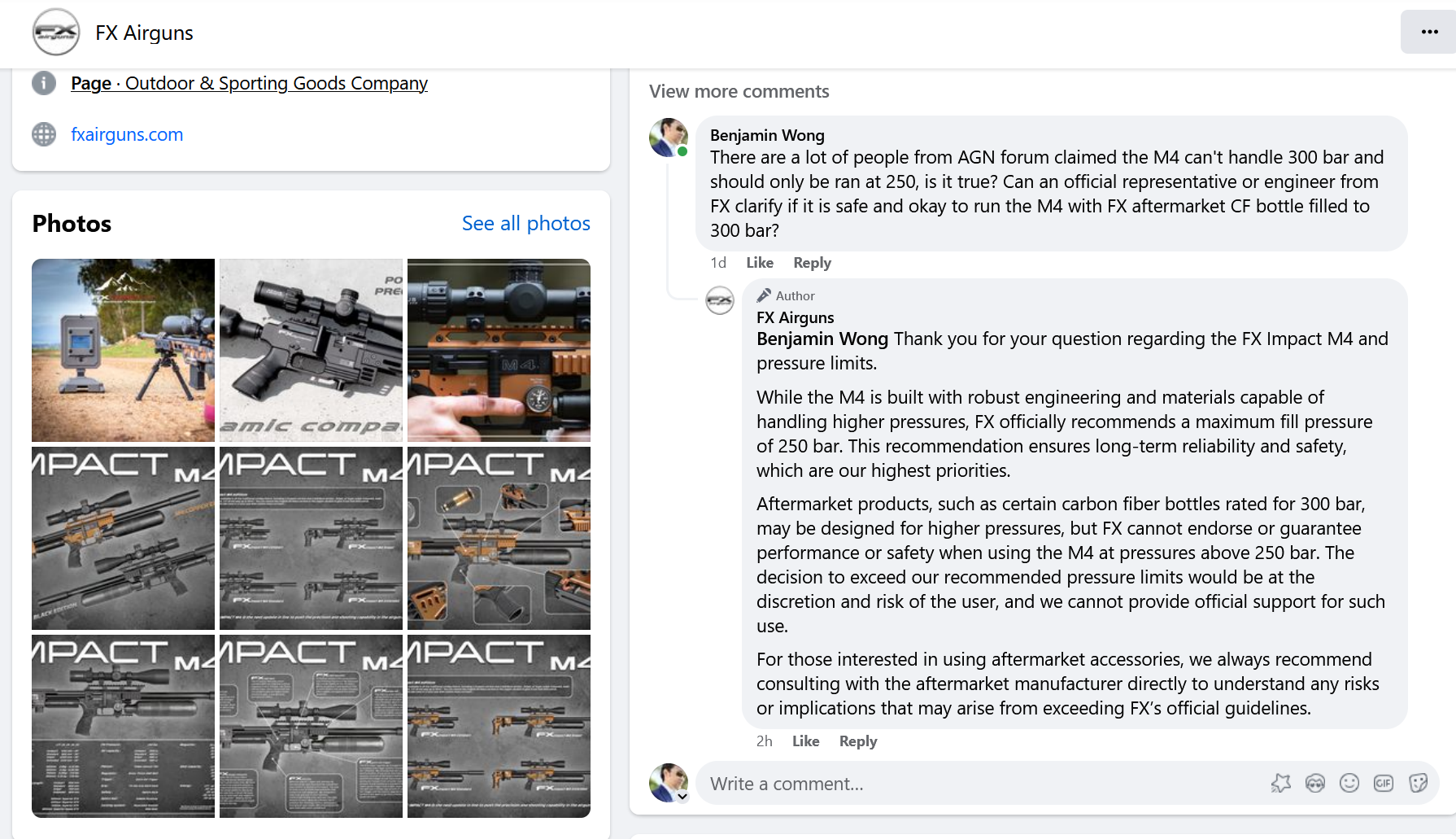

FX confirmed it, the Impact M4 is recommended to operate up to 250 bar only, regardless of what other retailers said.
I won't risk damaging my brand new M4 so I'll keep the 580cc spare bottle at 250 bar to use for the M4 even though the bottle is rated for 300. 😁
Pyramid Air and other mainstream retailers should take out or reword their tech note and warn customers about it.

For longevity and reliability sake i'll definitely stick with 250 bar max for sure. It's just so weird for FX to be selling and advertising FX branded 300 bar bottles that we can't safely use on any of their own designs, a bit misleading especially when retailers like Pyramid air made a tech note giving new customers the impression that it's fine to run the M4 at 300 bar with aftermarket bottle.
