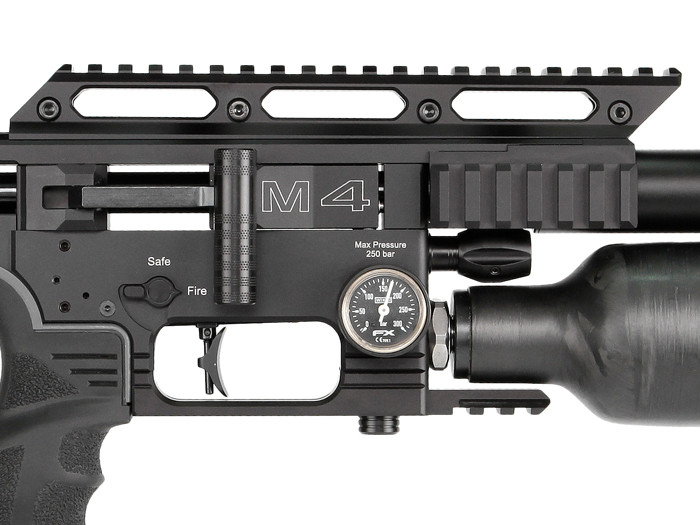

The latest manual did stated that, which makes it even more confusing, we have all the reputable retailers telling us the M4 with 1 reg will run 300 bar just fine, I guess FX really need to clarify and clear things up once and for all, if the manual was a misprint, or are we being given the wrong information.
In this day and age it's hard to imagine a $2K PCP gun with solid brass regulator can't handle 300 bar while there are MANY others have been running it just fine, even the $499 Avenge X is rated at 300 bar with no problem. 50 bar may not sound like much, but a 480/580cc bottle that could mean a few magazines worth of extra shots for .22 😁
With that said, for those who love having 2 regs, how difficult is it to add the 1st reg back into the empty slot? just need to get a Huma reg along with a gauge and they should fit back in without much effort?
I contacted FX directly to clear this issue up, several retailers appear to be providing poor information:
My question to FX:
Message: Hi, I'm not sure where to direct my inquiry. I just want to know if I can install a 300Bar bottle on an FX Impact M4 & fill it to 300bar without any additional changes required? Or is there additional work required such as an additional regulator needed or not etc. If you could let me know it would be much appreciated. Thank you
FX's reply:
Hi,
To mount a bottle with 300bar you need to install a first regulator that is mounted on the Impact M3. It has art.no 20540 Bottle connector Impact M3. Also manometer for the first regulator. You see this on the exploited view on the Impact M2 here in section D F10370-Impact-M3-230925.pdf (fxairguns.com)
Like it or not this is the advice directly from FX & not via a middleman or other 3rd party. I know people have connected 300bar bottles already to the M4 on the single reg and they report it works fine, but what we don't know is the long term affects this could have on the rifle or its components.
If people choose to not listen to the advice from FX and void thier warranty because they've connected a 300 bar bottle on a single reg that's of course thier choice, however, if their regulator or another component is ruined in the next 12 months they only have themselves to blame.
Seeing as the 1st regulator and manometer are so easy to install and relatively inexpensive, i'd just do it, I'd set the first reg to 230 - 250bar. This way you know the 300 bar pressure has been dropped down already for the 2nd reg and a pressure its been designed & rated for, plus you'll get the benefit of the extra shot count.
I hope this helps

Thank goodness, despite all this bean counting, and cost cutting, FX still laser etch's fine details right on the side of the rifle!
You know,...very important things like " MAXIMUM PRESSURE 250 BAR" , right there in BOLD, right next to the gauge!
Otherwise, a uneducated, over zealous user, might attempt to fill to 260, 270, 285, or even something wild like say 300 bar, then latter complain that FX's are junk, and that the quality of FX's regulator and valve assemblies, have gone down hill, and are not working properly!
