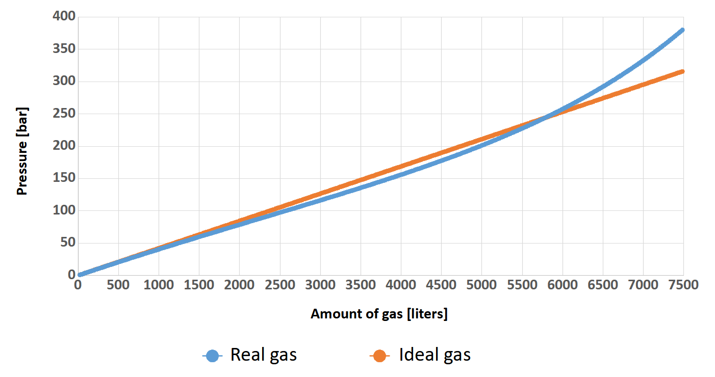

The real gas charted is SCUBA quality air.
Notice that in the beginning you get more volume of air per bar than if it were an ideal gas until you reach the transition point between 230 and 250 bar where it takes a greater increase in pressure for the same volume gain.
The drawing is a compression curve from a dive shop manual.
Buy 700 bar (not shown) the real gas curve reaches a slope of 82° and the volume gained per increase in bar is nearly zero.
During decompression from 300 bar, you get a large drop in pressure for a very small amount of volume used.
Very interesting. Thanks for posting this. It’s nice to learn something and would definitely explain some things I noticed with my Leshiy classic that I do occasionally fill to 300b.

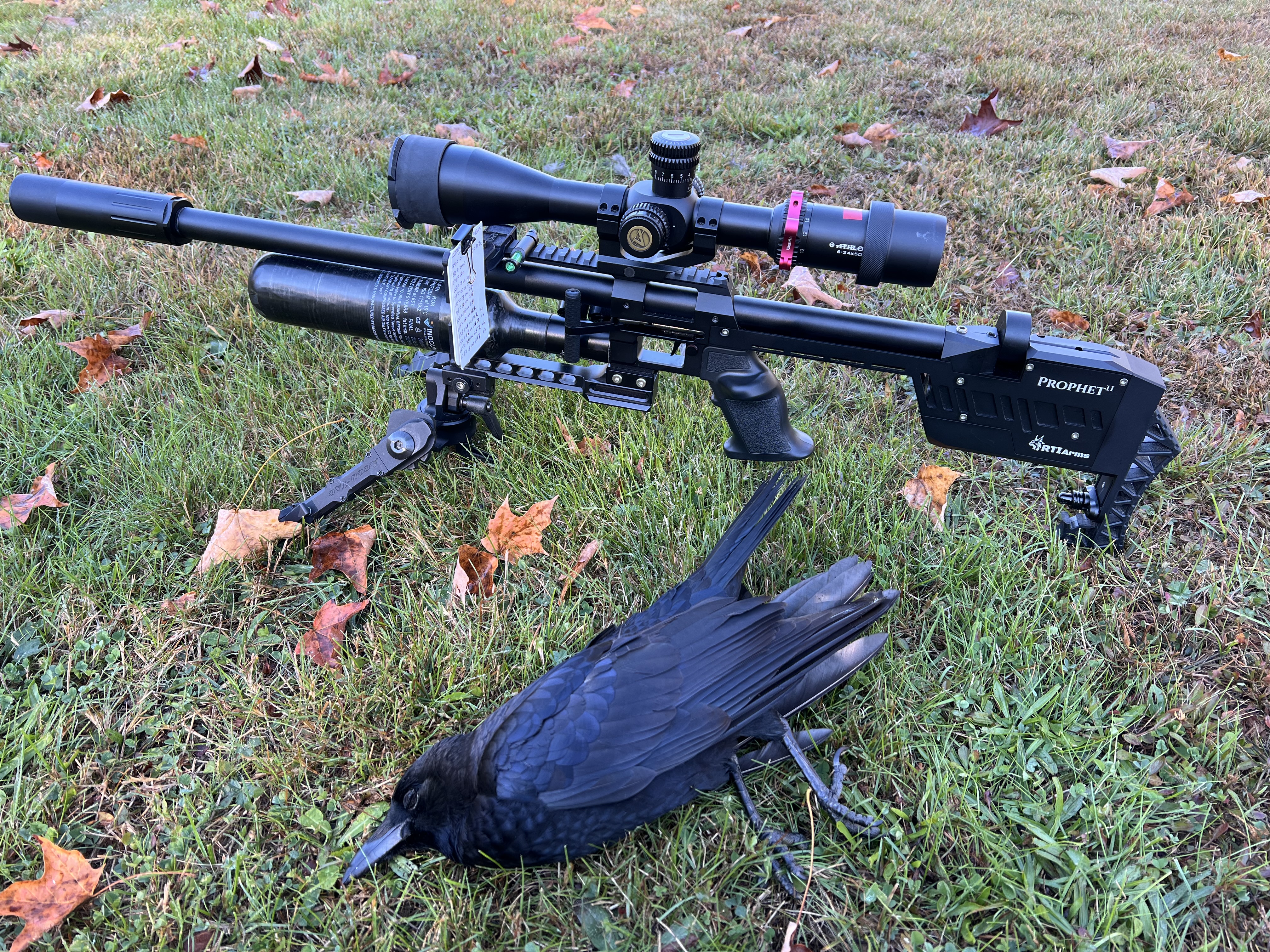

Was hunting this morning and my first opportunity was a crow. I ranged it at 139 yards. This gun hasn’t been shot in at least a week. Dialed my scope and placed one in the center of its chest with a .30 slug. This topic came to mind. Try placing your first slug out of your Impact into a 1.5” zone at over 100 yards after your gun sits for a week. I can probably save you the trouble because in all likelihood, your beloved Impact won’t do it. After you get it warmed up, then maybe it will do it more times than not. Good hunting gun vs great hunting gun.

Then prove me wrong. Let your Impact sit a couple days and cold shot that sucker at a target. Do 100 yards. You can cheat 40 yards. You don’t even have to post how it does. Or maybe you already know.
I perfectly understand when guys love their Impacts. I do too. I have three of them. But you asked about guns that are basically a firearm. No shots in the dirt. No making a few adjustments before you start to impress yourself. Well a RTI is one of them.
