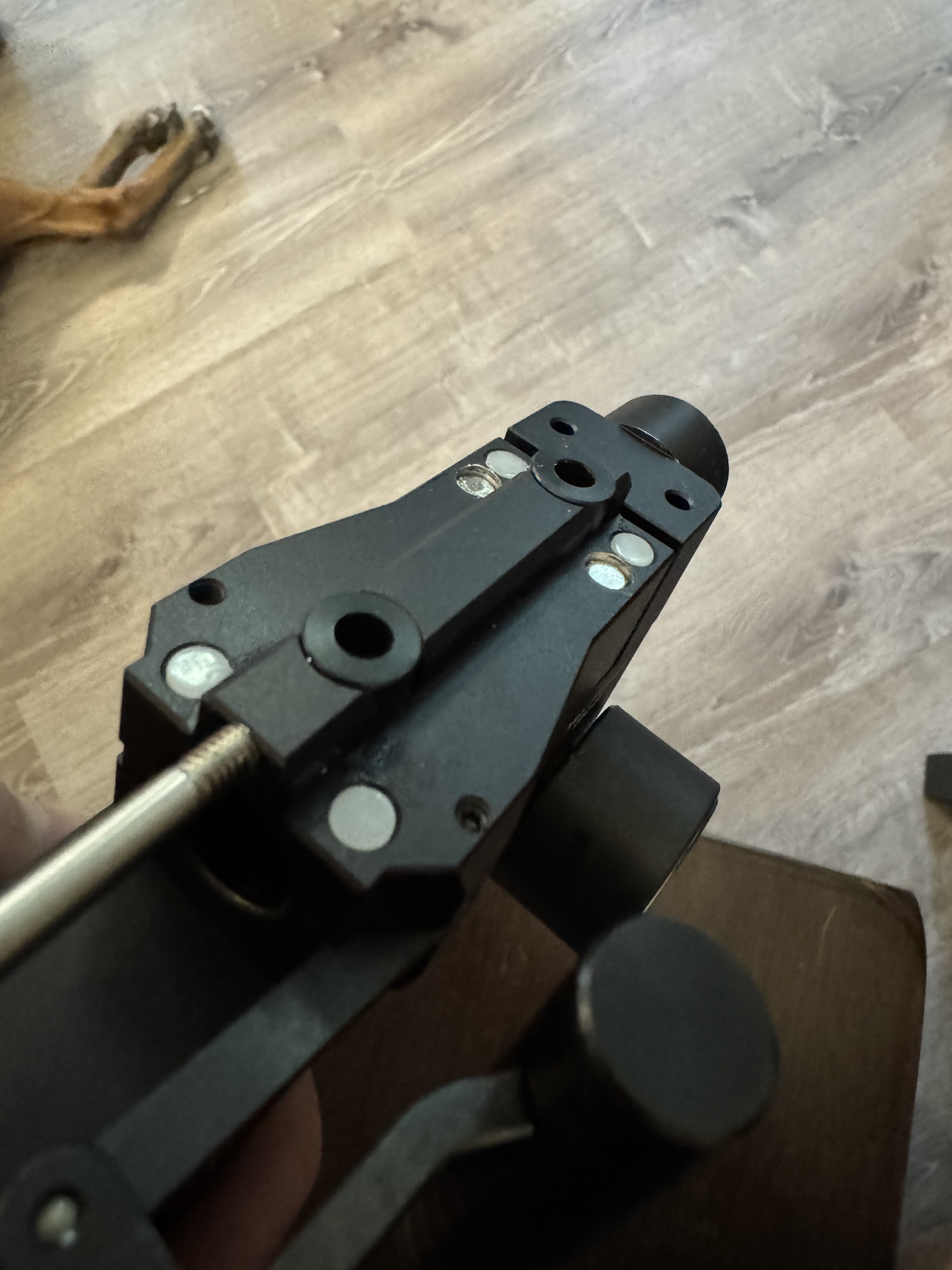

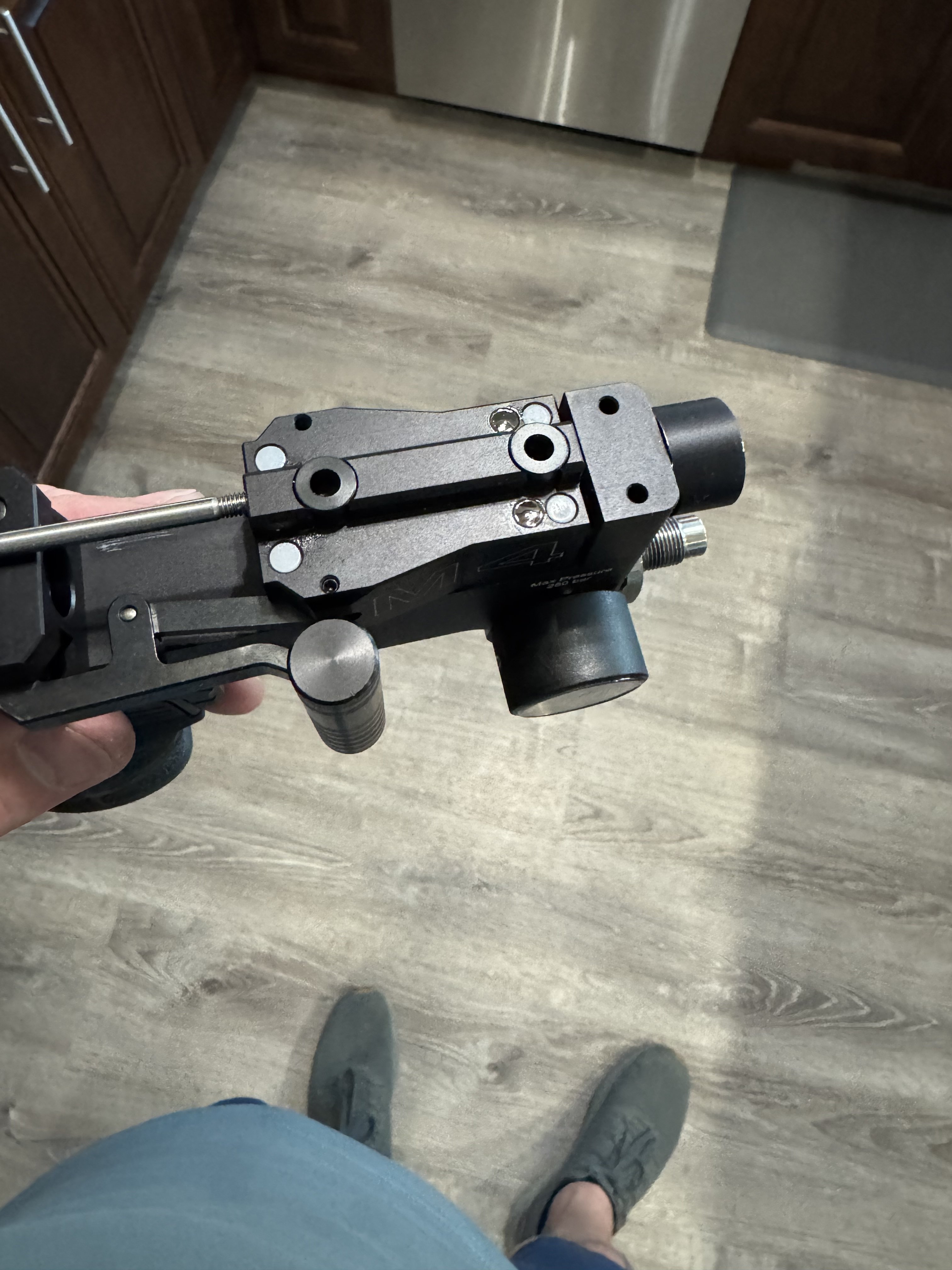

Hey guys. My new M4 was barely cocking and then about 20 shot in it stopped cocking all together. How would I fix that? Settings are as it came out of the box. Pictured below. Shooting 18.1 at 890 FPS. Not great groups at 38 yards with JSB and FX. Was about to try AEA but won't cock now. (also see mystery screw I found on Patio a few posts down).
I had the same issue, and I wanted to tackle the problem myself. It looks like FX milled the magnet hole too deep in the reloading block and the top rail. The magnets have a small dab of super glue to retain them in place. Both of my magnets on the top rail came loose on the super glue, which then acted like a key tumbler to restrict the block from moving forward.
I reglued the magnets and applied epoxy to the tops of the magnets to fill the void, ensuring the magnets did not come back down within the void to restrict the movement.

View attachment 483757View attachment 483758

I don't think it has to do with magnets he said the hammer wasn't cocking or staying cocked but I could be wrong won't be first or the last time
The magnets slip down into the lower area and restrict the entire assembly.
It could be another issue he's having, but from his photo, I'm assuming it's the same issue.
If the trigger mechanism weren't holding, the block would not stay open as the spring tension would overcome the magnets.
Sorry a little slow today I remember reading about the magnets falling inside after I read ur post
