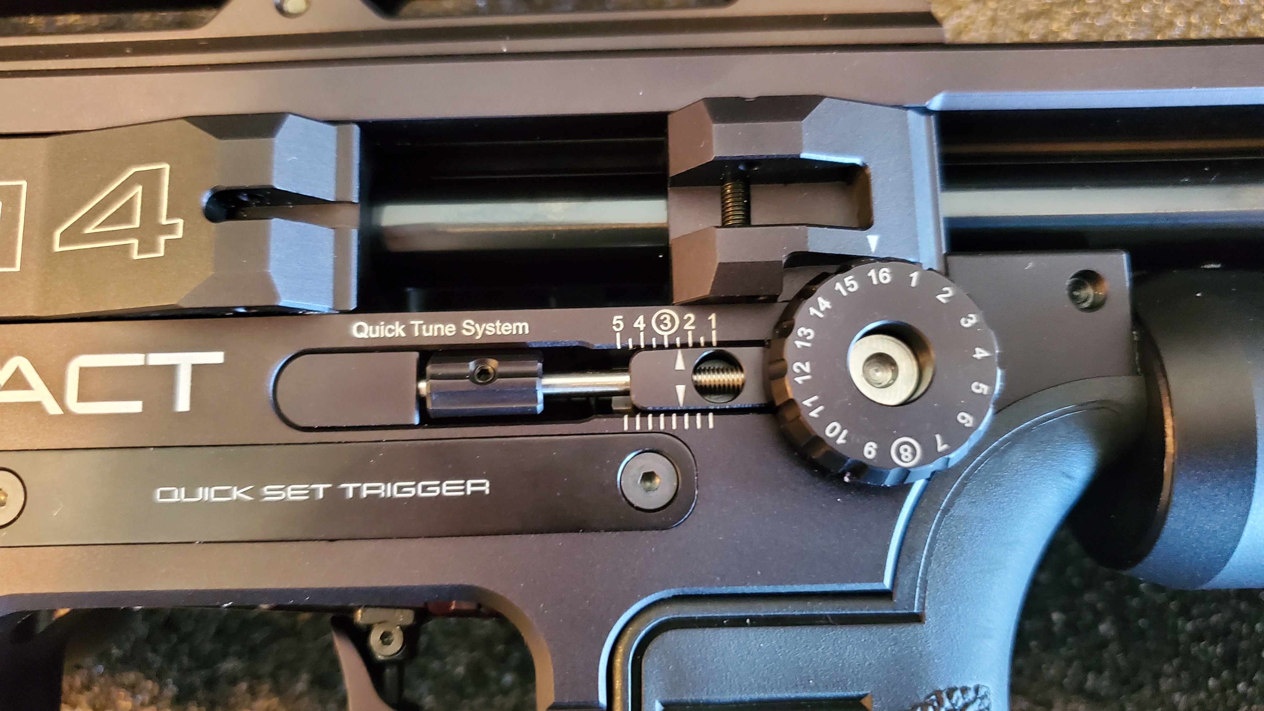

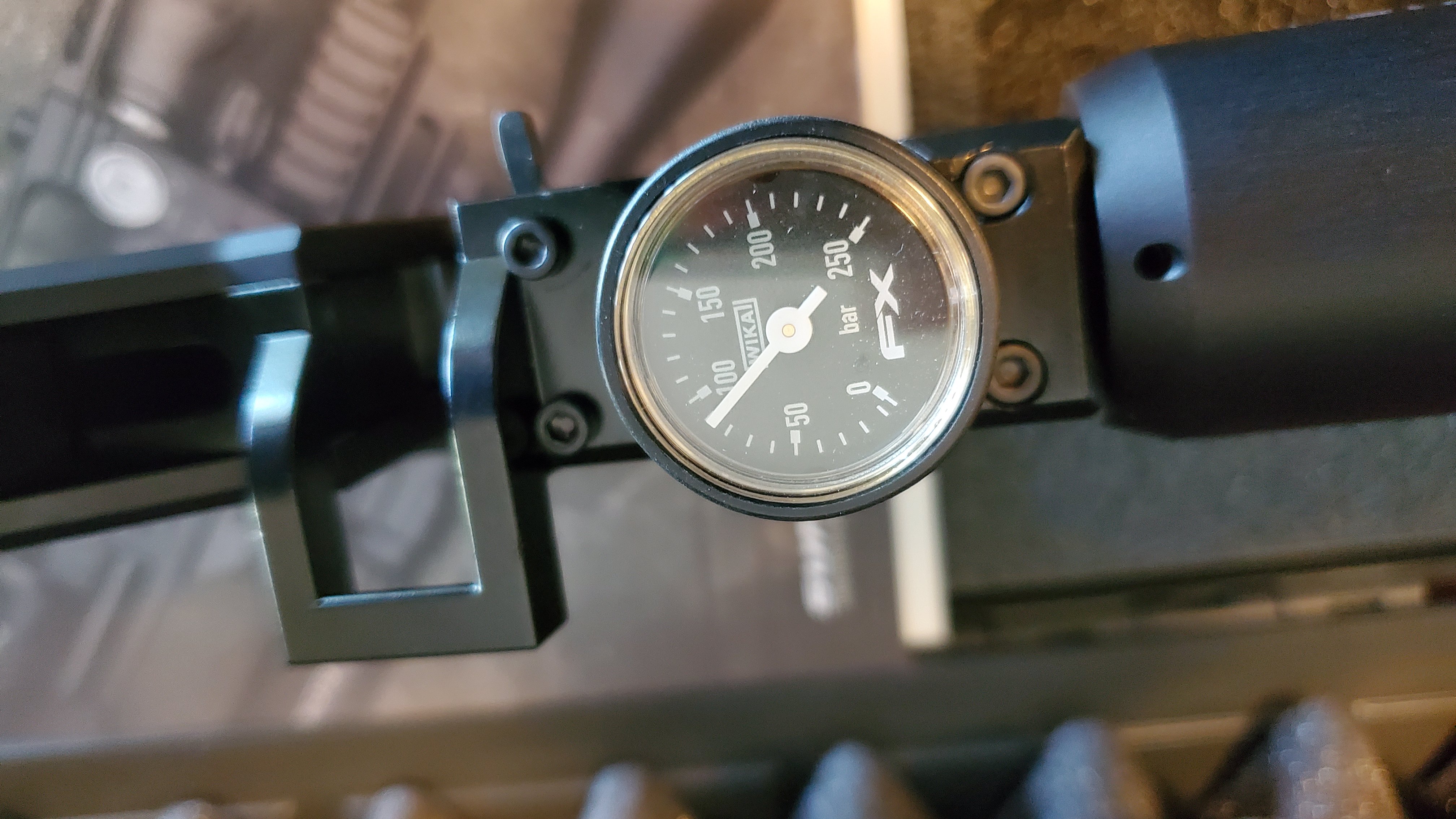

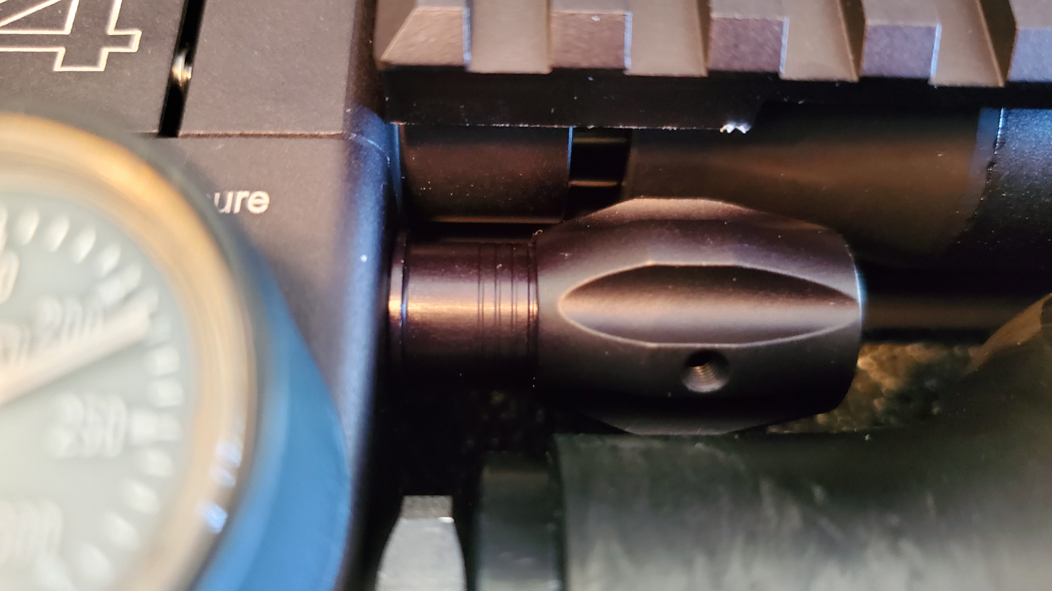

Hey guys. My new M4 was barely cocking and then about 20 shot in it stopped cocking all together. How would I fix that? Settings are as it came out of the box. Pictured below. Shooting 18.1 at 890 FPS. Not great groups at 38 yards with JSB and FX. Was about to try AEA but won't cock now. (also see mystery screw I found on Patio a few posts down).
View attachment 482568View attachment 482570View attachment 482569
Mine doing same thing it's just springing forward won't cock to even load a pellet and I paid $35 for a custom tune from Utah Airguns for the 25.39 grain Hades monsters hammer was on 5 and 115 reg when i got it why wouldn't they notice the cocking problem when they Tuned it. It did it first time cocking it and still doing it calling them tomorrow
