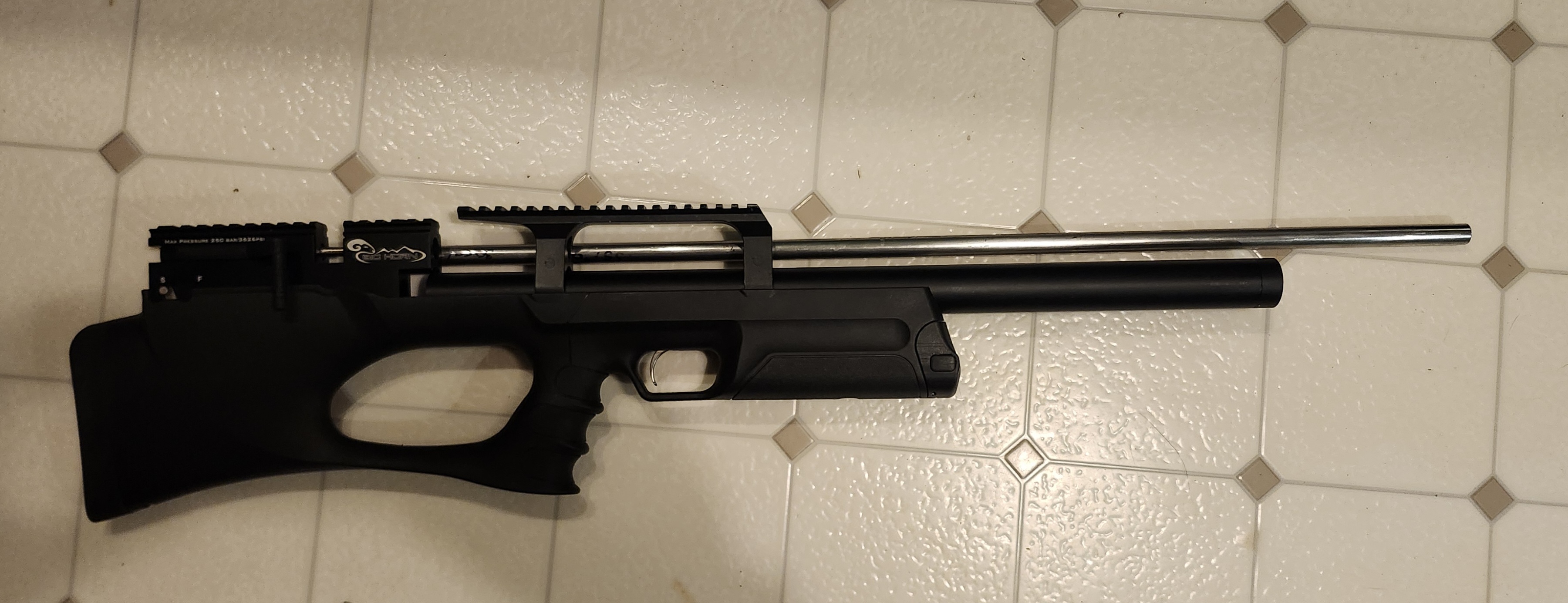

Rough mockup but as soon as I can get my hands on some FX DRS airtubes this is a 7lb bullpup at 36" long capable of over 100ftlbs in .30 with less than 10 orings, a 28" TJ hammer forged barrel and capable of sub MOA at 100 yards with a good shot count for about half the price of an FX Impact. Would be shrouded with a 1/2x20 adapter for a suppressor.
