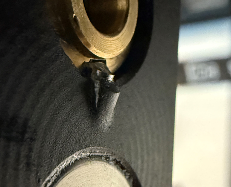

Looking closer I see what looks like a small lug, thinking it should be there i try again.
When i take a picture i see that it isn't a lug, but looks like the barrel has been pushed in too far and pushed through, see picture.
Not sure how this could happen, perhaps dropped on the barrel?
That is your probpem, as you can clearly see the barrel is not even fully seated. That will require a new valve house.
It sure looks like the barrel has been pushed in HARD, as in dropped on the muzzle. Is there any evidence at the muzzle?
Barrel not being fully seated as i pulled out slightly in the first attempt to clear. There is no evidence of being dropped which IS strange. The silvery metal piece that can be seen is probably the location log for the barrel. The block is metal, so must have been decent hit. I guess a return here. Thanks for your observation.
