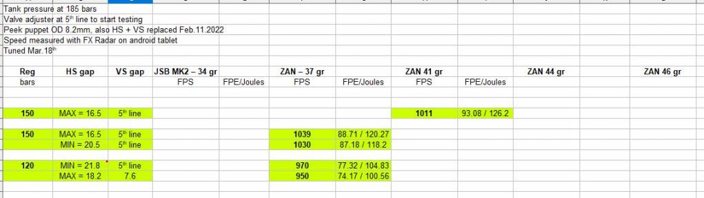

{First I must say I was working on my .25 Impact MK2 power upgrades for over a year, re-machined porting and a lot of internal custom mods...and I have a booklet where I document every little change}
I just did my last tune today, I wanted to know the max power available to me because I have a collection of 41, 44, 46 grain slugs (in .25) and I want to shoot these longer ranges.
So I started with 41 grain and then 37 grain, from a MAX power and coming back downward with the pressure and adjustments...here are my numbers:
At 150 bars on the Reg I still had about 2mm adjustment left on the Hammer Spring, I don't even want to speculate where I would get with 41 grain but assume I shall be able to push 44 grain over 1000 fps.
My goal is to shoot 46 grain at least 950 fps.
I gave you another day my peek puppet measurements. First I had it @ 9.2mm OD but that was restricting the air flow too much inside Valve House, so recently (in Feb) I re-cut it to 8.1mm. And this resulted a huge jump in power I busted the 2mm oring on the Valve Rod...jumped out of hole...The C1 I didn't had a rubber ball, but now I learned ;)
