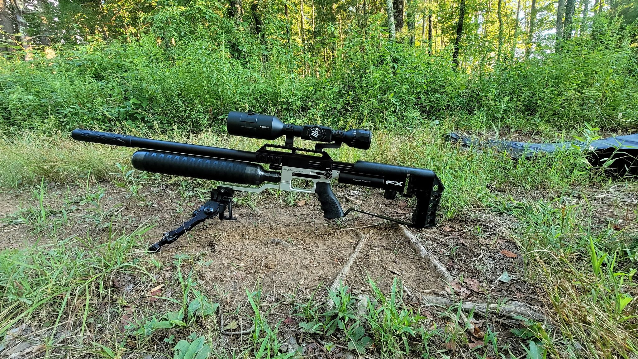

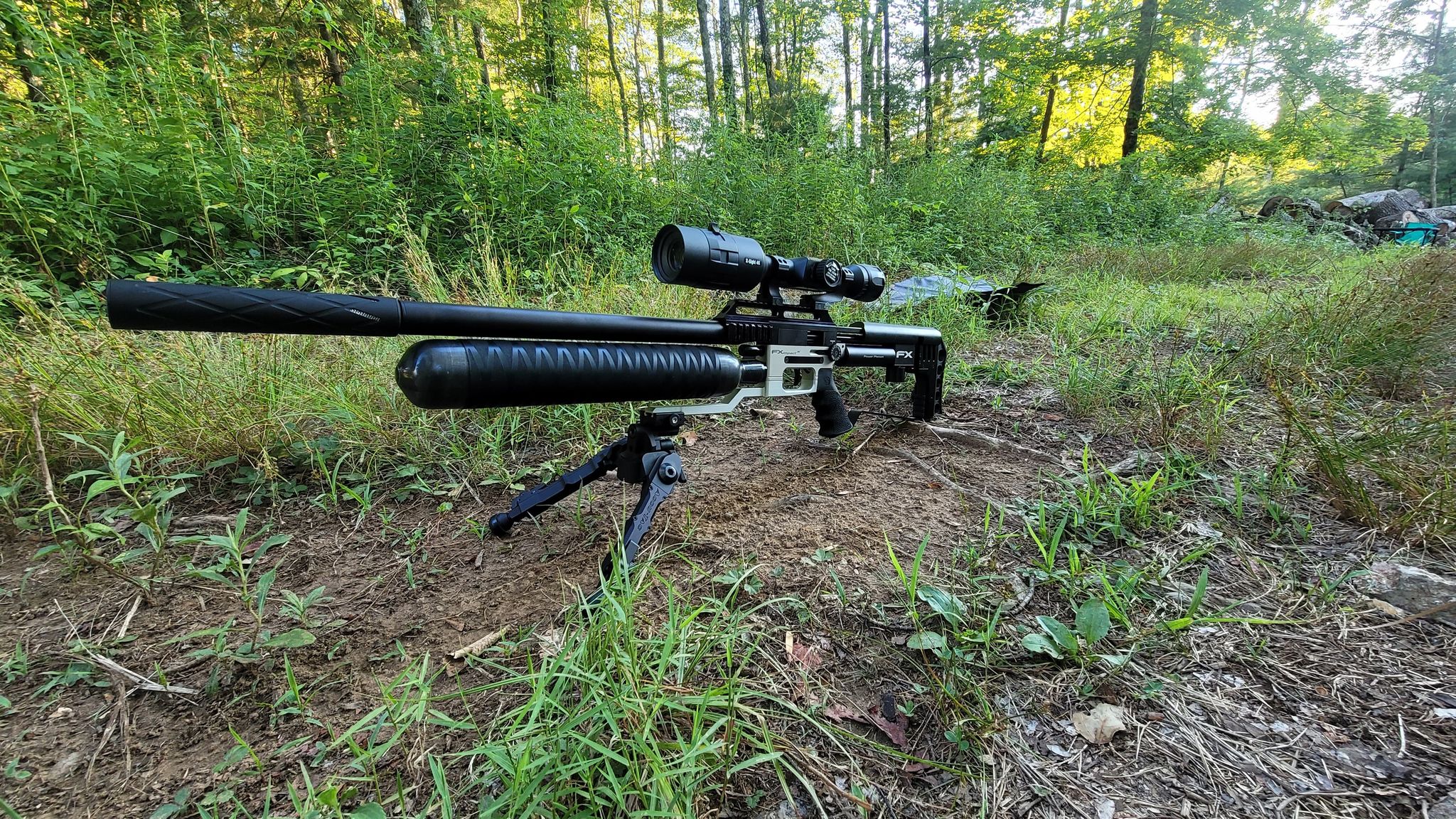

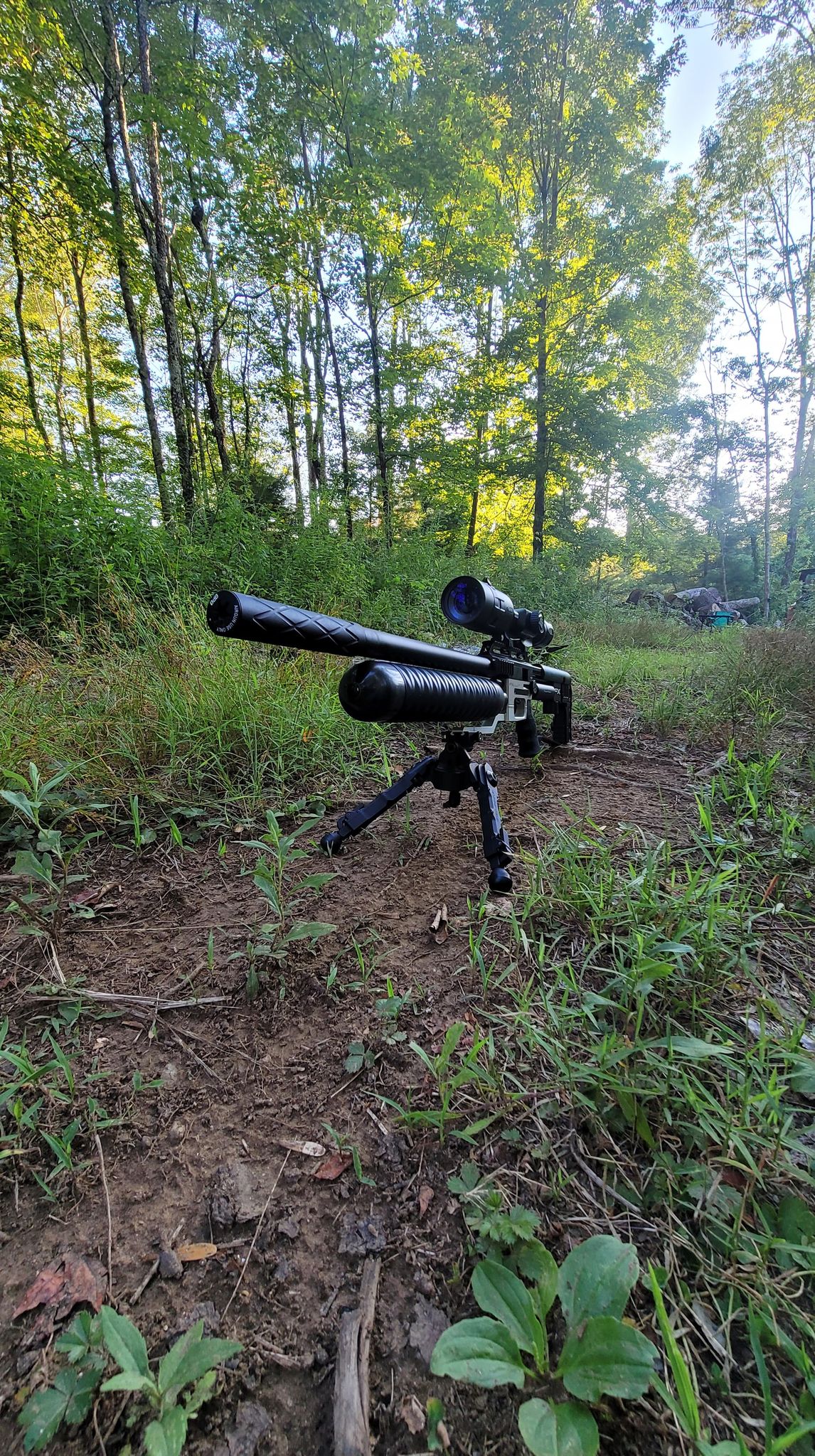

FX Impact MK2 700mm .22 700cc 75 FPE!!! build done. lol
I was going to have this thing custom cerakoted and whatnot , and maybe in the future I will take it apart and still have that done but for now its going to see field use so I just threw a black top rail on, kl ex trigger guard, 700cc bottle w/ wrap, and my ATN 5-20 on it.
It also has : Huma high flow probe, huma slug power kit (lighter of the two hammer weights installed), huma extra pressure reg, and huma transfer port along with 2 digital gauges, all of which I installed myself, had one small leak through the atmospheric vent hole but sorted that out and its good to go :)
It is running the HEAVY SLUG LINER with CF sleeve w/ the ernest rowe style barrel tensioning rear screw.
Reg is at 180 bar , 2.5 lines on the valve, and 5 on the hammer spring adjuster
Shooting Zan .218 30.5 slugs at 1055 fps. Need to test accuracy next at the range with this setting, for some reason the reg is just at 180, screw bottomed out so I can only bring the reg up from here , maybe thats just the nature of the huma extra pressure reg.

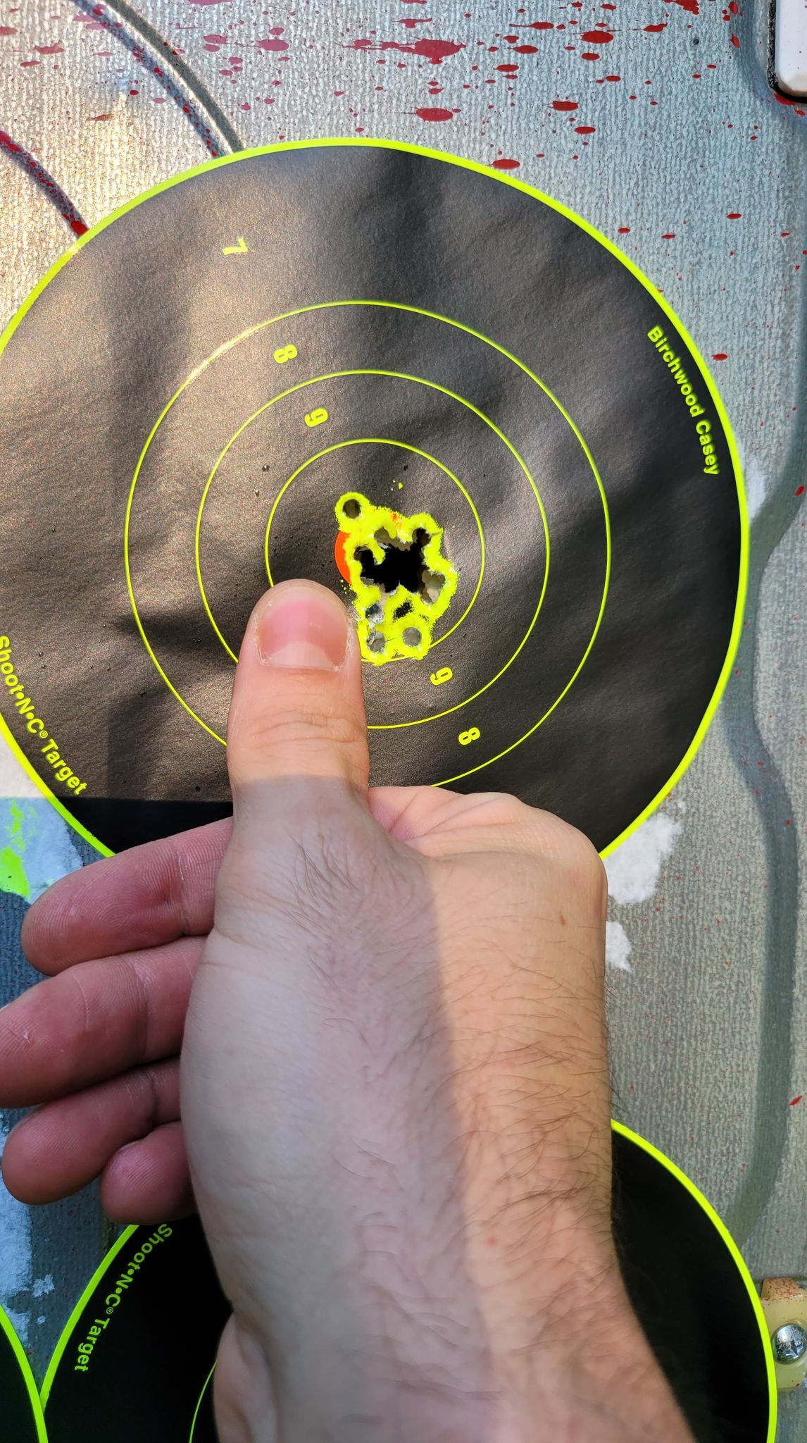

I got a really good group the size of a quarter out of my whole magazine of 29 rounds. I think the new regulator is still settling in. Heading to the range to test out 100 yards and hopefully further if 100 goes well.
Those bottom 2 were during the adjusting of the power wheel so I am going to discount those.
This is through max magnification on an ATN Pro 4k 5-20 which im having a hard time being impressed with
Yeah, that surely supports leaving it set at that power level.
You may tweak and fiddle a bit to tighten it up a fraction, but I would be chuffed as all get out with those results and would leave well enough alone myself.

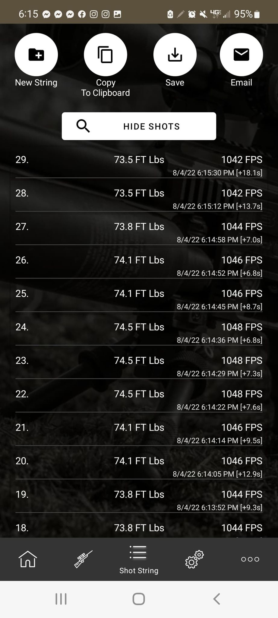

At this rate of speed I do not think the ES is a big deal? I do believe as I shoot more rounds this afternoon it will even out more. I only have 60 shots through this reg. What I am most impressed with is from 250 bar to the 180 bar the reg is set at , I am getting around 45 shots above reg. That to me, is awesome!
