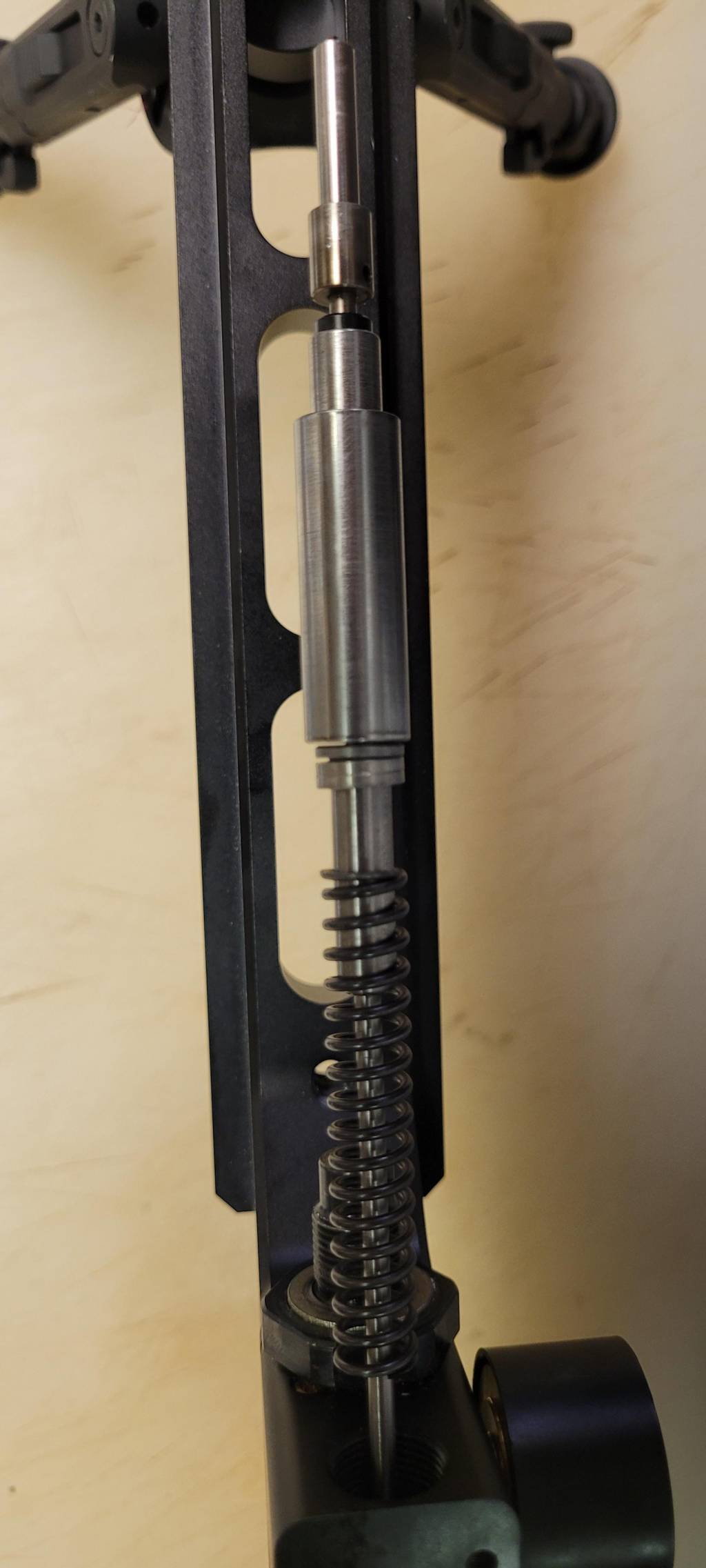

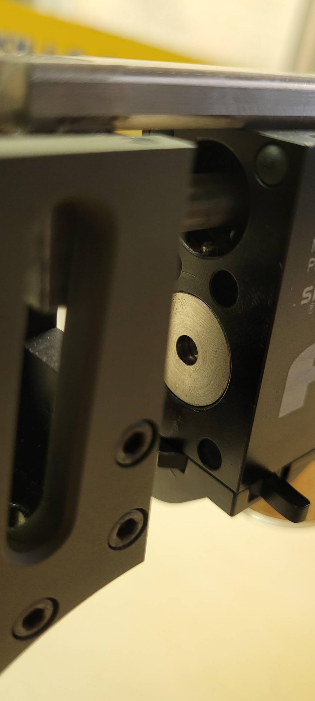

Ran into another issue. After replacing the o ring on the valve and the ones for the power plenum, I started piecing everything back together. Everything went well until I got to the install of the spring, hammer and hammerseat. The valve rod isn't going all th way back unless I push it back. This is how it sits now
There's a springy-ness to it and I'm now sure why
These are what's on the valve rod along with the upgrades from the power slug kit, am I missing anything?
