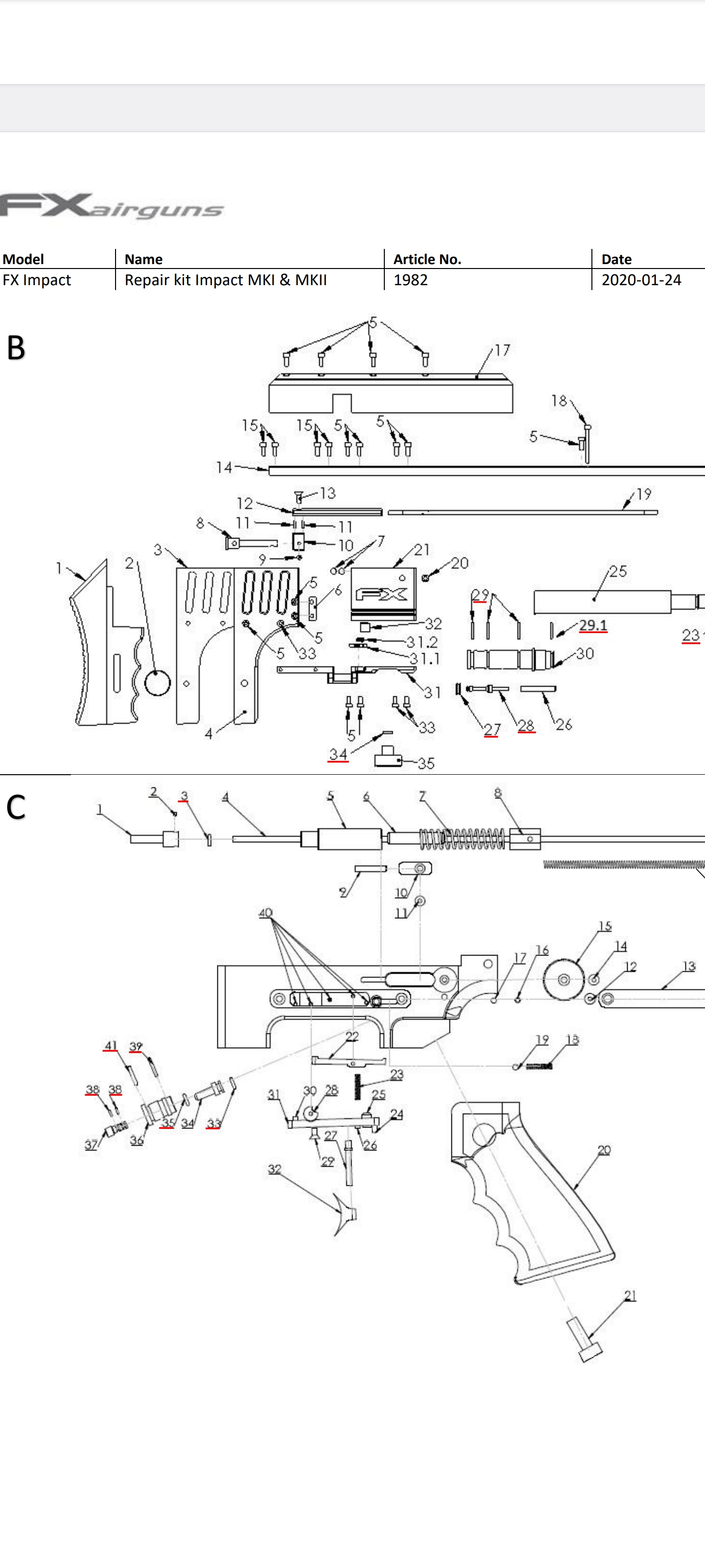

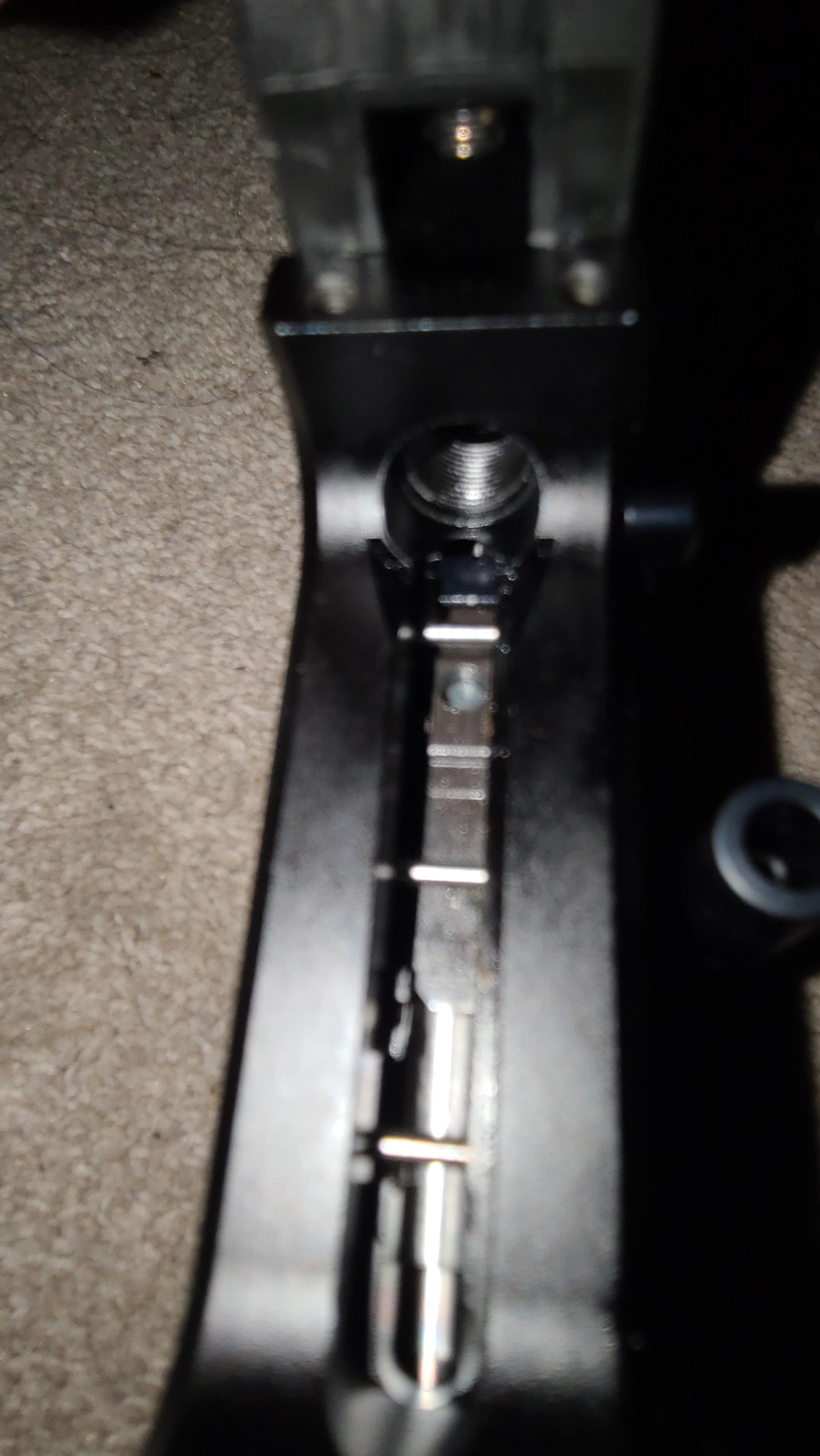

So I am getting small leaking from the atmosphere vent hole. The only thing I can think of is the o ring inside where the reg sit. Or could it be another different cause? Well anyway I took the o ring inside where the reg sit out and compare it to all the o rings I have and none fit. They were either too small or too big. Does anyone know what size the o ring is? I look at the part diagram and can not tell which it is. Can anyone tell me what part that is on the diagram?

It’s one of 3 Orings. One down in threaded hole. The one in the very bottom of the reg or the one on the bottom of the piston. The one in the threaded hole and the one in the bottom of the reg are an utter PIA to deal with.
ok thanks. I am going to replace the o ring inside the thread hole where the reg sit first. If that doesn't work, I will replace the other 2 you mentioned. Sure I can just replace all 3 but trying to do one at a time and see what is actually causing it to leak.
