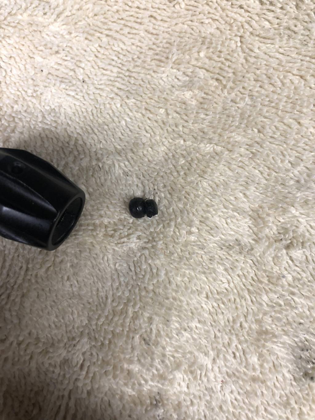

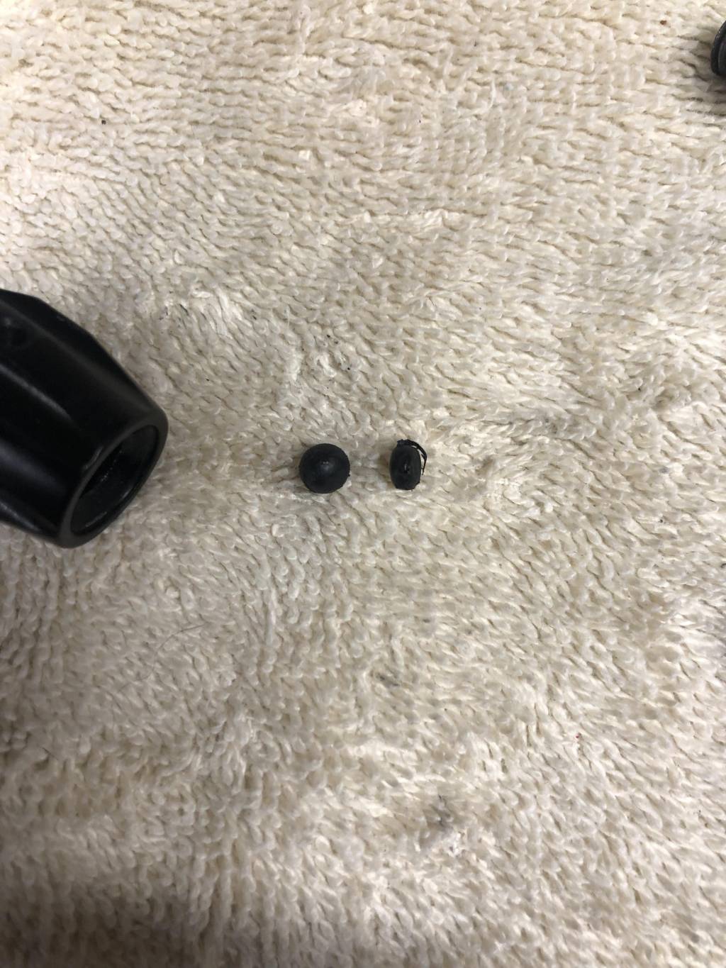

I think these rubber balls within the valve knob of the M3 has to play part in velocity swings and first shot problems. For the ones that don’t know, these
balls in 4mm and 4.75mm back to back are responsible for shock absorbing onto the striker that the C1 hammers on. You can see the 4mm ball is near flattened, and the 4.75 one partially flattened. What I noticed is after leaving them out for awhile they start to retain their original shape somewhat, which leads me to believe that’s a shorter valve rod throw after the guns been sitting, then as they start to flatten shot after shot, the valve rods throw is now longer.
I used to boast low extreme spreads, like 5 FPS in 36 shots and 14 FPS in over 90 straight shots, then I noticed over time my low spreads started to widen. There was also more of a jolt up front following the shot.
ive since replaced these balls with DURO 75 viton, solid rubber cord, that fits perfectly within the inner walls where the balls would go into. My consistency is back and the sound rapport of the shot has dropped some. I’m now staying steady between 1010 and 1016 shooting the monster redesigns in 22 cal
