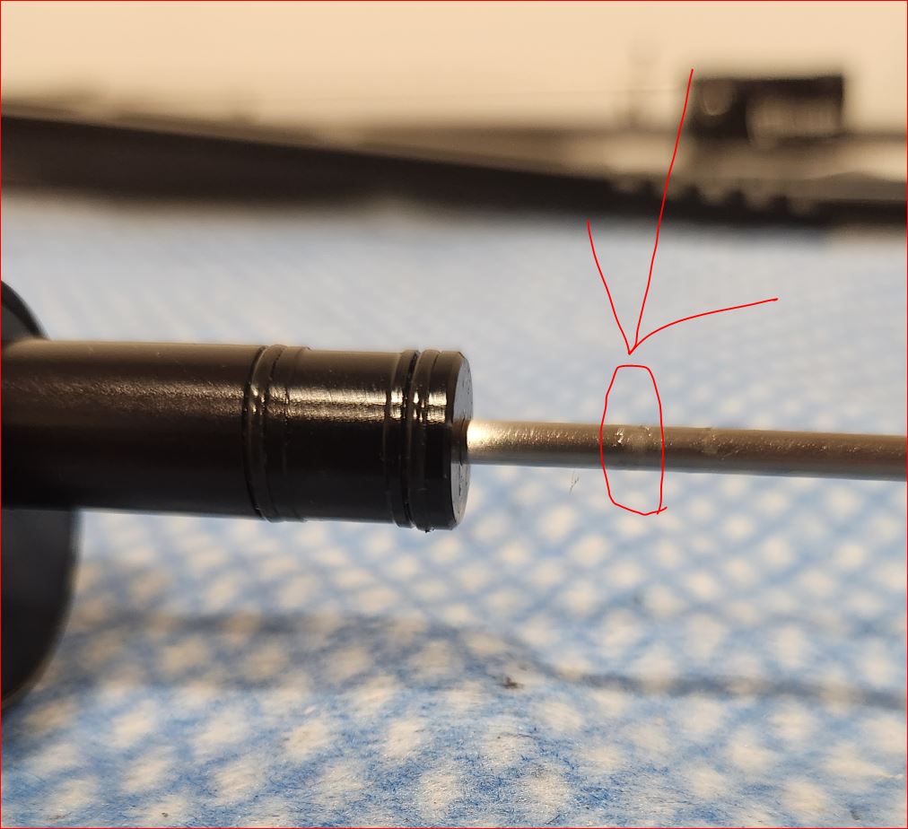

No oring sticking to it if you mirror polish this location ;)
That's what I did to my 720/power block up grade to my PP M2. I got the 100 fps back I lost when I upgraded (?). I came real close to reinstalling the original PP as the first shot was slow but after that no problem. Ya know, Fx could make our lives much better if they just would instead of making it tapered make it flat like the peek washer accomplishes. Yes, instead of just buying standard drill bits to drill the passage they'd have to maybe use a long 4 flute end mill.
