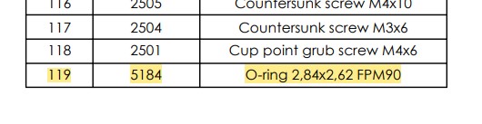

The FX Impact M4 parts drawings are out. Look what they for the valve rod O Ring. Although it says FPM 90, I think its a FKM 90 oring. Unless someone can confirm that FPM 90 exists.

I understand that FKM, FPM and Viton are almost same.
I still understand that this may improve the things a bit but the real issue is the design flaw that persists.

I’m having some good consistency with the peek spacer and FKM 90 oring. Better than what it was. I can’t make your modification using the MK1 nut and FX will never modify it, so I’m left with the spacer and Viton oring.

Hi guys. Yes, I noticed that change as well from PUR90 to FKM/FPM/Viton 90. Do you think they saw this topic?
They know almost every weakness but fix it when a lot of users complain, just like they have introduced better trigger in M4.
But still I believe that the front part with front screw is much better solution.
Just saw this as to the change from PUR. This makes me think that the M4s with the 15 warmup shots actually got old plenums with PUR and the “good ones” that don’t have the issue as severely got the updated orings. Next time I have the gun apart I’ll try to confirm what I have in mine…

I ordered from Mubhaur the special aluminum plenum part and ik must say it is working great. With the original part from FX ik had with the first shot a lost 88 fps. It took 6 till 8 shots to get the 871 fps. That was my tuning for .25 m3. Now the first shot is 865 fps en the second shot straight 871 fps. So i happy with with this special made part all the way off Pakistan!
