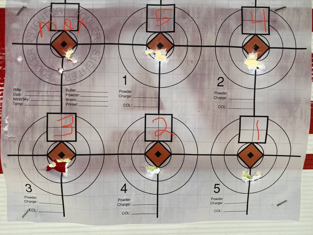

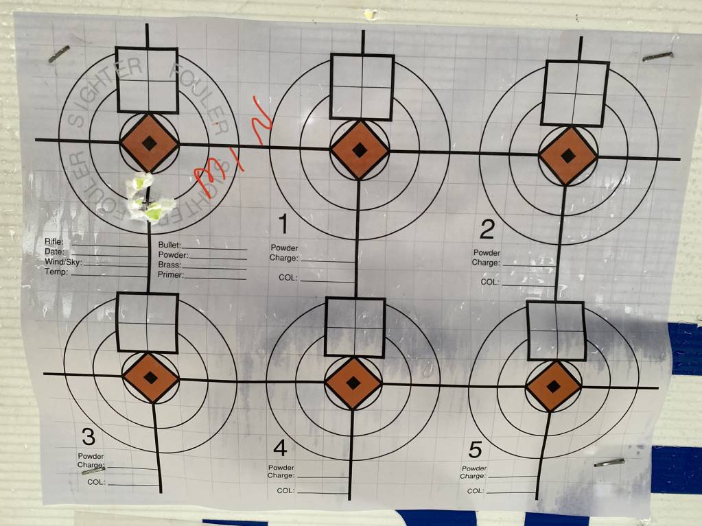

Tomorrow is range day, time to shoot groups at each power setting to find the sweet spot.

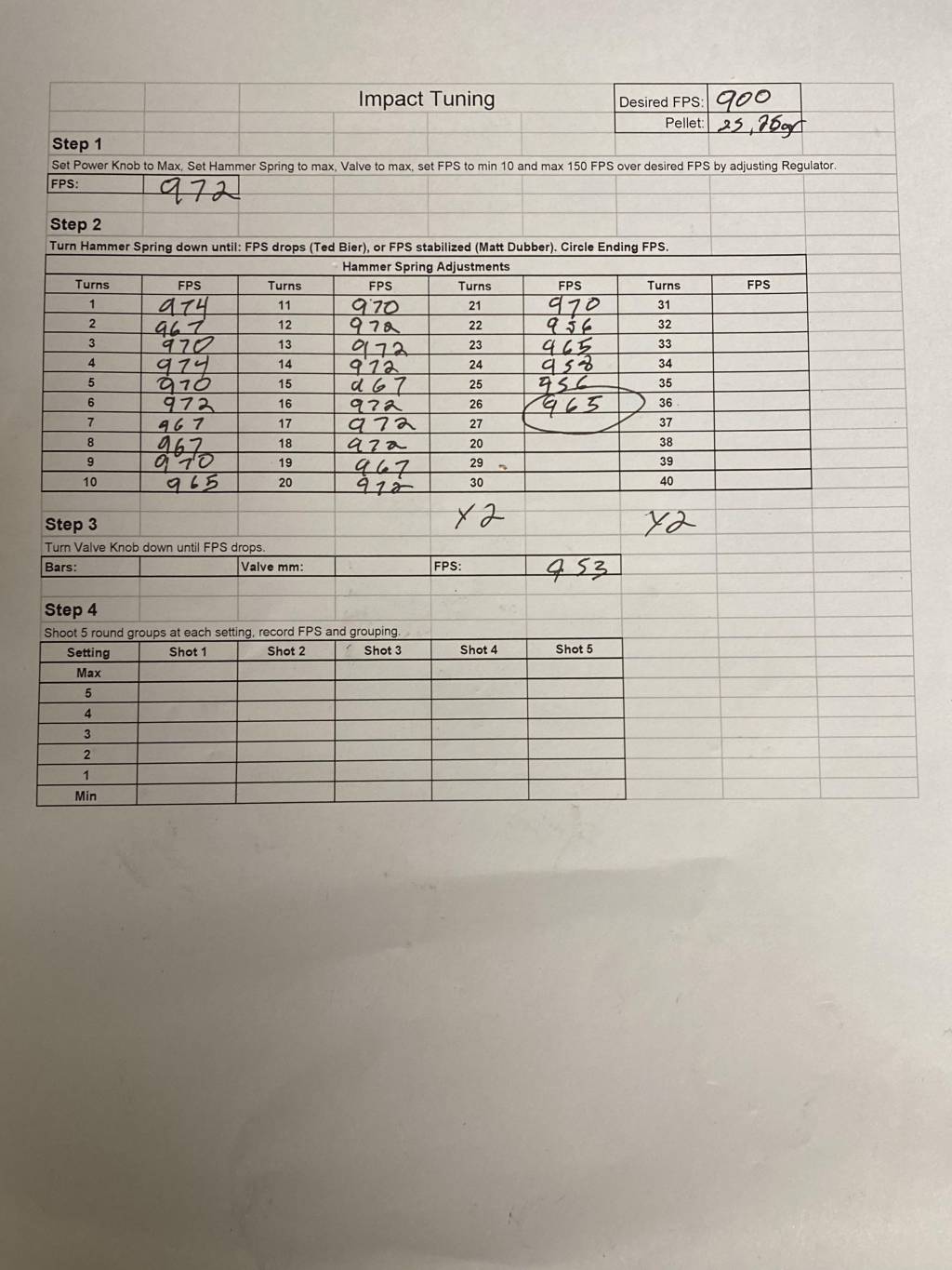

I made this little spreadsheet to track tuning.

Hammer Spring was wide open, until after adjusting reg pressure, starting at 972fps, I lowered HS until FPS started to drop about 10–15 FPS. I then closed Air Valve until FPS dropped again, 10-15 FPS. On MAX setting, I’ll get around ~952 FPS with the Kings.
