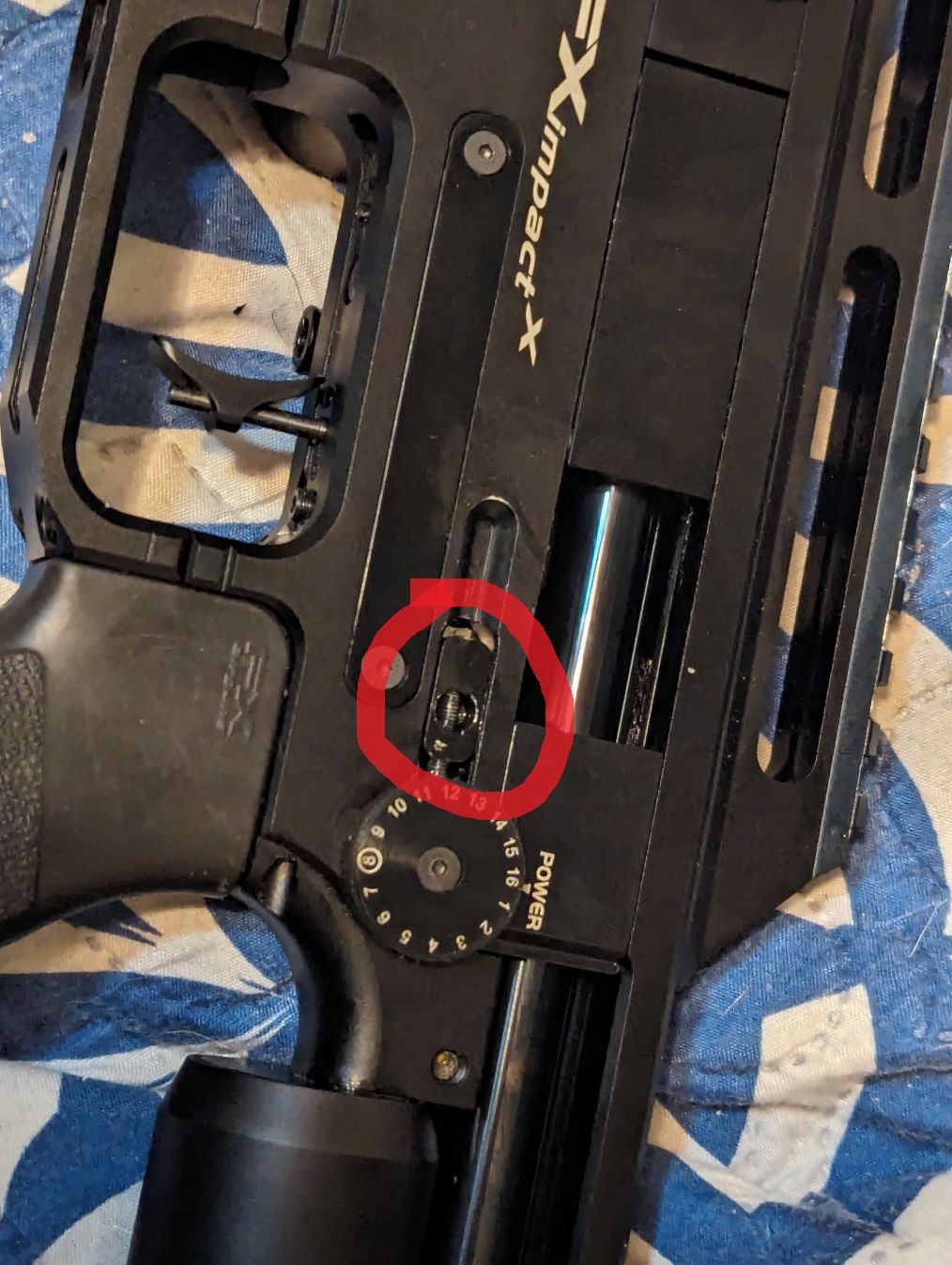

Hi everyone,
I need some help getting the stripped hammer tension grub screw out. It is known as the C9 on the diagram.
Just installed the 720 PP wiith Power Block. I went to tune it and found the stripped grub screw.

The 1.5mm head stripped, or the threads on the screw stripped? If it's the head for the allen you might have to cut it out. If it's the threads you may be able to apply pressure to the block it's threaded into while backing it out and maybe it'll catch. Either way I believe you'll need to replace the block and screw.

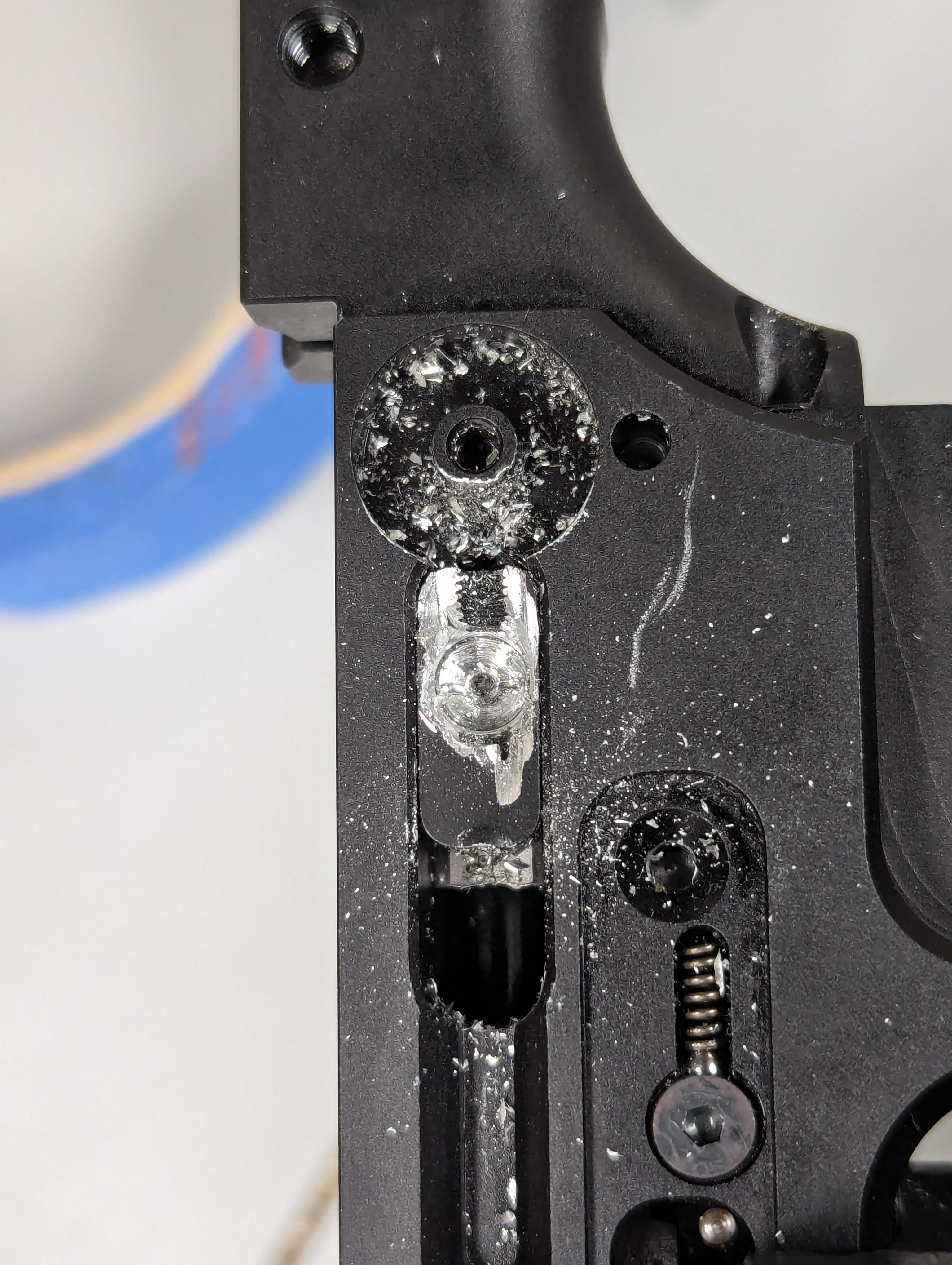

In order to remove the block you have to remove the adjuster screw. So I believe your only way is to dremel a slot in the aluminium block to remove the adjuster screw. I don't imagine that little block being too expensive, but it is an FX rifle soo I'm not sure.

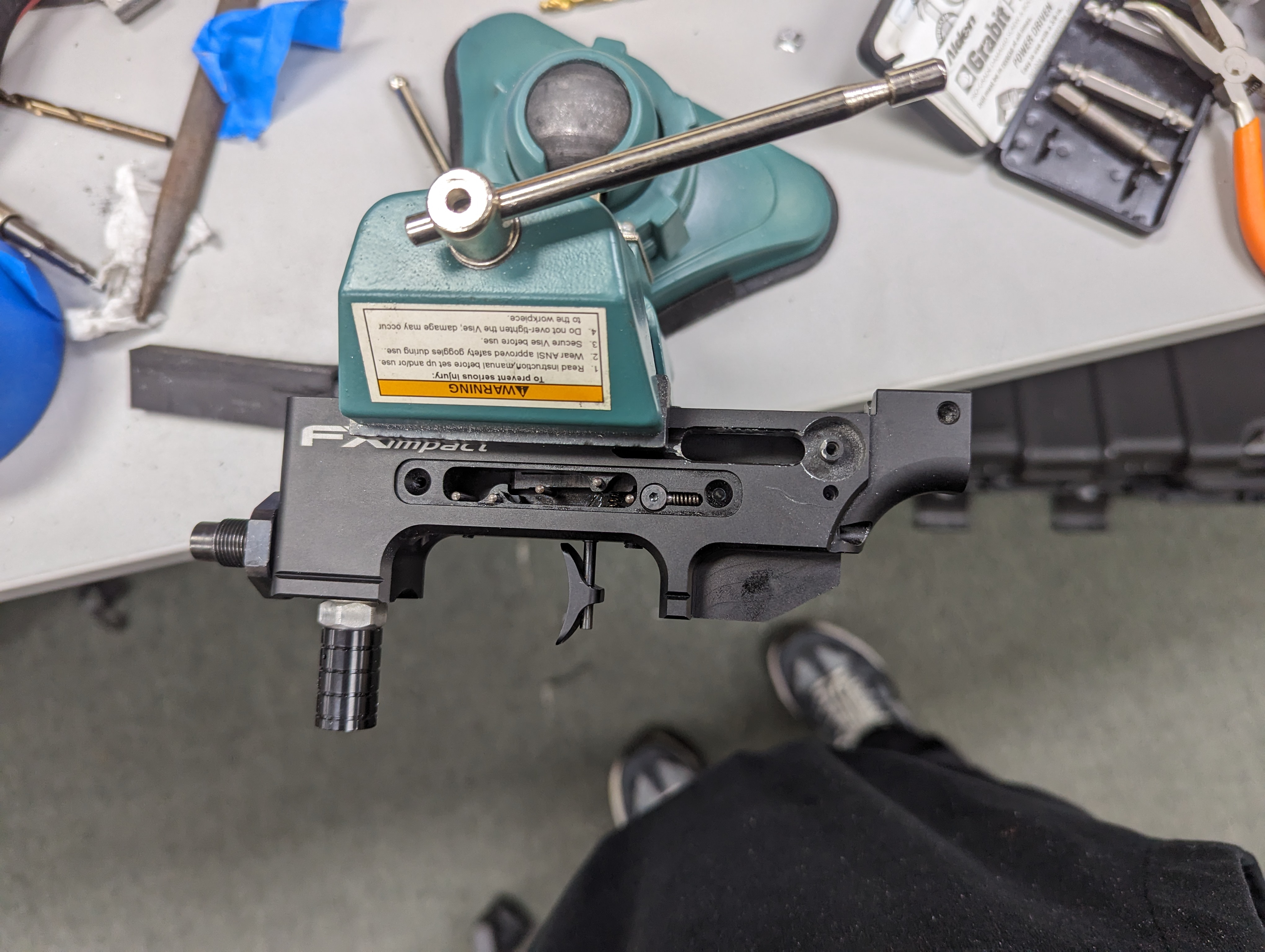

Yeah I had to Dremel it out but the screw head on Hammer adjuster block broke off!
Finally! Got it out holy Sh*t that was a pain in the ass and I nicked my action.
It is currently in an ultra-sonic clean to get the metal shelving cleaned off of it.
Now I need to contact Utah Airgun for replacement parts.
Black Sharpie and it'll help hide that little mark on the action.
