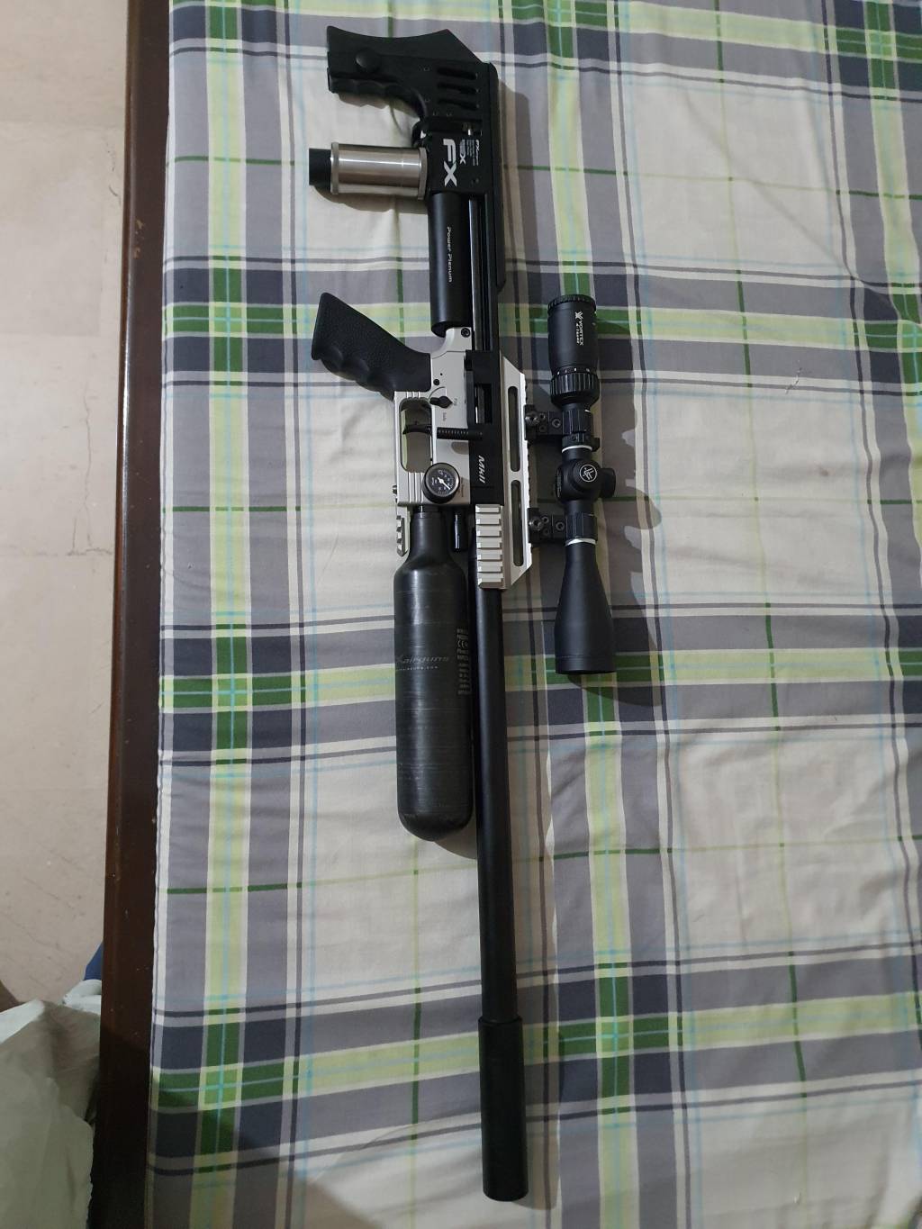

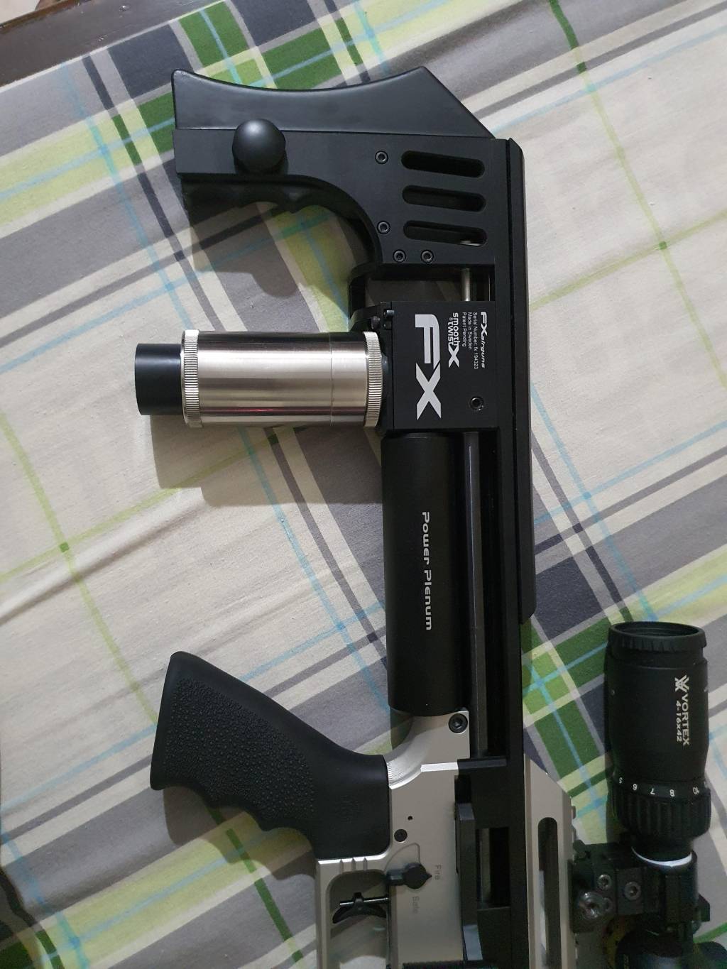

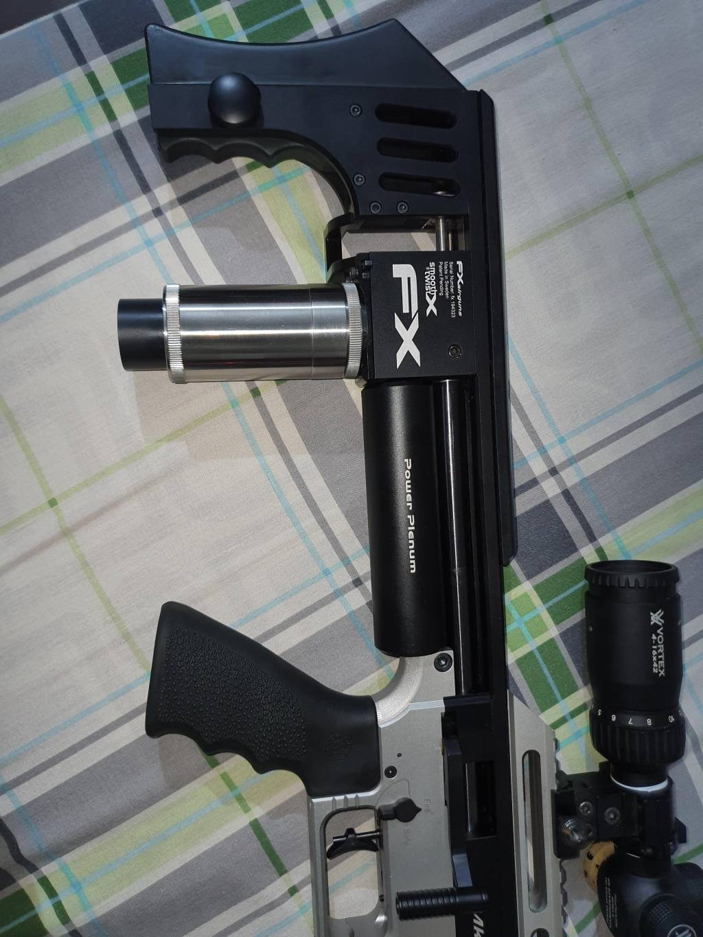

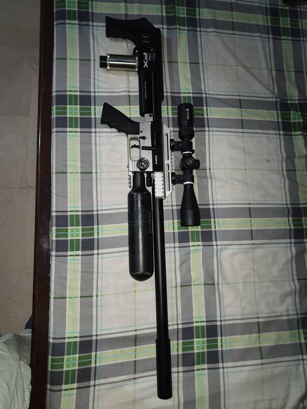

Fx impact mk2 with power plenum and external plenum of 50cc gives more efficiency.
At 890 fps with 18 grain .22 jsb I get 200 shots.
This may be used for more power.
Umair Bhaur
From everything I have gathered, the additional plenum is of little to no benefit to the power plenum. Now that all comes from here say as I haven't seen anything proven directly. I don't think you can have to much plenum space to hurt anything in this particular gun, but the diminishing returns kick in at some point. Just based on some speeds I have run, I really don't need more on the power side with just having the PP and the slug kit. I am not saying I wouldn't want more, but can break the sound barrier already as is.
At what pressure is reg set?
Reg pressure is 95 bars and barrel is 700mm
95 bars??? Go lower!!! How low can you go? 😆
my impact with PP came from factory with 90 bars and shooting JSB 26 grain at 920FPS so with 18 grain you can easily drop to minimum 80 bars and have 250 shots!!! Kinda expensive to test that theory though. 😂
