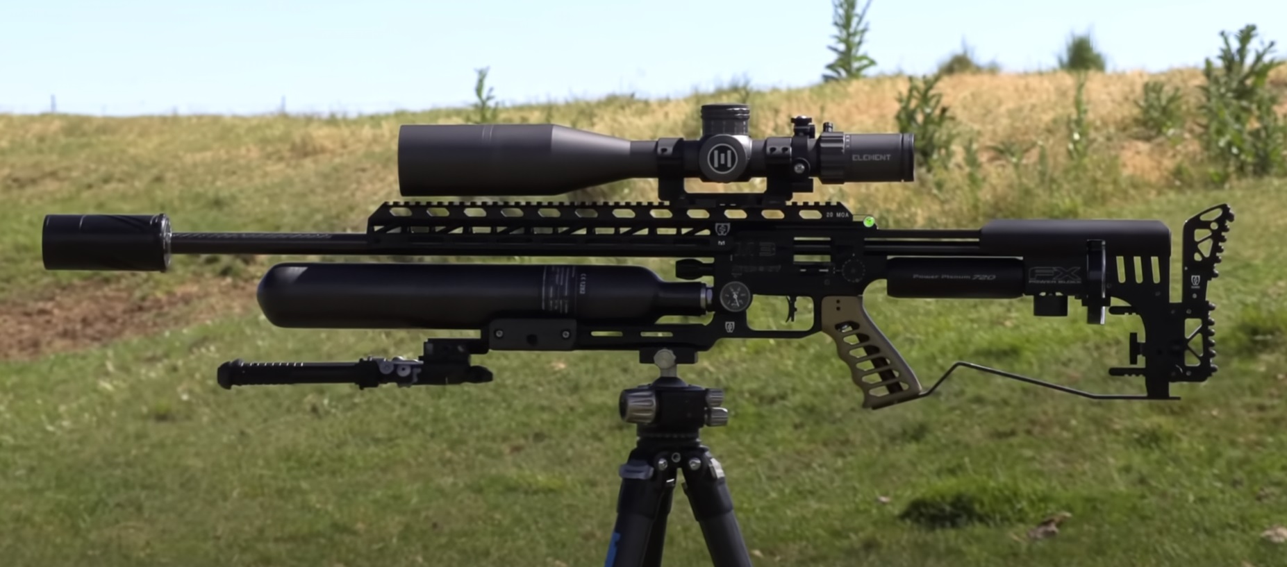

I watched a video of one the king pins in FX shooting and I am sure he mentioned he was running his 30cal at 1100 fps, so I watched the video a few times.
Thats when I noticed something so I screen shot it so you can see also
No its not broken, a king pin wouldn't hunt with a broken gun
Reactions: Maizen
I looked at your picture. It’s pretty blurry. I don’t know what kind of gauge that is but it might be pegged. Which would suggest his second reg is set at some crazy high number. If this is the case, ironically he feels he doesn’t need a giant backbone to help a large caliber/projectile gun with substantial harmonics. Just remember, a guy or king pin for a company has full access to parts. He can destroy his gun running it hot and just rebuild it like it’s no big deal. Longevity means nothing when you have full access and like putting out hype videos. Guys putting out videos with their maxed out airguns that appeal to powder burner guys sell lots of parts. The dumb YouTube viewer doesn’t know that he wrecks a valve every 1,000 shots.
