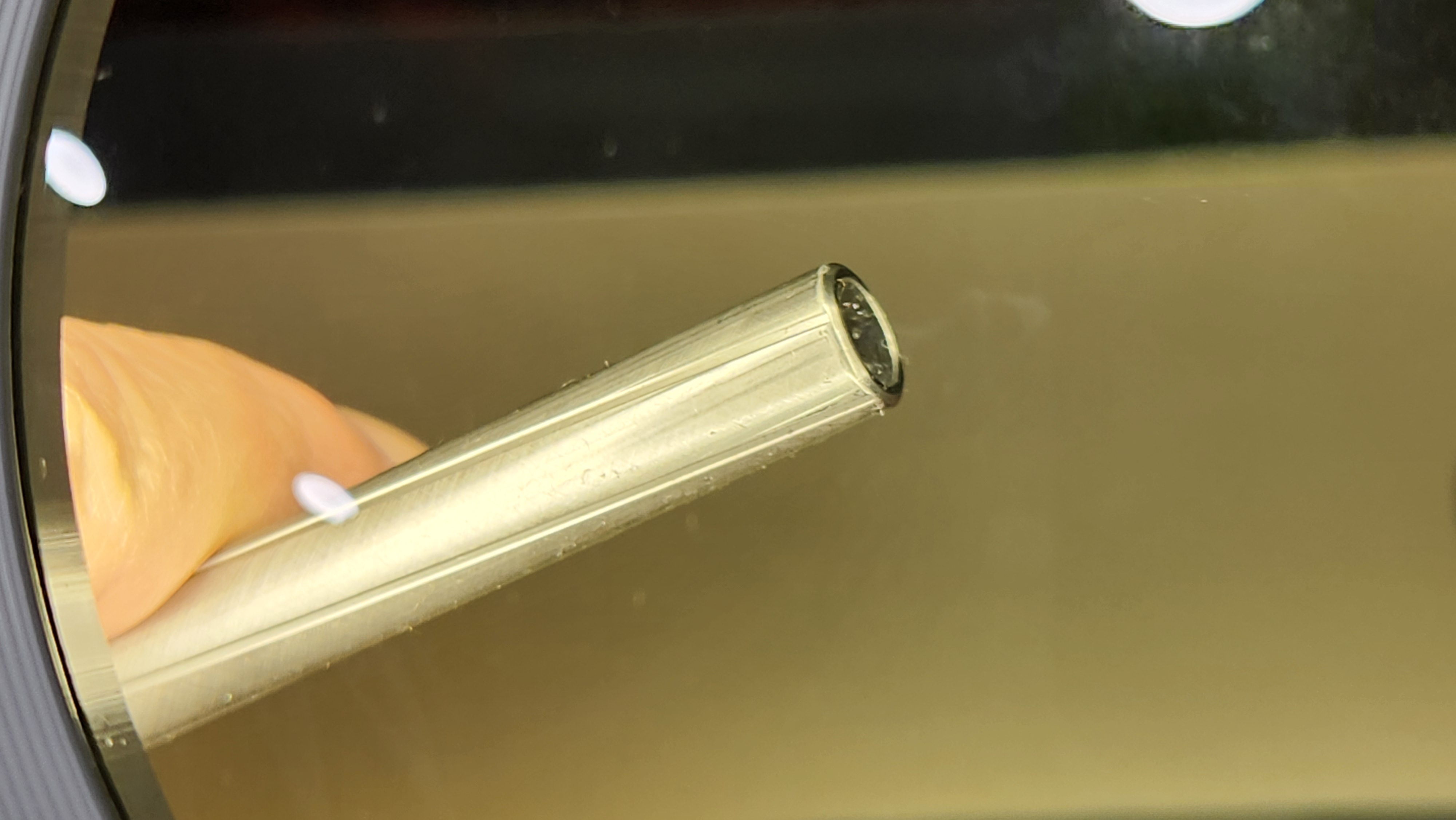

The liner Lock has some tolerance (relatively loose in my eyes), can you wobble it on the liner? When you start tightening the Liner Nut, it will squeze to one side out of co-linear centerline, just couple microns and that is enough to project an offset of 20-30 mm out at 100 meters.
- I tried to wrap a plumbers teflon tape on tip of the liner (muzzle end), so that tightened up the co-linear a little bit.
.......... this picture show when I was testing CF sleeve on the liner, but you got the idea. Btw, I don't use CF sleeve anymore, I am back to orings.

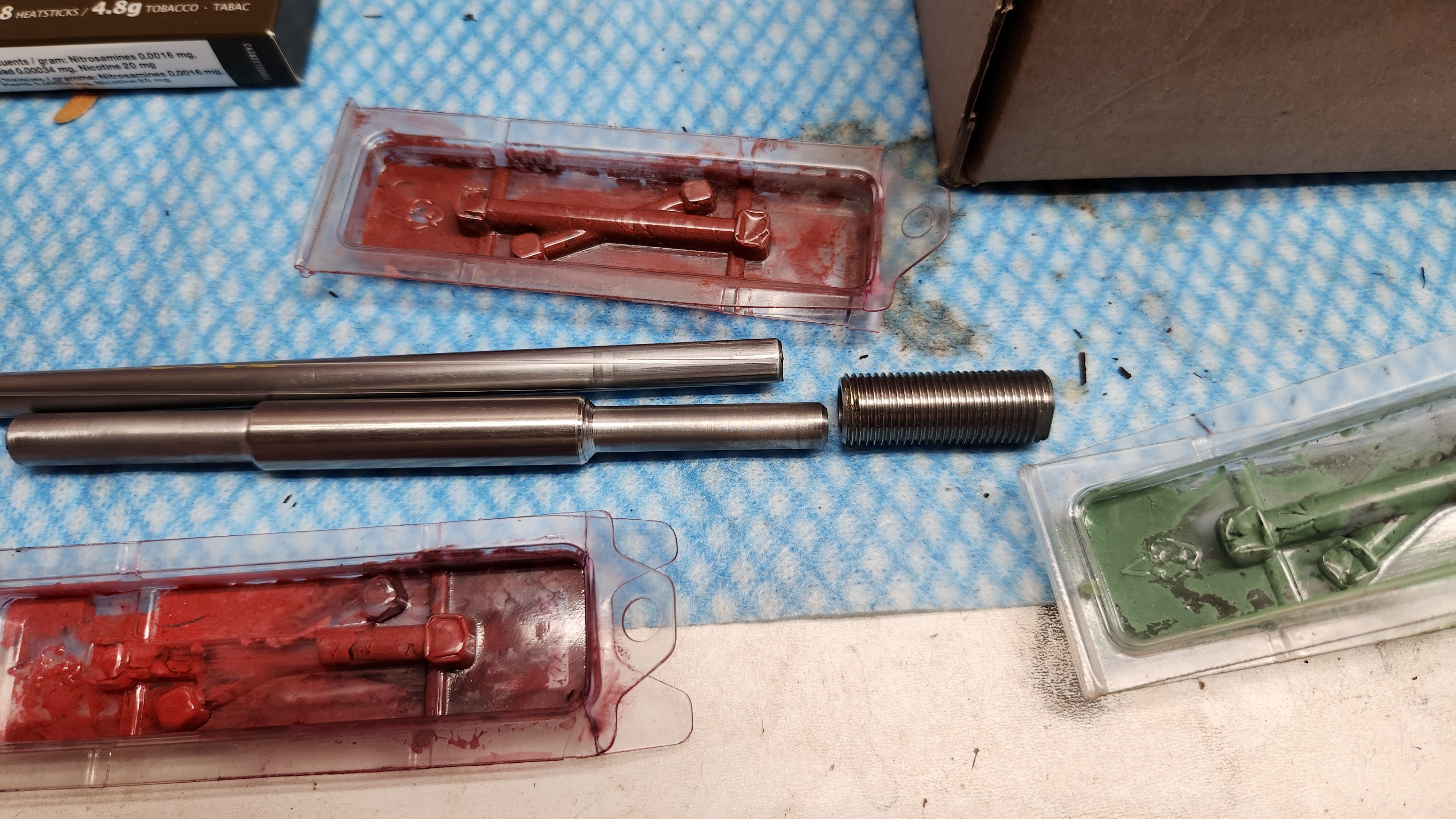

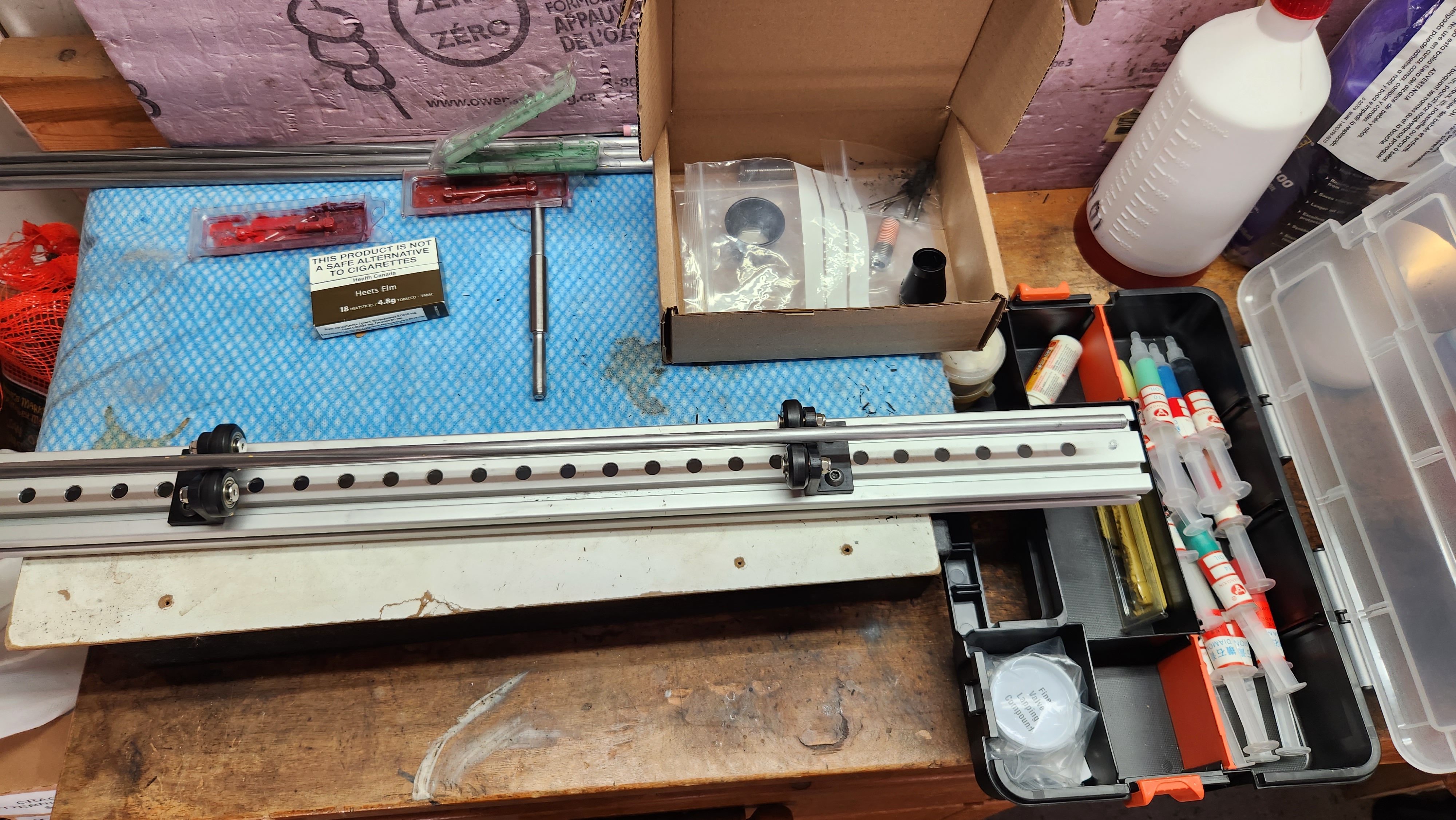

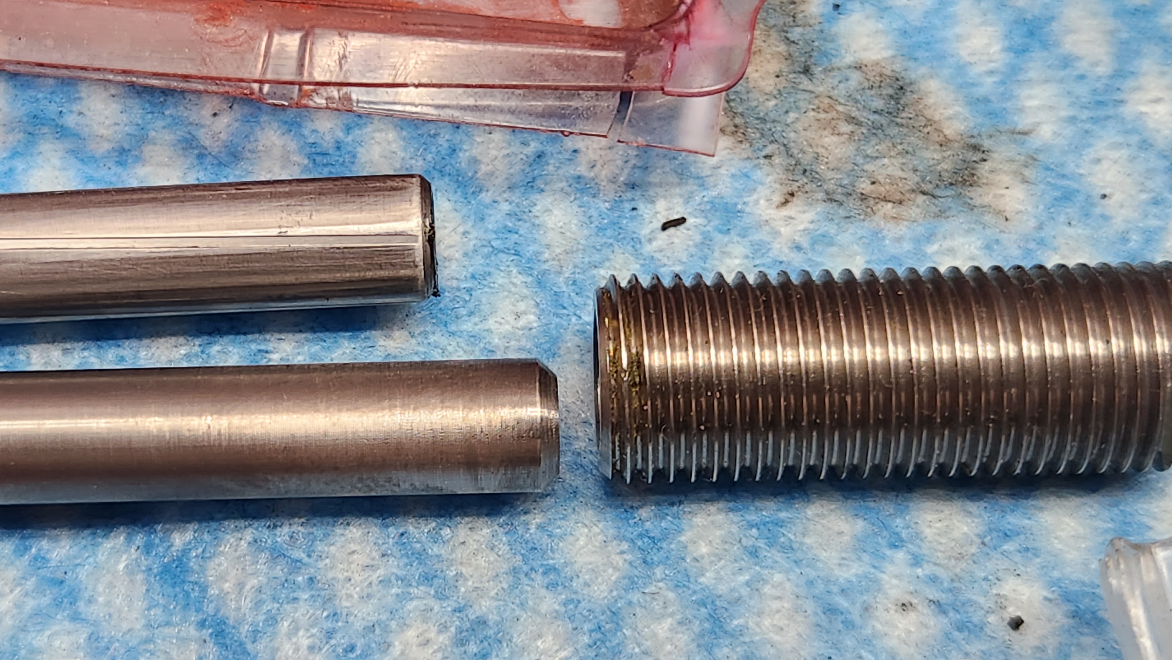

- I cut a little chamfer on tip of the liner, also made a lapping tool with same angle. Lapped (rough) first that angle into the Liner Lock, and second step lapped the liner into the LL again.
You can do by hand, but much better doing this on lathe, clamp the liner in a chuck and clamp the LL in another chuck, dump an amount of diamond lapping compound inside hole and push them together with a slow RPM. It will form a contacting shape on both pieces.
I didn't have a lathe, but I did mine on an arrow cutting jig, rotating the liner on bearings pushing with a palm.
This way, I remove the liner for cleaning and installing it back on a gun, index it, and for sure the liner will sit constantly in a same spot, no POI wondering around every time.

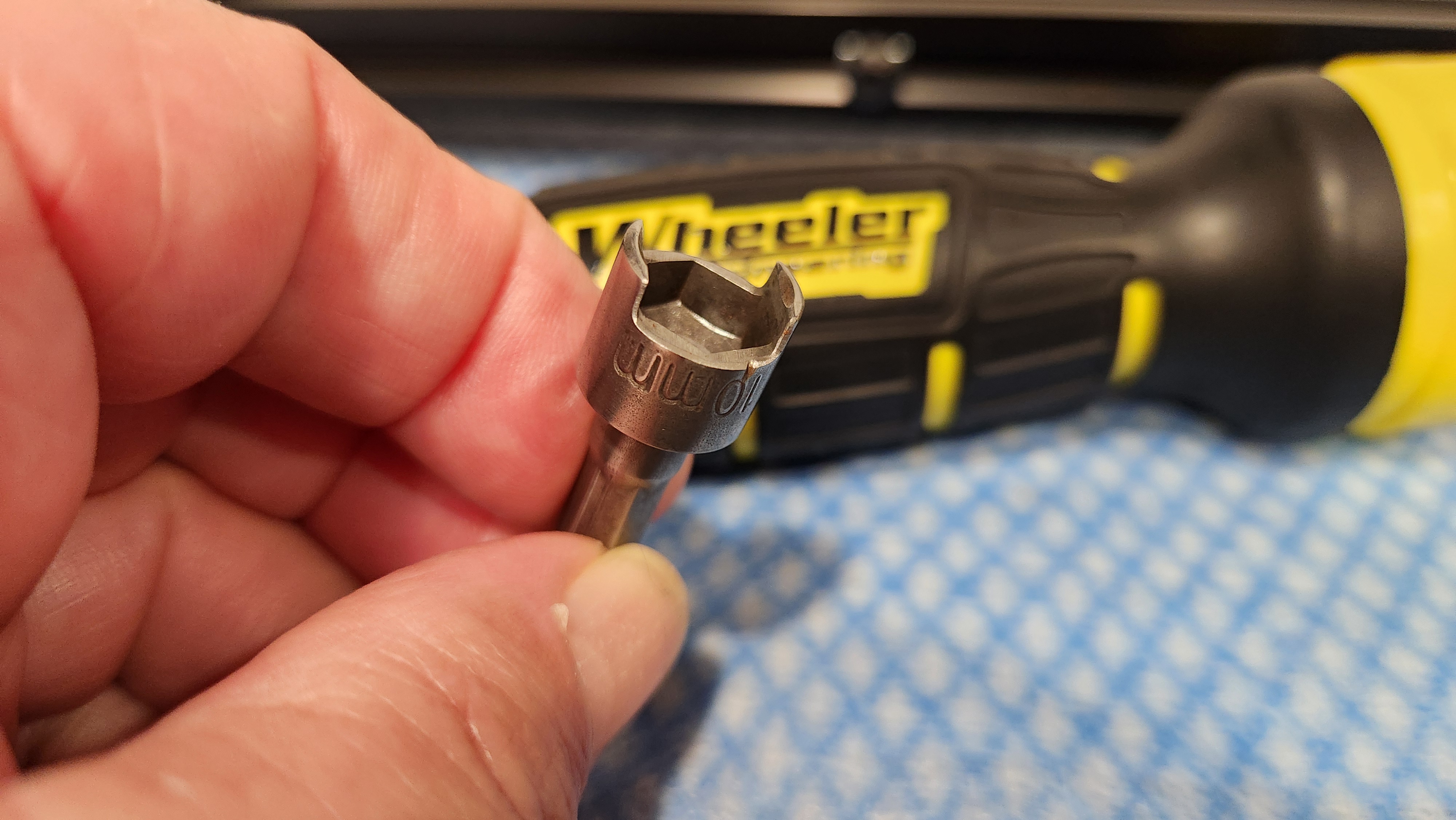

Also, I would assume, many people torquing the Liner Lock in a wrong way. Figure a way you will be indexing the nut in a same. If you inconsistent with a torque that will "bow" the liner every time different.
I made diy a wrench with opening for the LL, and torquing the nut consistent.
No POI shift this way ;)

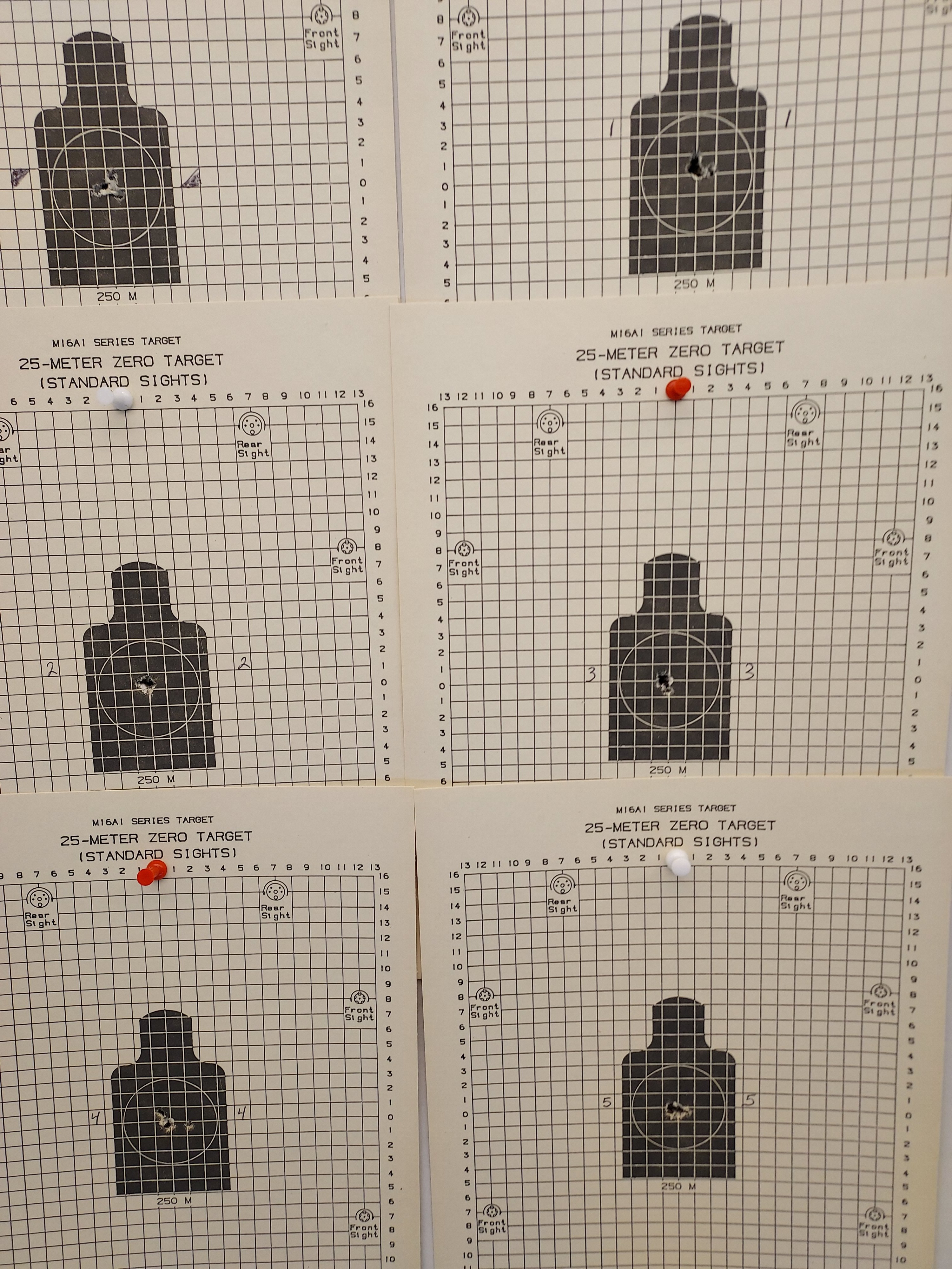

My .177 M3 is completely stock internally wth a stock barrel and shroud. I shot these M16A1's today inside at 20 yards from the muzzle, off an Atlas bipod and shoulder (no rear rest.
The upper left target is the sighter. 5 sighters were shot from a freshly cleaned barrel to both foul the barrel (my pellets are dusted with boron), and stabilize the regulators.
Course of fire is 5 shots per target from hands off the gun with 1 to 5 minutes between shots and 30 seconds from the buzzer to make the shot. I start the clock with the sighters. The worst shots recorded were ME and NOT the rifle because follow through had my cross hairs on the POI.
So my M3 is extremely consistent. I sighted in the Match Pro to 20 yards and zeroed the turrets in November of this year and have not thrown any clicks since.
The gun is tuned to 11.9 to 12.2 FPE using 9.57 gr, 4.51 mm Baracuda FT pellets.
The rear pwr adjustment wheel is set to 1, the front pwr adjustment thumb wheel is set to 2 5. The front valve adjuster is set at 3/4 turn CCW from the 2nd ring. The bottle is charged to 200 bar. The first regulator discharge is set to 125 bar and the 2 regulator discharge is set to 75 bar.
These settings have remained the same for 3 years
