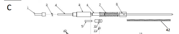

Ok, so there are only two springs that I know about in the system based on the breakout above. We might be using terms that are not meshing with each other, so I'll refer to them as the part number. I have the newest MKII Power Plenum. When I initially broke the rifle down, I noticed that it didn't even come with a rubber ball as the previous-gen did. I called service, and they said it is no longer included with rifles built with the power plenum (pictured above). So, when my slug kit came in, which I don't believe was old stock as I had to wait on pre-order to get one a few weeks ago, it only came with one spring and the rubber ball, which replaces C42 on the top drawing. My kit didn't have a replacement for the spring C7. I did put the spacers on C6 and adjusted the C1 back to its proper place. There were no other modifications I made to this area. When you say old valve spring inside the Power Plenum from dropping into the air inlet of the PP, what do you mean by dropping into the air inlet? I've seen a spring there on the older non-power plenum and MKII models like the one below but mine doesn't have a spring inside the power plenum like the old C42 in the below picture:

Right, so no need to concern yourself with the older parts, like the old valve spring in the plenum C42. It sounds like you have all of the latest upgrade offerings from FX for your MKII. It's hard to keep up as some MKIIs didn't come with power plenums, like mine. The rubber ball gets placed inside the valve spring that is placed over C1 as a safety check valve, just incase something went awry with the valve seating to prevent a full dump of the tank. C3 is now incorporated into the tip of C5 for better durability. As a side note, Earnest Rowe has just come out this week with a C1 removal tool that will make removing/installing the C1 much easier.
Ok sounds good. I'll try replacing C42 and testing again to see if I'm still getting a wide ES, but I honestly can't imagine having the stiffer stock spring in there would cause the issue. I would think that putting in the lower power C42 spring will just mean that I will be screwing the valve down to just outside line 1 instead of line 2 but that's theory and it's worth a shot, literally. I'll also recheck the C1, I do recall that after putting on the spacers, I had to screw the C1 a bit further on so I might be outside to range still by a little bit. It was 6 to 6.5 mm right?

My C1 measures 5.78 mm, I'll throw on the slug spring and see how that performs.
