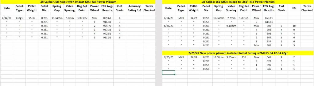

Did my first tune today with the Impact in an effort to get it quietened down as I can't use a moderator. After reading and picking people's brains on here I set the Power Wheel on max and tightened the screw down until I couldn't turn the wheel (14.50mm) and then backed it out to 15.0mm. I then set my reg at about 151bar and turned the valve adjuster to the second line (7.4mm). On MIN I'm getting 786fps with the 25gr .25cal JSB King 25 pellets.
Power Wheel 1 is 821fps
Power Wheel 2 is 856fps
Power Wheel 3 is 911fps
I didn't try any of the higher settings except for MAX and it was around 1060fps.
It's a very efficient tune as I'm using around 1 bar per shot (less on MIN).
I'll have to play around with the valve adjuster a bit to see if I can knock down the spread a bit.
All in all, I'm happy with this tune and it's pretty quiet on MIN compared to what it was before.
