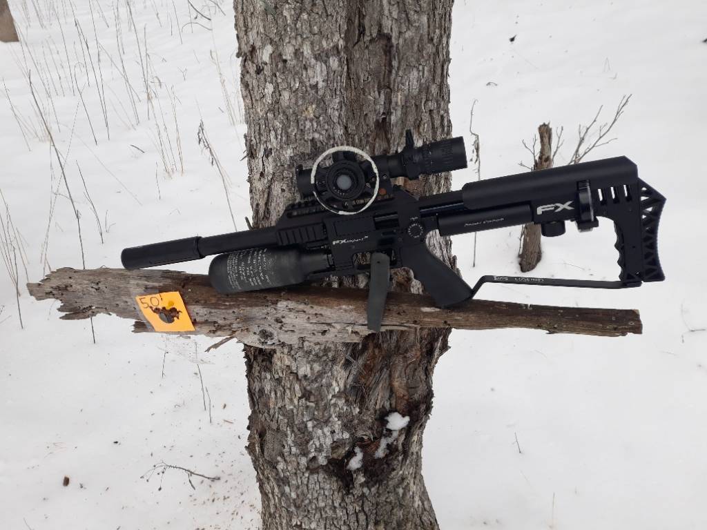

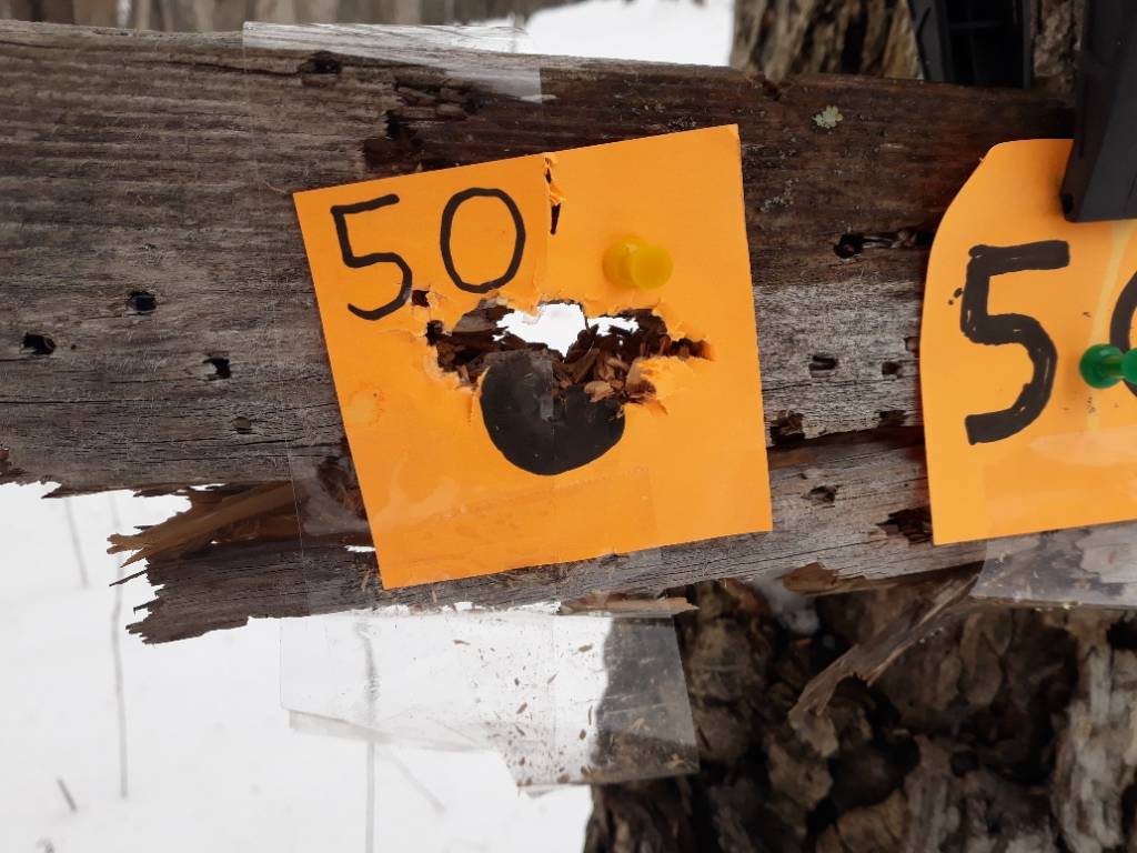

I shot it this morning and it was shooting 880. Was windy so hard to tell accuracy. I jacked up the reg pressure to looks like 125 on the gauge. Adjusted the hammer spring fine adjuster maybe a full turn. Now shooting 25 kings at High 930 , low 924 & average of 927 45 shots. The last two was at 924 & 921. So looks like 45 regulated shots on a 250 bar fill. I would of been happy with 40. Here is 50 shots I just shot in 10 mph crosswind, as fast as I could load & pull the trigger at 50 yards scope set on 7 power. Was about 30 out, I am sure on a still day when I get warm should be easy to keep them in a Nickle or less. I am happy with it so far, does have a hard trigger pull compared to most of other air rifle i have owned. Thanks for all the input.
