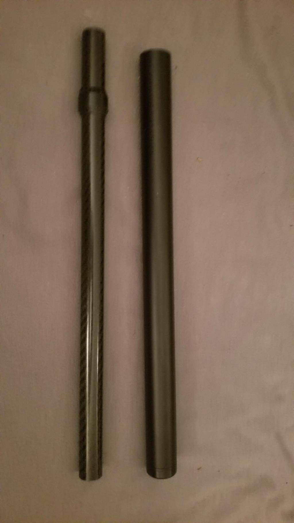

I would bond the liner and the cf sleeve together, you can remove the conical end on the shroud and get some 20x14 cf that slides under and inside the shroud. Some electrical tape wraps (or something) where the cone goes on the breech end of the shroud works well. (To keep the shroud centered on the muzzle end.) The shroud when its snugged up will really solidify things.
Make sure the liner lock is always a bit tighter than the shroud onto it or when you remove the shroud you'll pull the liner lock out.
