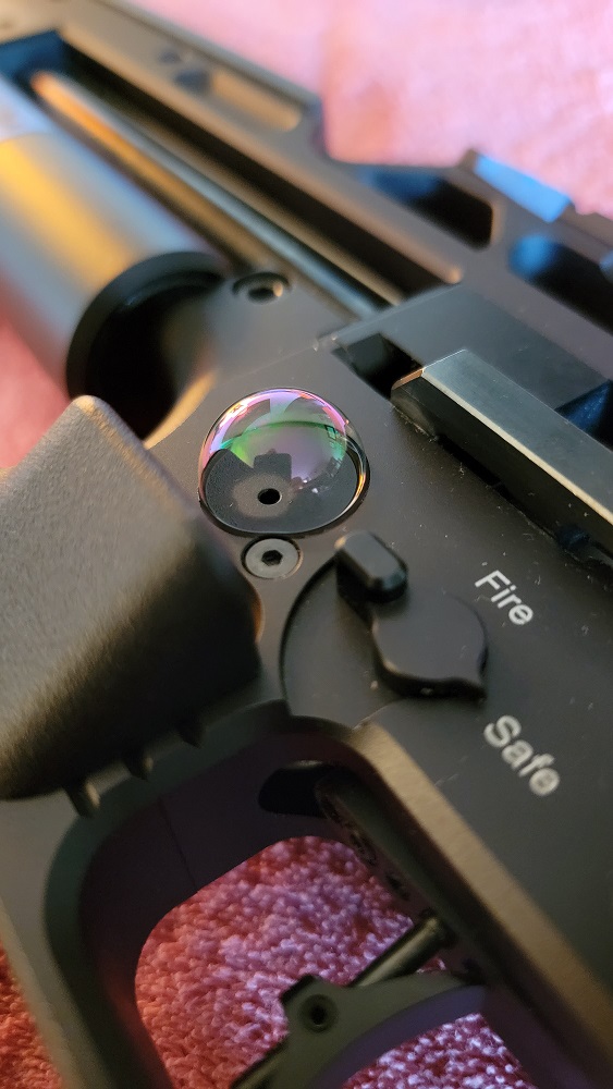

Found my leak!
Look at your atmospheric blead hole on the right side of your Impact.
Small leak over a few weeks is a thing to troubleshoot. A bit of soap an water is cheap and affective.
C39 19790 O-ring 10x1,5 NBR90
A bit of a challenge, but most can do it with patience.
