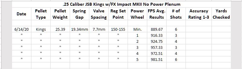

Yeah for example the power wheel gives lets say 70% of available throw just by turning the wheel.
Do you want the bottom (min) 70% of adjustment? Middle 70% or top 70%. Cant have super high power and super low power with only adjusting the power wheel. Using the old rubber ball valve adjuster you can by introducing that adjustment.
With how mine is setup im using the bottom 70% so the slider at minimum preload can be easily adjusted up if i want to shoot really heavy stuff. Its crazy efficient as its setup now.
