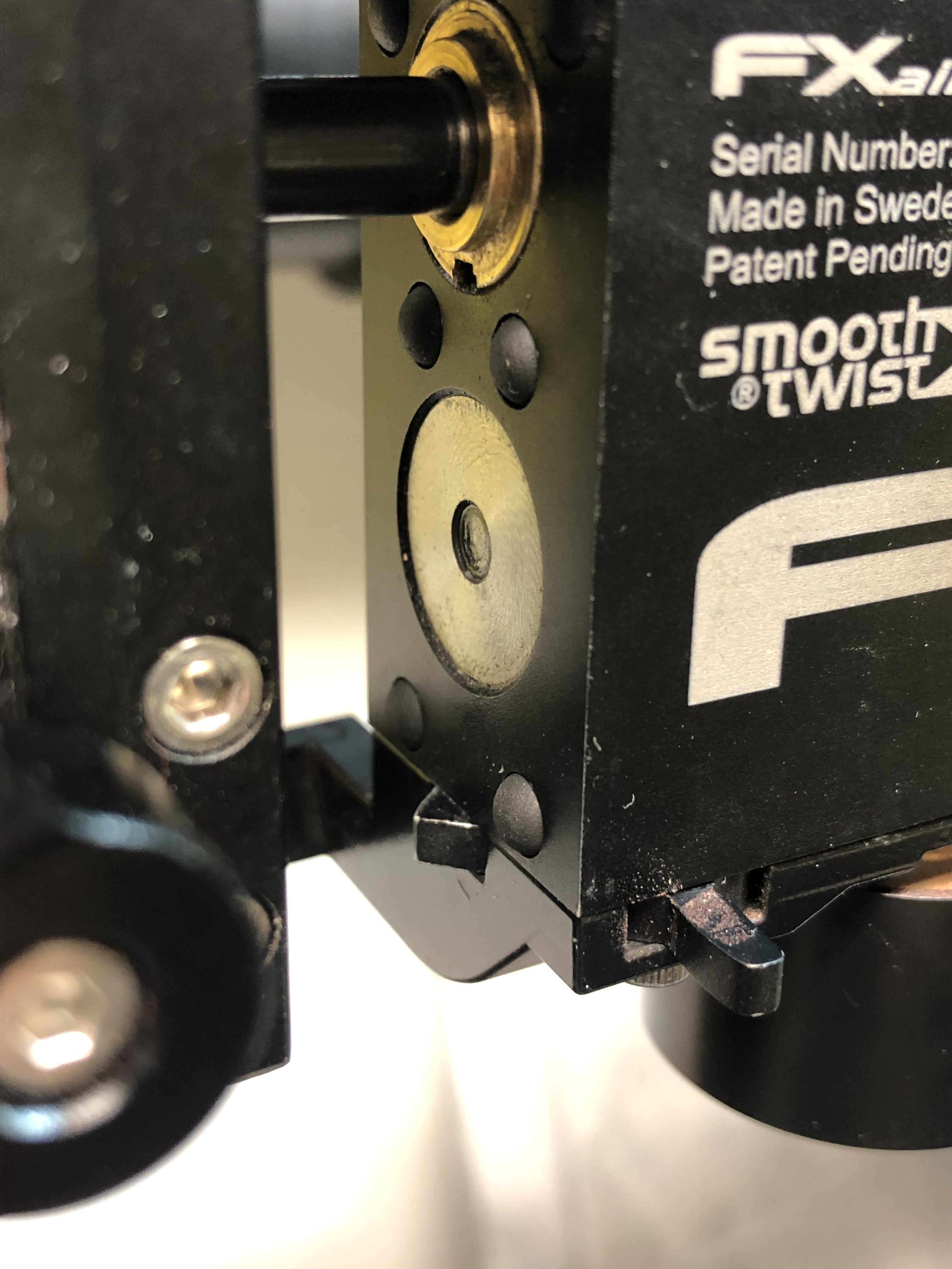

If it's the magazine rattling you can get extra rubber balls that are in the holes of the back of the block
I’ve always until recently had only two rubber balls in my mag slot, at the very top. I always wondered why no balls at midpoint and at the bottom, then I saw some old video from Giles in the UK as he did an install of the new high capacity side shot mag. He said all the factory balls are not needed as he pulled them out, so I figured “that’s how it should be”, and since I bought my mk2’s used, I let them be with just the two most upper balls installed.
Then I recently saw a close up of an M3 with all the balls installed, 4.75mm, so I popped four in to fill all ports for the balls.
So the mag slot at transfer port side take four below the breech opening, then two above the breech for a total of six-
My mags are so nice and snug now. Once they’re snapped in if I grab the bottom of the mag to wiggle it front to back, well there is no wiggle.
If any of you find your mags too loosey goosey while snapped in, or find every once in awhile you’ve got to wiggle your mag while trying to insert the next round, try putting the rubber balls all back in.
