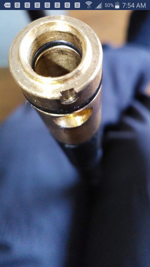

I'm looking for this O Ring inside the 30 barrel.
Is it the same size for all barrels? I need to order a few in case I blow another one.
I dint know how long its been missing in my 30. Still shoots fine but its puffing air and sounds different.

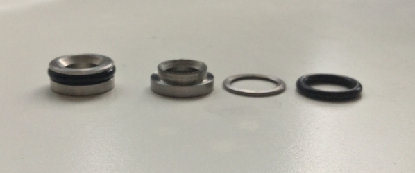

"GQ"The metal seat is also the same. Right ?
I can't verify that. When I got the part from AOA (about $30 kit with valve) it did not have a part# on it. Also the Royale must use two different seats, because it calls for a o'ring that was not correct by a long shot. I have not torn down my Impact seat yet to compare parts. I will update for sure when I do. I don't see on the parts list the seat and o'ring. Am I wrong?
