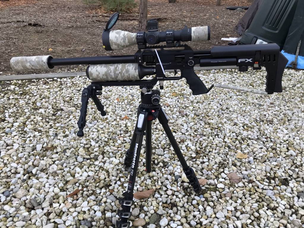

I use the FX no limit rings and they are fairly high. I put lower ones on it once and it made me have to tilt my head to far to see through the scope. Everybody has a different physical shape though so hard to say if medium or high would werq best for you.

I have the older gen2 K&L Easy access trigger guard with an arca rail adapter. There are newer and longer models available. The arca rail adapter is a t-rail accessory so it can be attached to many of the extended trigger guards to help balance the weight of the gun better , closer to the center of gravity, when it's on a tripod.

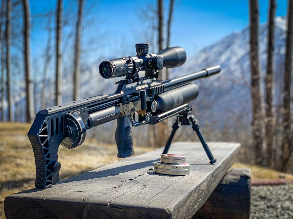

Low, medium or high, will have nothing to do with the accuracy of your gun itself. The height of the rings is a matter of personal comfort for the shooter & how that shooter "melds" with their gun. Try some cheapies in all 3 heights & see which gives you the most natural, comfortable & stress free hold on the gun allowing the guns accuracy to come through. I think I have some medium & high picatinny rings (my guns use dovetail) that I'd be happy to let you try if you pay postage. PM me if interested. It also matters what position you'll be doing most of your shooting. Kind of like asking "what size shoes should I wear"?

Most will shoot a more comfortable gun more accurately. Cranking yer neck and holding your head sideways does not usually make one a more accurate shooter. I can often as not shoot .5 inch to 1.0 inch groups at 100 yards with my .25 Impact. With the higher more comfortable to shoot mounts on my gun. Once I know the trajectory of the projectile, I am shooting, I can shoot from 10 out to 200+ yards and hit my target most of the time. How high or low my scope mounts are has little to do with this so long as they are not so high or so low that I am not comfortable with my hold on the gun.

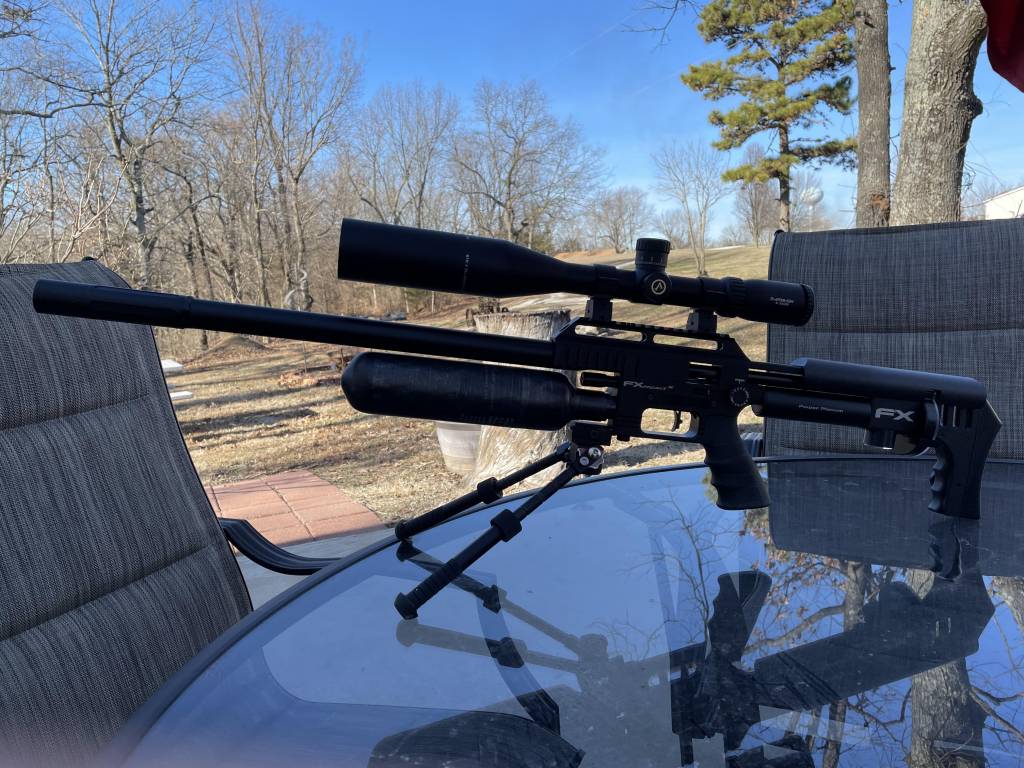

I had a set of TPS TSR low rings (.925) laying around. I gave those a shot before trying anything else. They are the perfect height for me. I was hoping to forgo a cheek riser as I wanted to keep my scope as low as possible. The magnifier ring just barely clears the rear of the picatinny rail. I think most people would want slightly higher rings than what I've chosen.
