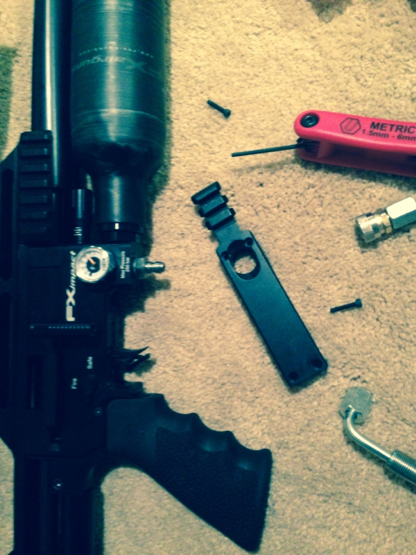

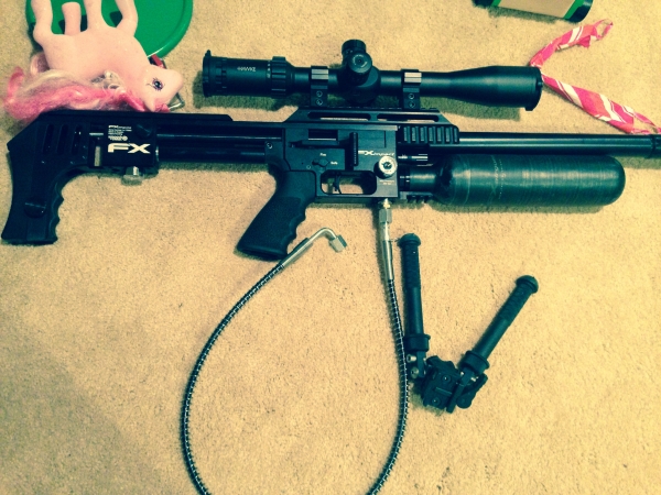

How about going a different route? I had the same problem, having to remove the trigger guard per the pic below. I just ordered this, and will post an update when it arrives in two days. Should make things much easier. I was talking to the guy who makes and sells these earlier today. I told him that perhaps the Swedish engineers all have small, thin fingers with manicured finger nails. I am the opposite so I am replacing the whole trigger guard with something better. The hose you see attached to the rifle is the compressor hose, I had to unscrew it from the compressor, then take off the trigger guard. Great video of the product as well as an installation demo. They have one with an extended pictiney rail as well.

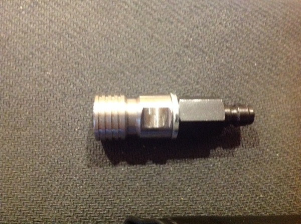

"Mick-VA"@shortslide - that was why I connected a female threaded male foster to the "special" female foster fitting shipped with the impact.
It ends up working just like a "probe" that I can connect to the impact and fill from multiple source without buying a bunch of the"special" ones to permanently install on various fill stations.
Great idea!
