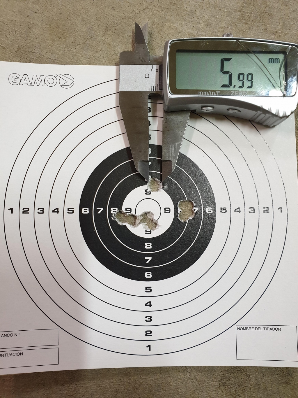

Super excited- finally got the slug liner 600mm 22 arrive. Only issue is it us a super tight fit... I mean really tight. Yes it us the correct way around and is th3 same length. I several takes to get it in and finally got the muzzle thread started and used that to get it fully seated. It is shooting well but I'm worried about getting it back out and if anyone else has had this happen?

Initial testing with it looks promising so might just leave it in haha.
