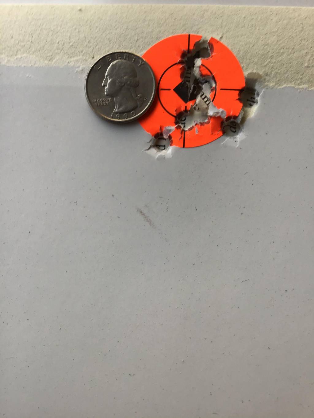

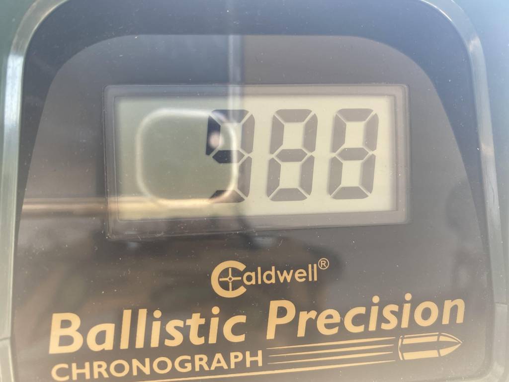

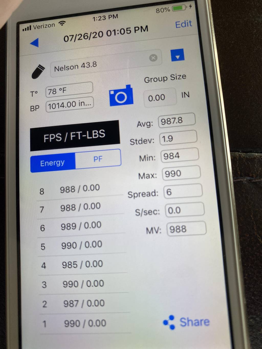

Just my experience in the need for speed and tight groups:
Ernest Rowe and Huma have the larger transfer port. I purchased the Huma and it did give give higher
FPS , but the speed is not the problem with tight groups. I started playing with the torque on the barrel
tube and found as I tighten more the group’s followed. Was very careful not to go crazy on tightening you
can flex the barrel tube if to tight. I am shooting 50.15gr at 960 FPS reg at 130 bar hammer on line 4.
you might try going back to 120 bar on reg and start over I had to do that found others here did same.
Hope this helps
