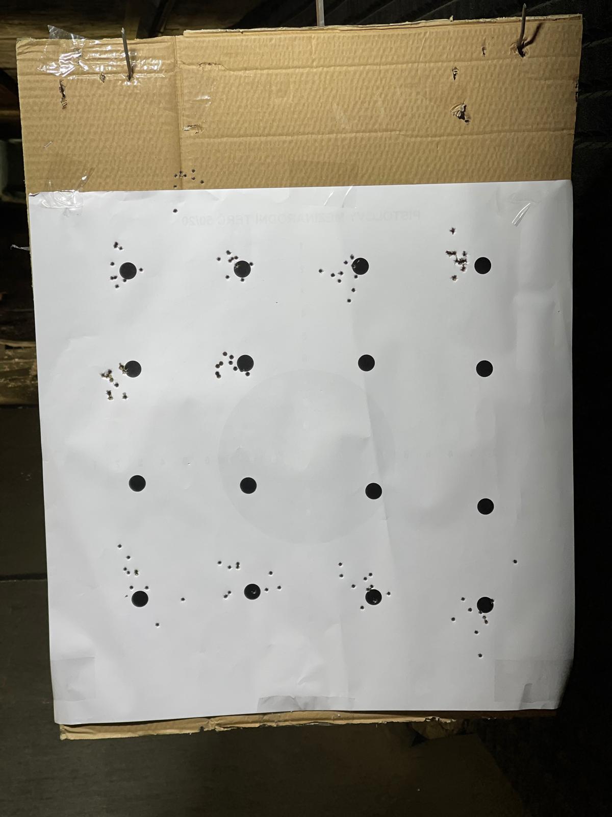

Here are some groups that I shot recently, also with the JSBs. The top two lines at 50 meters and the bottom line at 100 meters. The size of the black dot is 2cm approximately.
If it were me I’d learn the gun with some king heavy 33.95 grain pellets. Much more forgiving and you can learn adjusting the gun without chasing accuracy. What little I have dabbled in slugs I have found they aren’t as easy to get right as YouTubers would make it seem. Have to have the right diameter for your liner. Right twist rate and it’s more than just the right speed. The right tune to produce that speed as slugs are much more sensitive to excess air coming out behind them when they leave the barrel. If you run some 33.95 at 920-930 the 50m groups will be a quarter of the size as those if you do your part.

Thats not as good as it can get at 100 M, even with me only having .177 / 4.5 mm experience.

I would listen to the pellet talk though, CUZ in .22 you should be able to shred 2" / 5 cm targets like i do.
