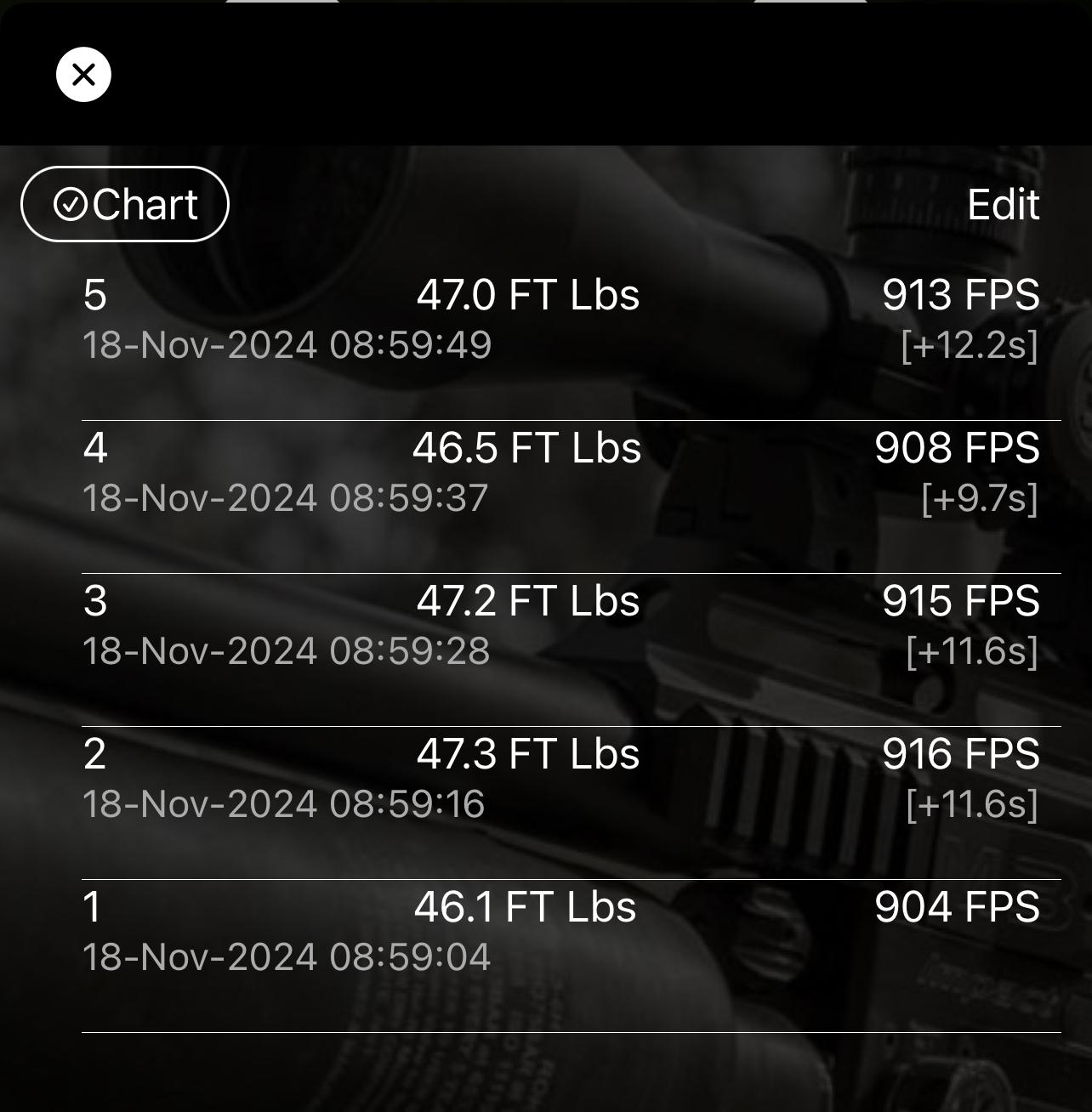

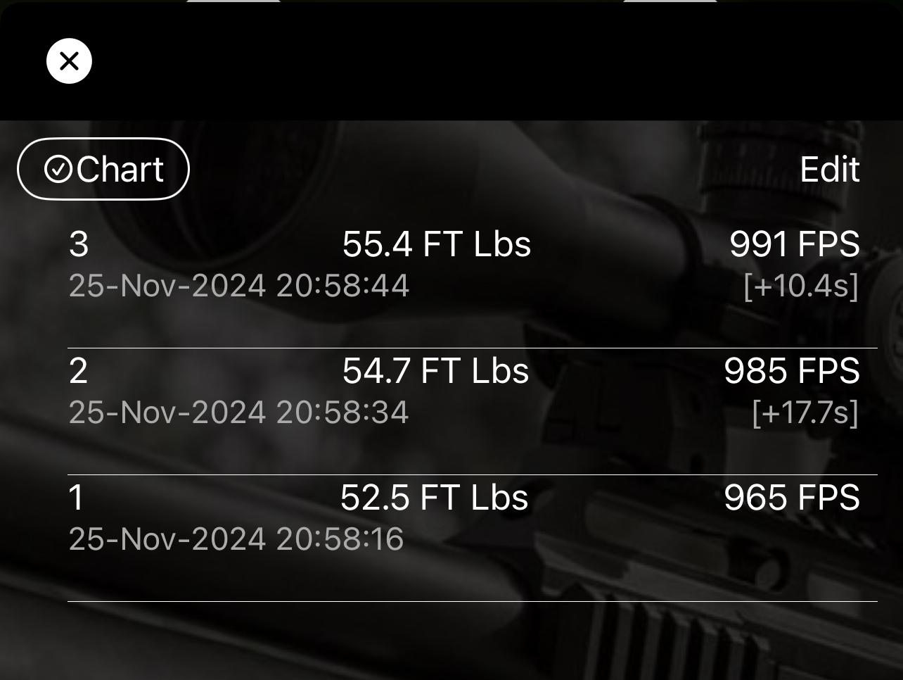

I don't know if it is possible that the new heavy liner that I installed is slowing down the slugs. So far I tested only .217s. I can get some .216 to check if there's any difference. I'm not lubing my slugs.

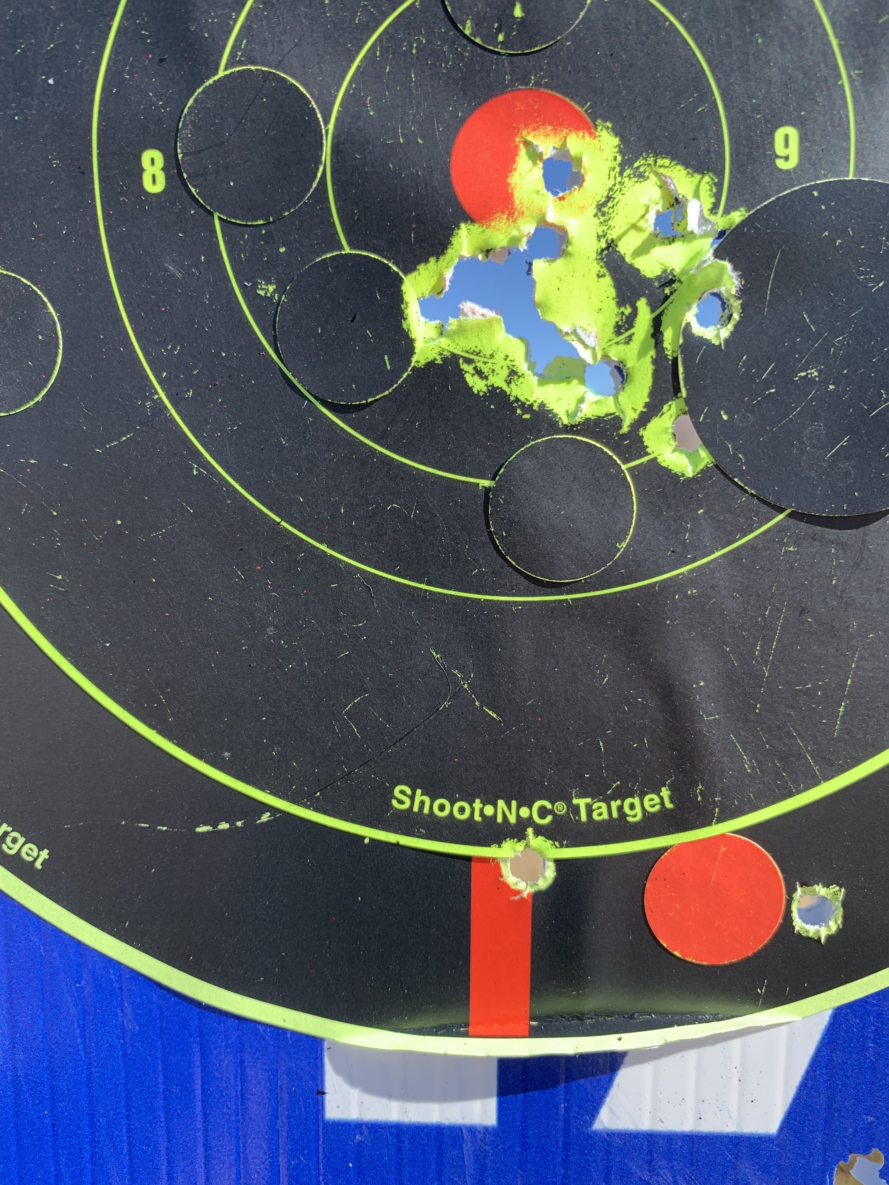

Thank you for sharing these numbers. This is similar to what I'm registering with the JSBs 25.39 gr, but I'm struggling with the group size at 100m (109yds). It is possible that the lenght of your barrel is helping you in this case to tighten your groups at 100yds. I would be interested to know the diameter of your groups at that distance.

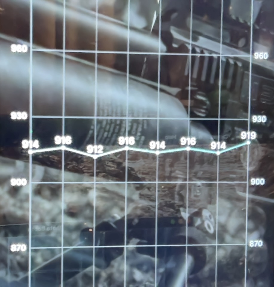

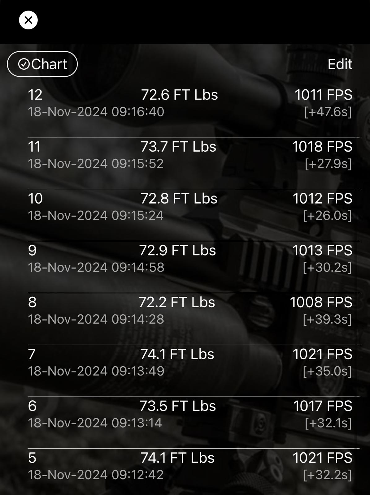

Adjusting the 2nd regulator to 130bar had actually the opposite effect on the JSB's velocity. I noticed a slight drop. Macro wheel on 16 and micro on 4.5. Is interesting that my FX Panthera 700mm 25 cal is pushing H&N slug HP 32gr at more than 1000FPS. The Panthera also has a superior heavy liner (stock). I have macro on 17 and micro on 2 on the Panthera. The Panthera can go all the way to 26 on the macro.
