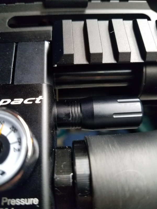

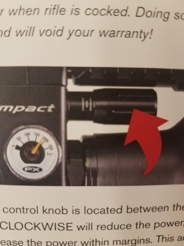

FX impact valve control knob question
What should this be set at in the picture it has two small lines and two big lines and it says this is the default from the factory. My gun has rings all the way around what should this be set at for a 30 caliber?
The valve works in conjunction with the regulator pressure & hammer spring.
If you're shooting .30 the reg pressure should be between 130-140, the power wheel (hammer) should be 5 or Max, the valve should be 3-4 hash marks.
If the valve is too far open you'll just waste air. Set the reg & power wheel, then back off the valve until you start to see a decrease in fps. That's the minimum setting for the valve based on the hammer & reg pressure.
so that means, you should max out the wheel and the reg and then start gradually reduce the valve??
I generally start tuning with the valve adjuster opened up to line 4 or just a tad more. I choose a reg pressure and tune to that reg pressure with the macro wheel a cpl notches below max. I tune the optimal spot for the chosen reg pressure a cpl clicks below max so I can up the hammer spring when the gun has sat for awhile to over come the first slower shot phenomenon. With the big dial set a couple clicks below max I back the micro adjuster off quite a bit. I then start shooting over the chrono and slowly working the micro adjuster up until no more velocity increase is seen. Then slowly work the valve adjuster in while still shooting over the chrono. Turn it in until the velocity drops a little bit, maybe 10-15 fps. At this spot you should get good consistency and efficiency. If it isn’t the velocity you wanted then you have to adjust the reg and micro accordingly to get there. Just remember to make small adjustments when doing all this so as to not over shoot the sweet spot. I have a mk2 700 mm and only shoot 44.75 pellets. My reg is 107-108 bar and that shoots them in the low 870’s to mid 880’s. I could work on it a bit more to tighten the ES up a bit but out to 75 yards I have shot it the accuracy is stellar.
