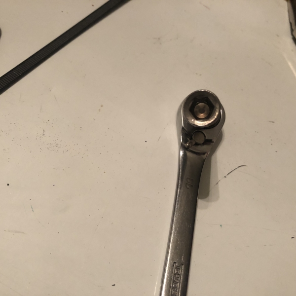

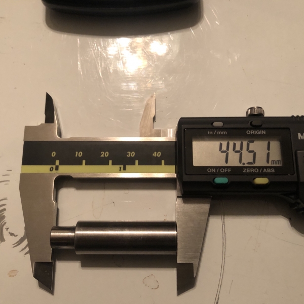

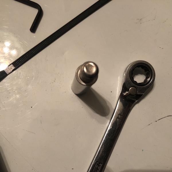

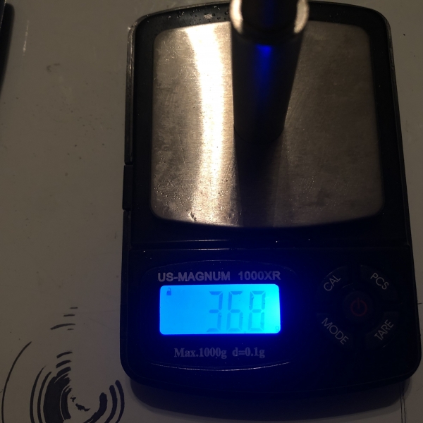

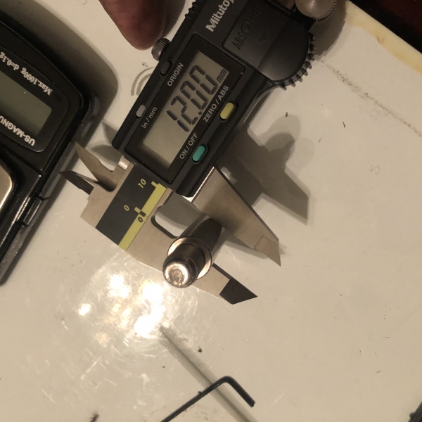

I finally got a look at the hammer in my X tonight. Almost immediately, I remembered a couple of spare parts that I still had laying around that I hadn't installed in my M3 before I sold it. The diameter is about .02" larger, and weighs 39grams in its current state (slightly longer than the Impact hammer)..
1550908033_14353805745c70fa812b5335.81039089_EFA610E1-58E4-4CBB-8B04-120C7B9F8911.jpeg
1550908034_11698764245c70fa8221a127.04663979_CF2BB2B3-2E07-4C87-B3DB-AB527D851500.jpeg
There might be something there!
