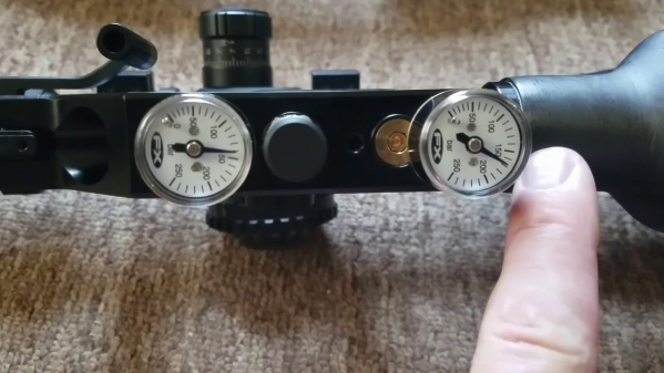

FX Impact with upgraded gauges " WIKA" photos

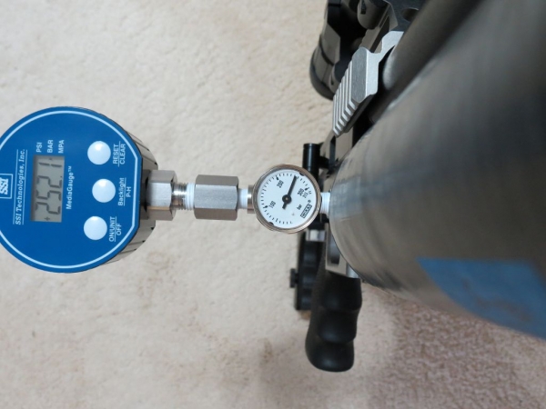

I got my digital gauge and fittings, and was able to put together a Tee to measure the pressure with the digital gauge, and one of the rifle gauges. Sadly, the USPS dropped the ball an didn't deliver my wika gauges today, so I'll have to test those tomorrow. I did test the original FX gauges though, and they're crap, as we already knew. Hopefully Wika will be much closer.
When filled so the bottle gauge read 250, the digital gauge read 211. Yep, that's a whopping 39 bar error, and probably a significant number of shots. I made a mark on the FX gauge for now where the real 250 bar pressure is according to the digital gauge. I also noticed that this gauge doesn't return anywhere close to zero when there's no pressure.
Next, I compared the regulator gauge. The reg was set by AOA to 141 with their super gauge when they had it for some touch up tuning. Without adjusting anything, the FX gauge read 145, and the digital gauge read 135. That makes the FX gauge 10 bar off at this pressure. The good news is that even if I respect the current 143 bar limit, I was able to adjust the reg 8 bar higher.

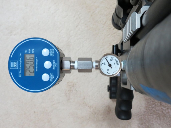

Great news. Wika RULES! I just tested both of the Wika gauges I received from Edguns, and they're spot on, absolutely as good as you could ever hope for on an analog gauge! The pictures show two different gauges. I lost some resolution in the upload, but the needle is just past the 250 bar line in both pictures. When I installed the gauges, the reg went right to about 143 where I set it yesterday. Gotta love things that work.
The gold is still ugly, but performance is more important :)

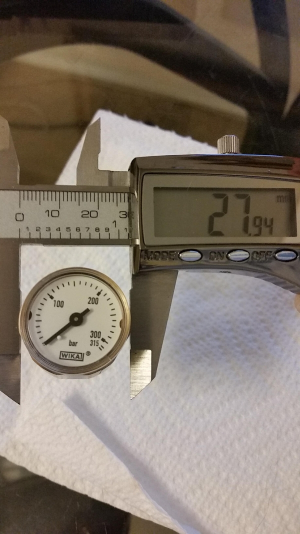

Wika doesn't make those gauges anymore. So if you want them, you have to pay to have them made. They cost just under $55 each. When I had mine made (delivered just this month after a ≈6 week lead time ), I had them do one at 0 to 6000 PSI (they don't make a 5000 PSI), and one at 2000 PSI.
By the way, these are class 4 gauges.
The part numbers are:
52815389 6000 PSI
52815388 2000 PSI
