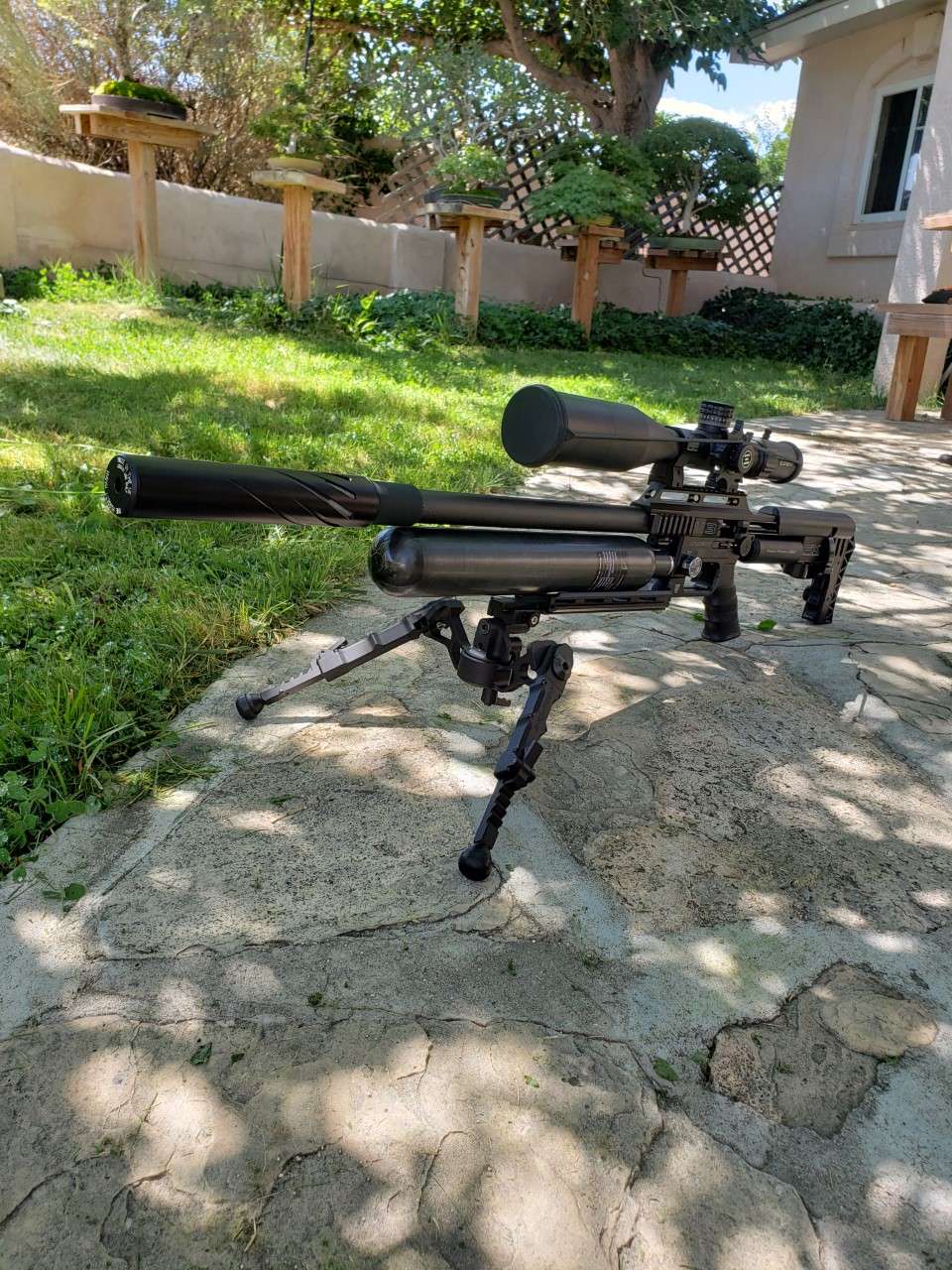

Just because you buy an Impact doesn't mean you have to tinker constantly. I tuned my 25 cal. M3 to shoot JSB 25.39 grain pellets at 920 FPS, and haven't touched it since. But if I want to shoot different pellets or slugs, I have the capability to tune it for the best accuracy.

I mainly do pesting at a dairy. Very seldom do I shoot beyond 75-80 yards, and the pellets have been very accurate at that range. At my present settings I get over 150 shots with the 580 cc bottle and 700 mm barrel. I'm hoping to get out again on Tuesday.
My last time out with the Impact:
Hi, thanks for the info and the great video.
