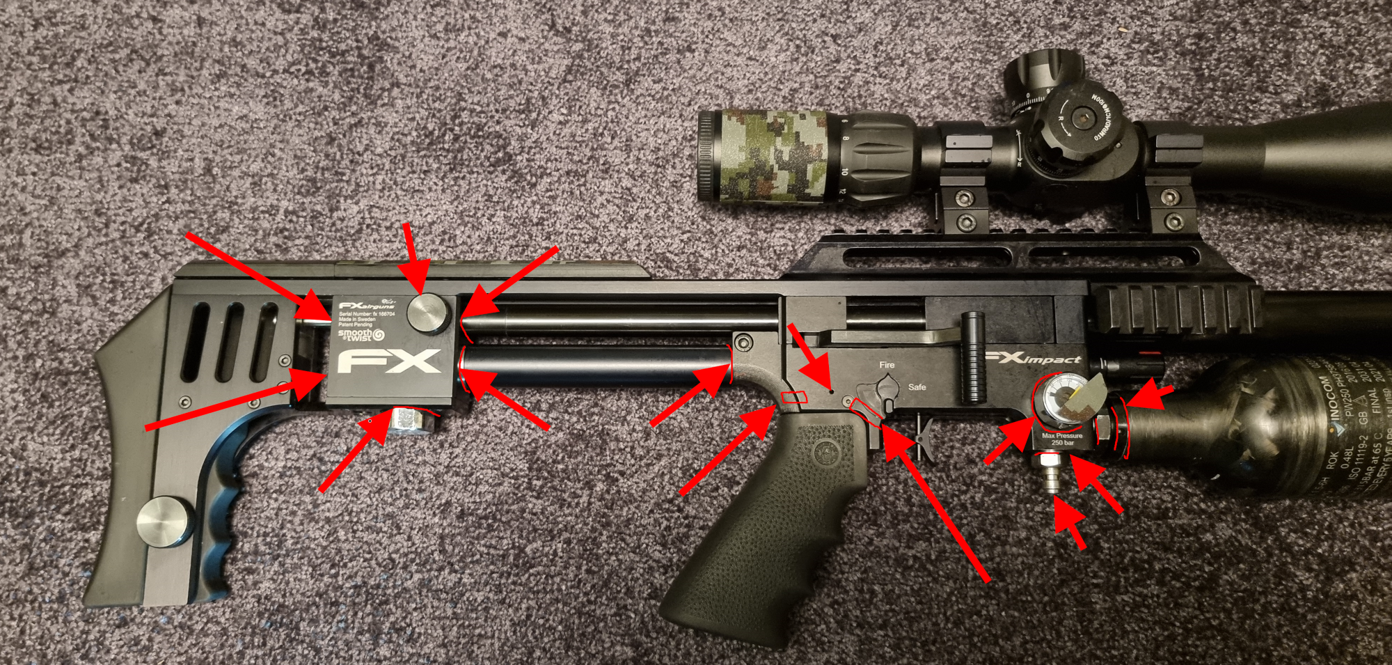

Am I missing something. Have recently fixed 3 leakages. Regulator and both 2x1 orings in the cavity plugs.
But now 1week later its leaking again. Approx. 1-3bar/hour so its not super small.
But I cant find it. I have checked all these places 2-3 times now with leakage spray/foam.
Any ideas? don't know what to do next except complete re-sealing except the ones I already changed.
But How can I not spot a leakage this big.
Tried a balloon on the barrel for 2 hours but nothing, unless it leaks into the shroud and out somewhere else?

But there is and itch in my brain. Its not logical. Why do I not find the leakage when checking all places it could leak from.
Its like the air is vanishing through the steel. Even tried again with a friend next to me to judge whether Im crazy or not.
