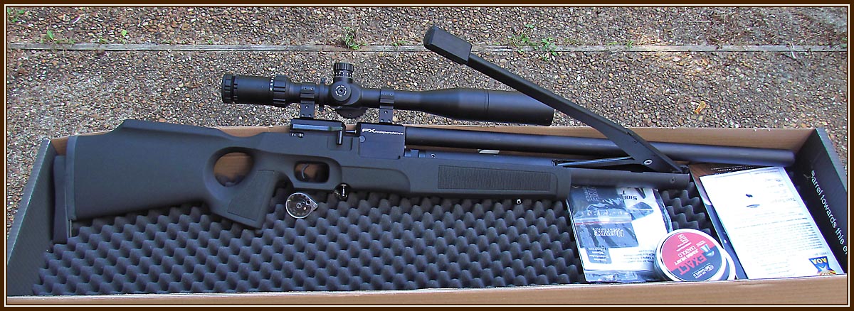

anyone have one ?

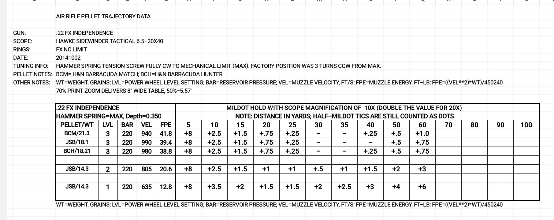

It's very versatile. I have the hammer spring set to max and pump the reservoir to 220 bar for each shot. You essentially act like your own regulator. It's possible to make several shots in a row without pumping if a quick follow-up is needed. But then you have to pump more to restore the pressure to your tuning baseline.
I found three pellets shot with a similar trajectory (minimal windage shift) on high power ('...' on transfer port knob).
A different pellet was best at mid ('..') and low power ('.'). FX put only punch marks on the transfer port adjustment knob with 3 detents for low medium & high.
On low power, only one pump is required to restore the pressure to nominal, great for plinking. Three pumps for medium where I do most of my pesting, and five pumps for high.
It has a very well designed shroud with a single baffle in the end cap. Extremely quiet on low and medium.

Last week a .22 Independence in excellent condition, was for sale at AOA, for a really good price. It didn’t last long.
I was afraid to go back to AOA and look at it again, AirGunShooter
Thankfully it sold or I would now own 2 of them
Mine also is a 22
Bought it well cared for over the summer
The previous owner liked JSB 18.1
Theyshoot great, but I prefer the 15.9's and shoot from 190 Bar for 3 very consistent shots
@Feinwerk mentioned that he has adjusted the hammer spring.
How is that accomplished.?
I do not see an obvious adjuster at the back of the tube
Not that I need to play with it yet
But it would be good to know

After removing the stock you can see a large brass screw on the back of the bolt block. It has a wide slot in it for use with a large flat screwdriver if I recall correctly. I used dial calipers to measure the depth of the screw as set by the factory for my baseline and noted that distance in my tuning notes. Then I turned it clockwise as far as it go to bring the velocities of low and medium into ranges that I thought were useful.
Then I experimented with reservoir pressure and settled on 220 bar, which seemed give a good balance of accuracy and surprisingly quiet report with this spring setting.
