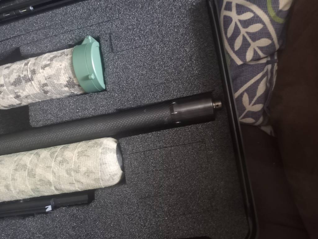

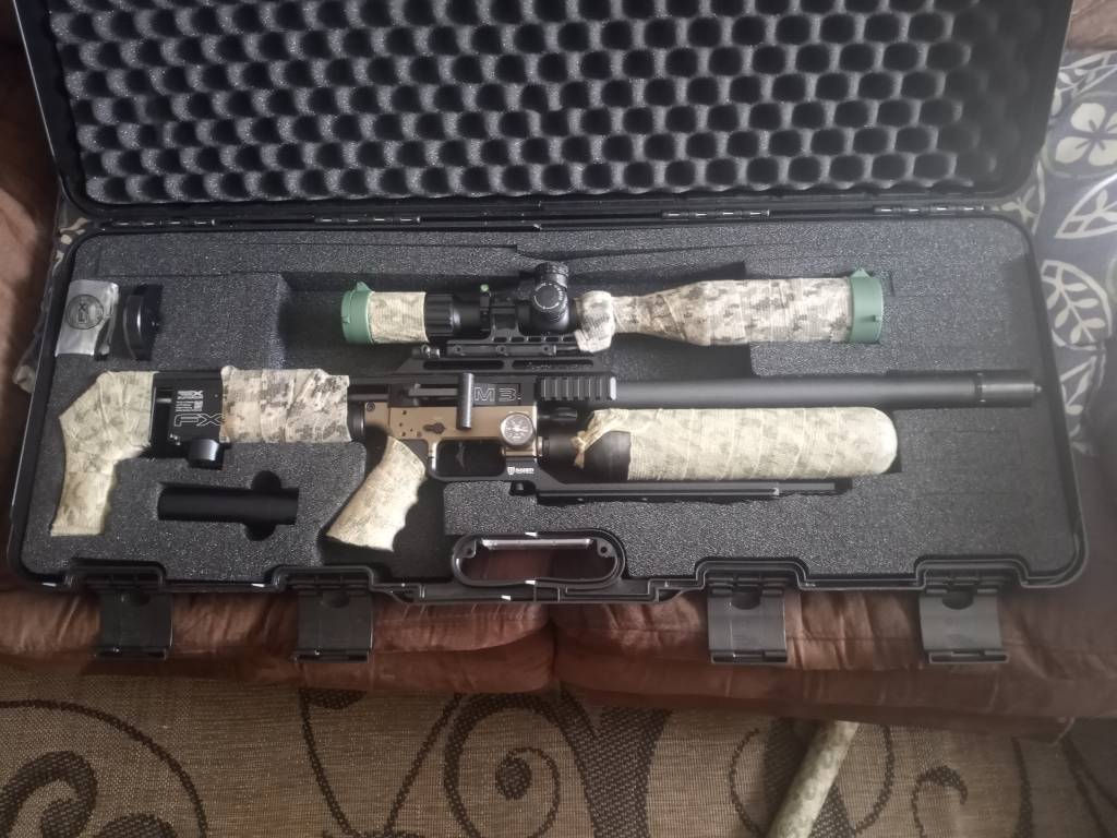

Yes, the tuner has a carbon fiber shroud I had one sent it back because it was defective so they sent me another defective one and I returned it for a refund. Bad finish on a $180 part to go on my $2200 gun I don't think so. New stuff should look new.
Like I said, you can just leave the first part of your moderator on it and remove the rest to make it fit in your case. I can't find the video but it's out there somewhere. You need to leave the first part on because removing it and putting it back on with just a little bit different torque would effect the harmonics of the system.
