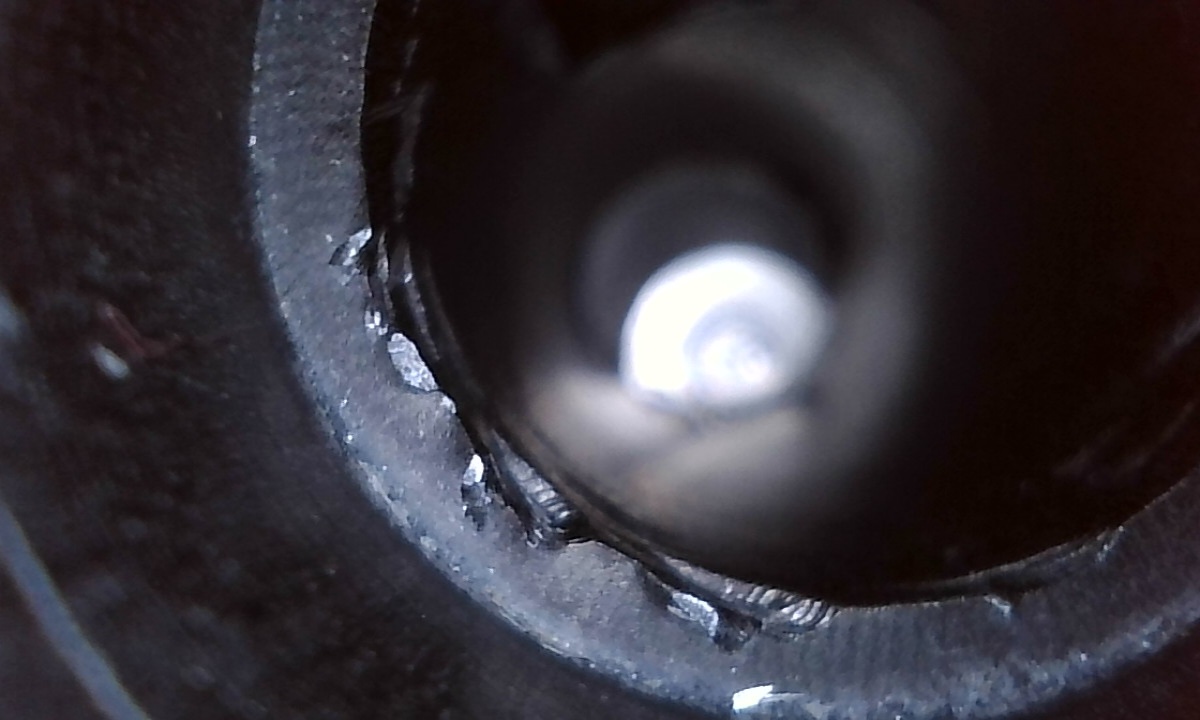

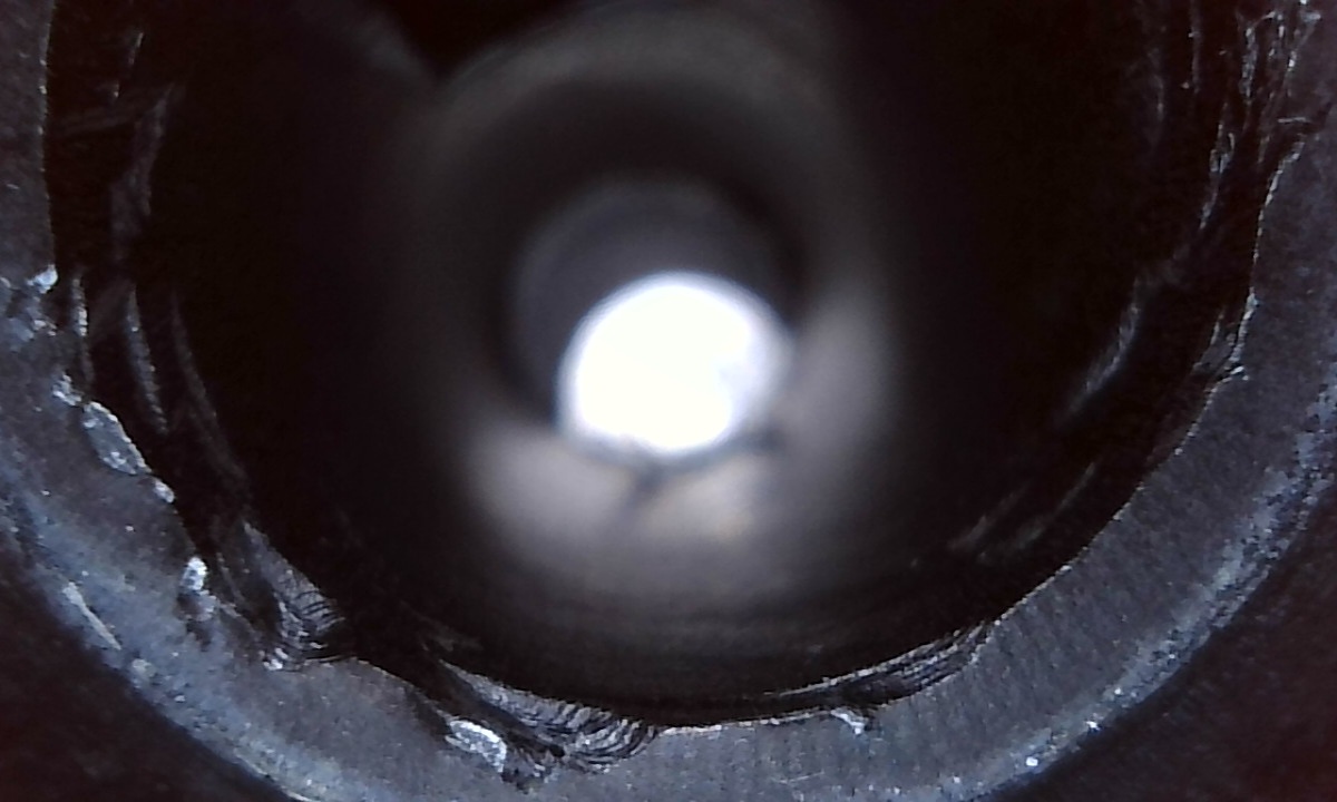

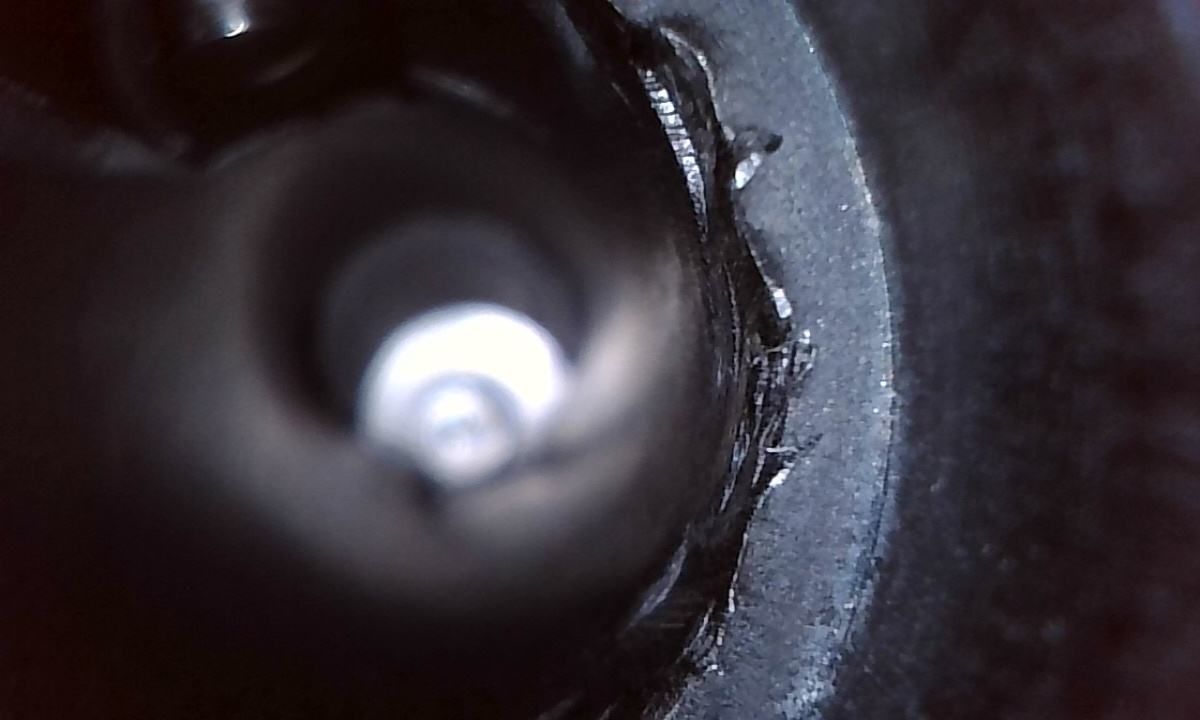

I'm not sure if anyone else experienced this. Had the King now for a few months and noticed a pretty big extreme spread and POI change. I keep my settings the same and clean the barrel when needed so I dug deeper. Looks like the hammer chamber in the block is getting debris possibly from the pellet probe assembly and getting jammed up with the hammer. When I took out the trigger, there was aluminum debris all over it. I took a few pics with my bore scope.
Good thing is, it will be covered under warranty!
Well, I'm not sending the whole gun in, so unless they can send me just the block, I'm on my own. I have a buddy that can clean it up. I ended up polishing the hammer, weight and spring and when that didn't change a thing, I inspected the bore and behold.
Call and ask if they'll send you a new receiver! Or....you could just send in the receiver/block. My friend had an issue with a Crown mki, original reg went bad, couldn't fit a new mki reg as the threads were an odd size and they ended up installing a new receiver/block out of warranty for well under 200, basically a new gun and this was during the legal fiasco! I did all the leg work for it as my friend lives in the mountain, FX takes care of their customers and I don't even own one....LOL! I hope your issues are resolved quickly.
I'm not sure if anyone else experienced this. Had the King now for a few months and noticed a pretty big extreme spread and POI change. I keep my settings the same and clean the barrel when needed so I dug deeper. Looks like the hammer chamber in the block is getting debris possibly from the pellet probe assembly and getting jammed up with the hammer. When I took out the trigger, there was aluminum debris all over it. I took a few pics with my bore scope. View attachment 424754View attachment 424755
Is that the transfer port under the barrel ?
