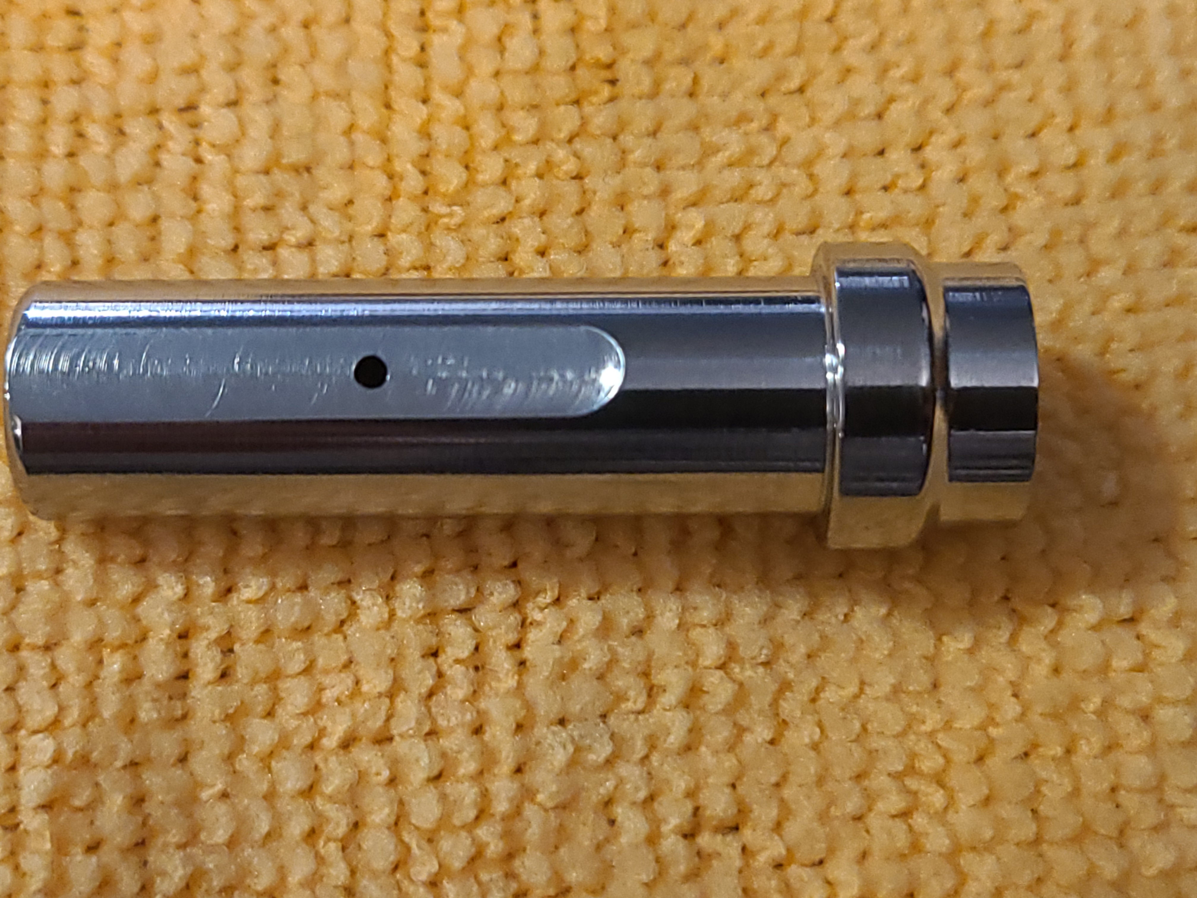

The hammer spring doesn't touch that part of the block, but the hammer does. It's possible the hammer had burs on it, but I had already polished the hammer before I noticed the damage. So the hammer in good shape from what I can tell. Here is a picture of the hammer. The widest part on the hammer to the right is what made contact.

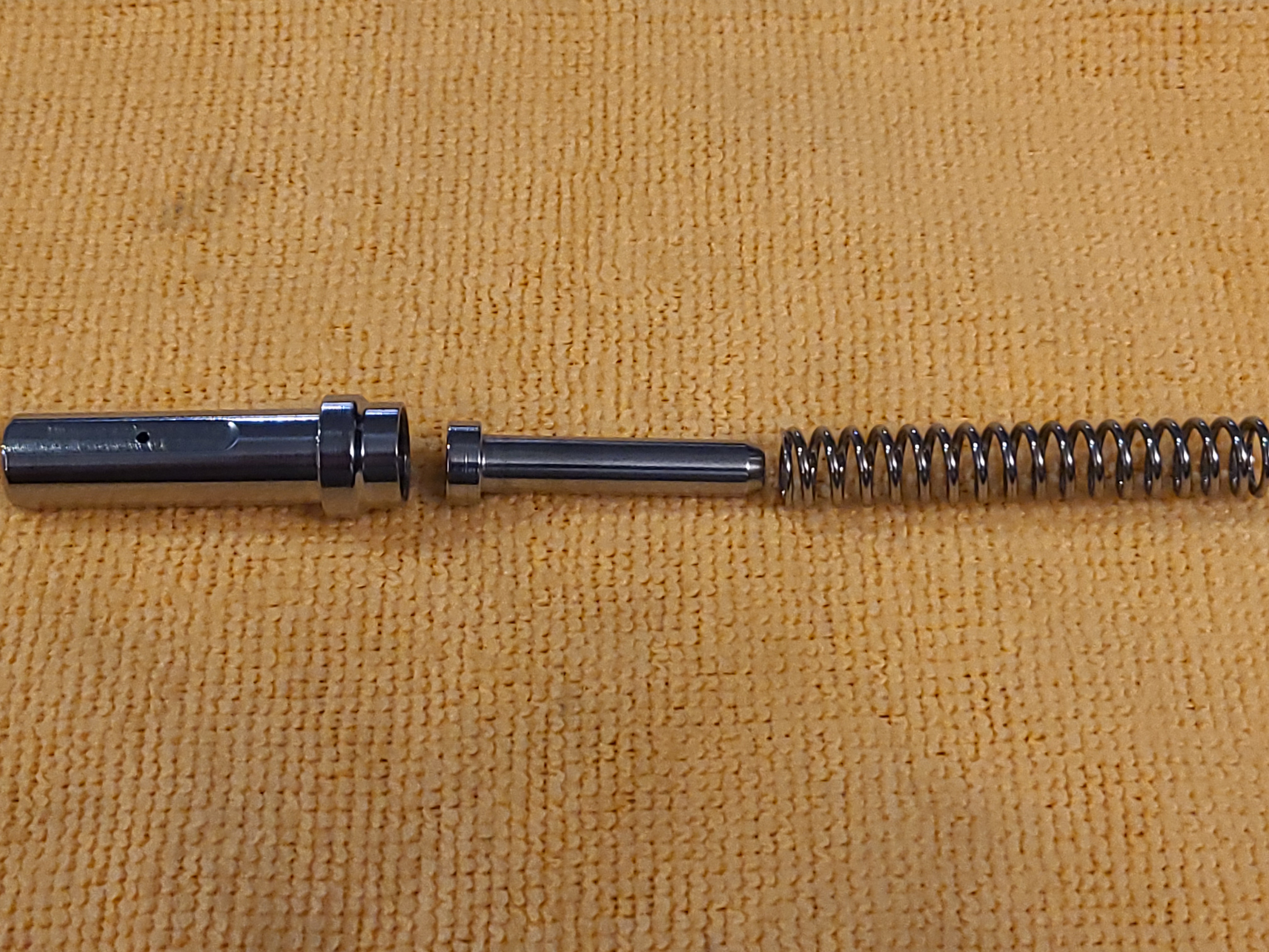

Here is the complete hammer assembly.
The hammer spring doesn't touch that part of the block, but the hammer does. It's possible the hammer had burs on it, but I had already polished the hammer before I noticed the damage. So the hammer in good shape from what I can tell. Here is a picture of the hammer. The widest part on the hammer to the right is what made contact. View attachment 425485
That's a great job of polishing Ta-Ta.
