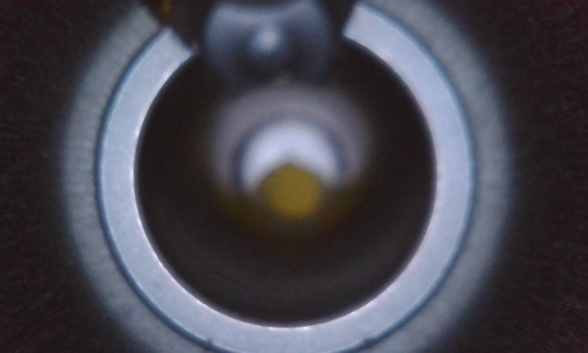

I'm not sure if anyone else experienced this. Had the King now for a few months and noticed a pretty big extreme spread and POI change. I keep my settings the same and clean the barrel when needed so I dug deeper. Looks like the hammer chamber in the block is getting debris possibly from the pellet probe assembly and getting jammed up with the hammer. When I took out the trigger, there was aluminum debris all over it. I took a few pics with my bore scope.

I can tell you this was not due to user error!
Utah Airguns came through and I finally received my replacement block. Looks good so far.View attachment 457077
