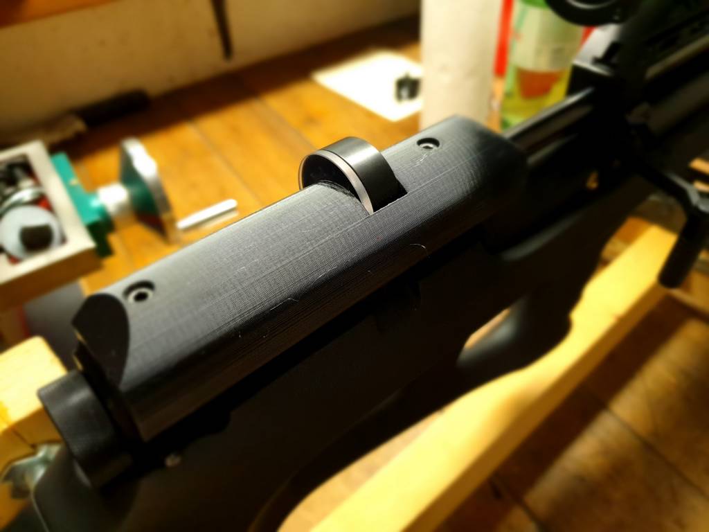

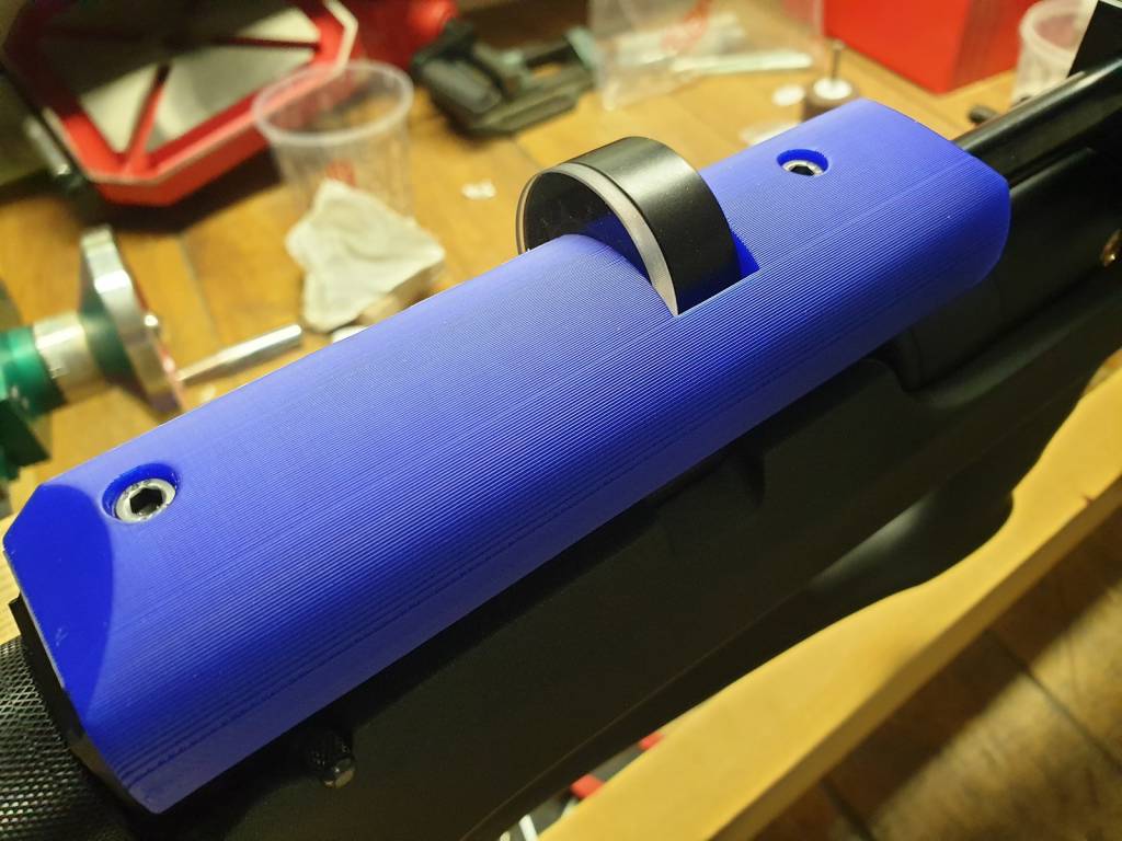

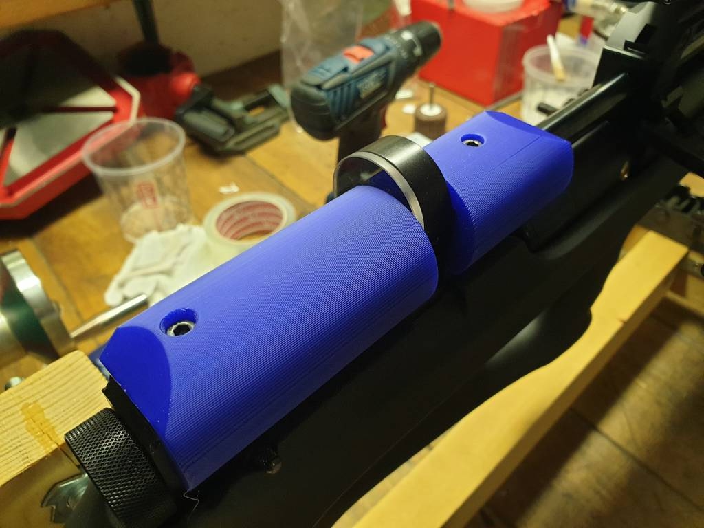

LEFT HANDED FX MAVERICK - Airgun Nation On that idea I've designed and 3D printed few variants of the cheek piece (blue ones were test pieces)
If anyone's interested I'll be uploading both designs (one piece and two piece) to thingi in a few days, just want to refine the shape a bit (make it thinner on the right side)
