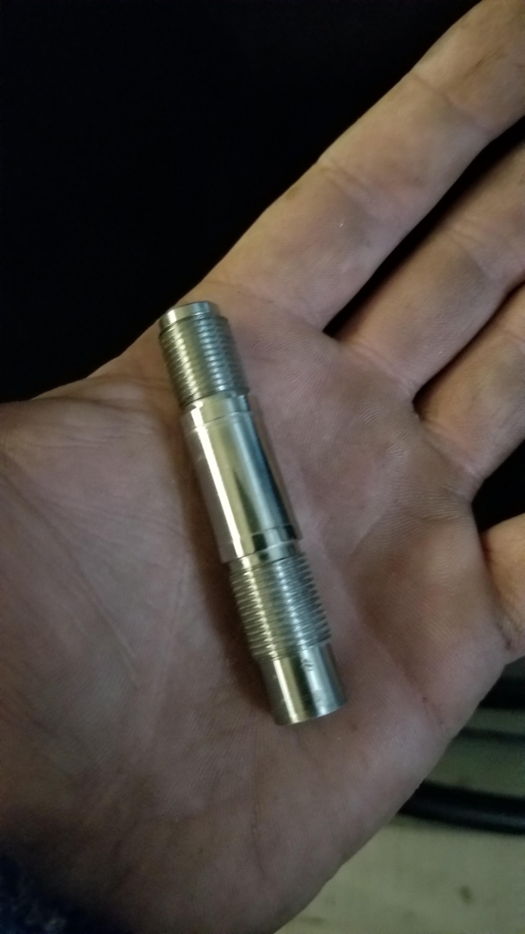

The thing is the liner needs to be a certain wall size to be able to press the rifling on from the outside regardlessof caliber. OD of the assembly needs to be the same to fit in the same block. So the differing OD of the liner creates a situation where caliber specific parts are needed to hold the liner centered.
Bagnall and Kirkwood airgun spares sell this part
As well as the liner lock that are caliber specific. So if you had a 700mm .22 and wanted it to shoot .25 all youd need is the part pictured in .25, a liner lock in .25, probe, liner and brass barrel inlet. You can save some money by going this route.
What they could do in the future is make the liner lock and pictured piece in .35. Then offer caliber specific delrin bushes that make these parts work with any caliber.
