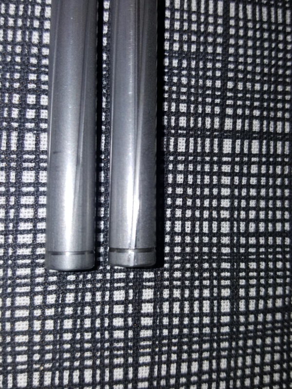

Yes sir, the factory is getting an engraving machine in order to label each liner, but has not obtained the machine yet. For now, you have to trace the twist rate that is observable from the exterior of the liner. The Pellet Liner A is 1:30", the slug liner should be close to 1:22". You can also tell by measuring the choke of the muzzle end of the liner. The choke on the Pellet Liner is 0.02", where as the Slug liner should be 0.06".
naujas draugiškas atsakymas iš „FX Service“
How to measure out of the choke?
on the slug liner is not grooved from the beginning
