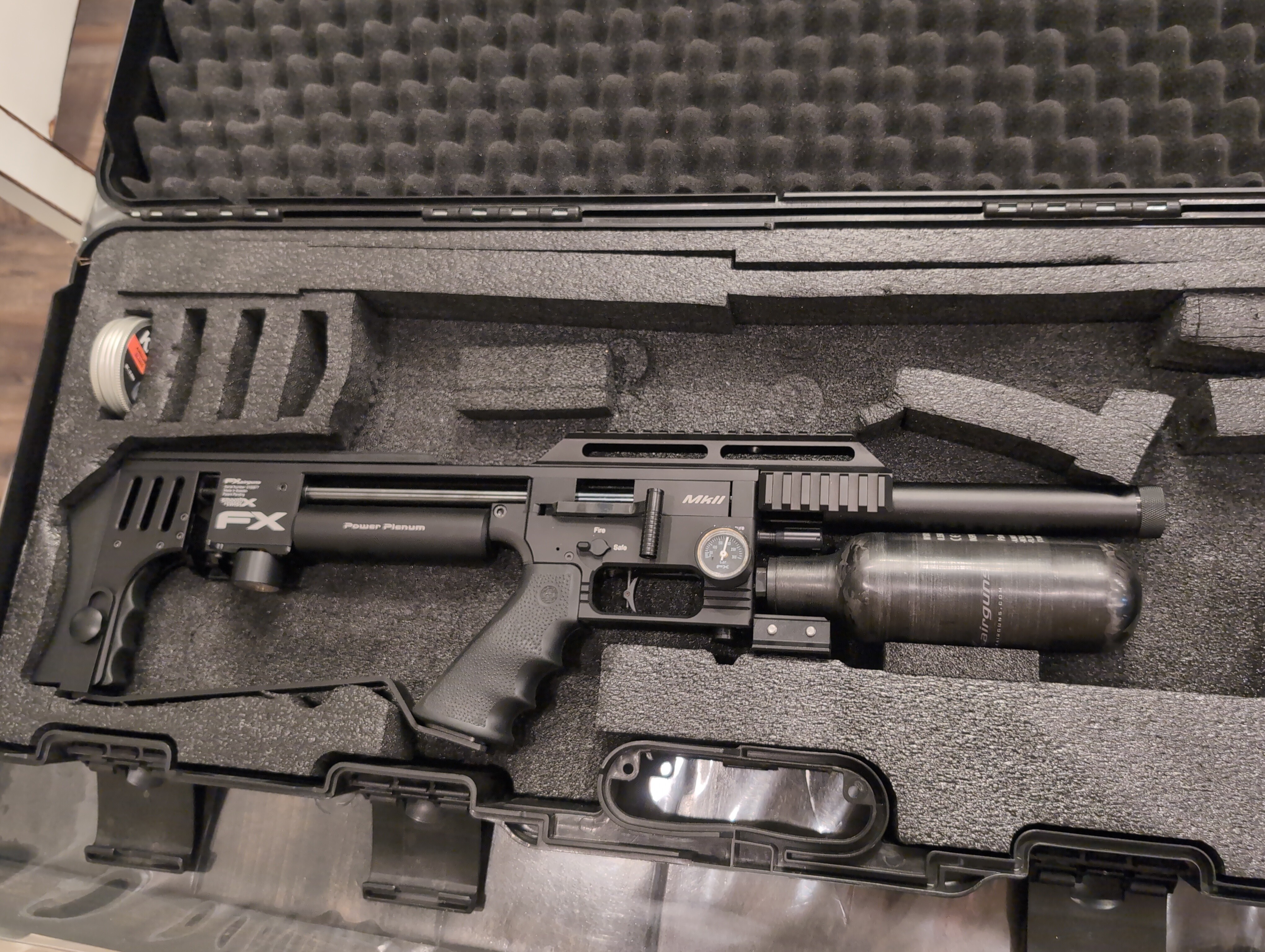

I picked up a used M3 .25 Compact barrel I'll be putting on my MKII. It has the standard/stock liner. I'm pretty new to this and was wondering if there's a max recommended pellet weight you can shoot through the standard liner? Thanks.

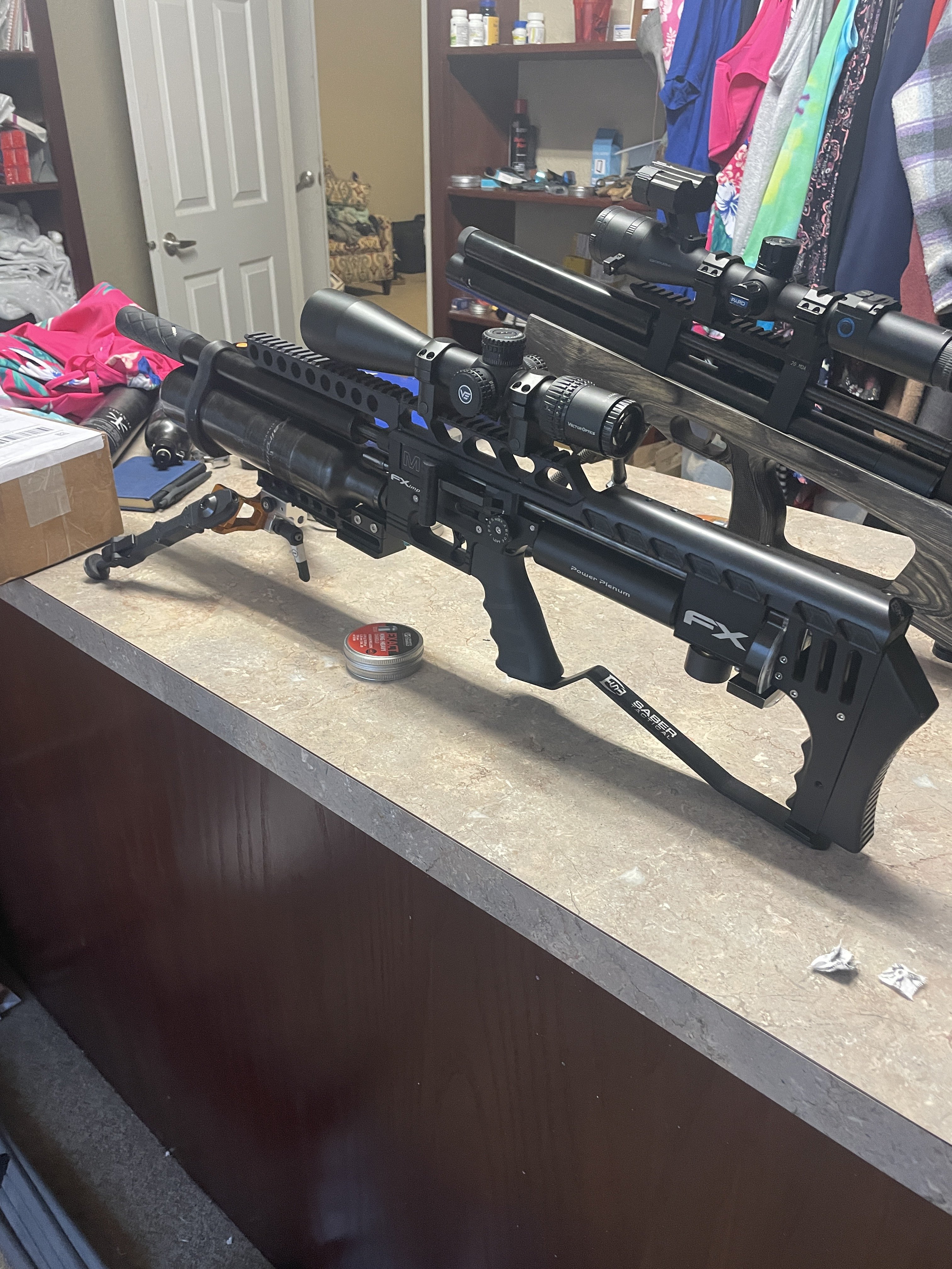

Good question, 33.9 for sure. I can launch 25.3's out of my .22 MAVERICK Compact 500 but I did put the new heavy soda straw, it really did help with the higher twist rate even with light pellets at higher speeds so heavier than 33.9 is possible with a higher twist rate liner, I"ve found that the AEA 33.9's work awesomely well in my Mav. VP 600.
