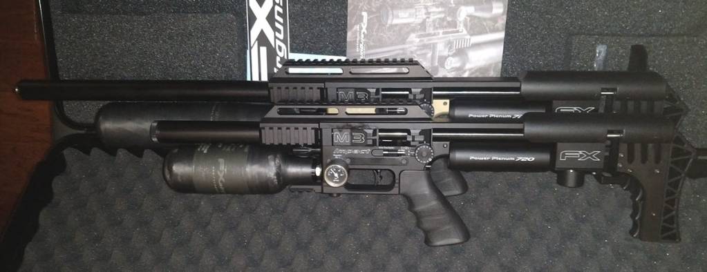

Curious where you found this info. I searched Topgun site for 'cheek,' and found no reference for M3. Perhaps, an aftermarket part? Here is the M3 side-by-side photo of both Compact and Sniper I pulled from the shelf. Same cheek piece.
I had ordered a Sniper from Topgun and when received it had a shorter cheek piece, around 6.5" long. It did not match the cheek piece on my M2, which is about 2" longer.
A buddy has three M3's that he was making some spacers to elevate the cheek pieces. He made three all the same only to find out that one was different. He had ordered the Compact version on two and a Standard on the third (all different calibers). He had measured the spacers to fit the shorter cheek piece not realizing that one was different (longer).
Since mine had a shorter cheek piece, I assumed that it was originally a Compact that Topgun made into a Sniper by installing the larger bottle and longer barrel. I swapped my cheek piece with him so that he now could use the spacers that he made and I now have the longer cheek piece.
Maybe there isn't a difference, maybe FX was using up older part stock? I note that the schematics show a date in 2019 as a change. Could be?
mike
Thanks for the explanation. A curious situation indeed. I went on to check all FX Impact M3 airguns in stock, and sure enough found one M3 Compact with a longer cheek piece 8-1/8 inches in length. The other 9 airguns including other M3 Compacts have a 6-1/2 inch cheek piece. All airguns are 1 month old. I cannot determine any logic or pattern. Probably different OEM. Thank you for education. Live and learn.
