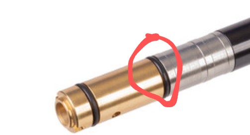

They told me this happened with some M3 Power Block guns. It is caused by an internal O ring in the rear block that is there for the 35 cal only. The third O ring creates a vacuum of sorts and it requires a great deal of effort to break the vacuum. They told me to remove the O ring and the problem would go away. They also said that while they are aware of the issue it is not a common situation.

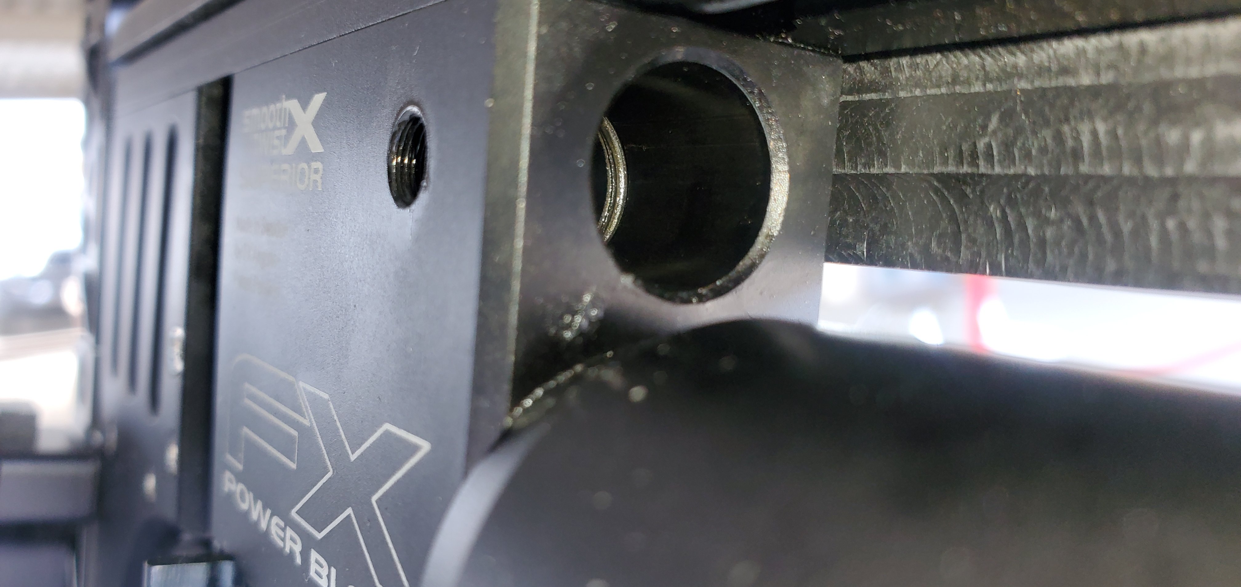

I think I have a answer that may not require pounding out the barrel, or removing the oring in the powerblock.
Allen.
Oh it's this oring here dunno if everyone has that slot.
And it is mentioned here in Ernest's install video.

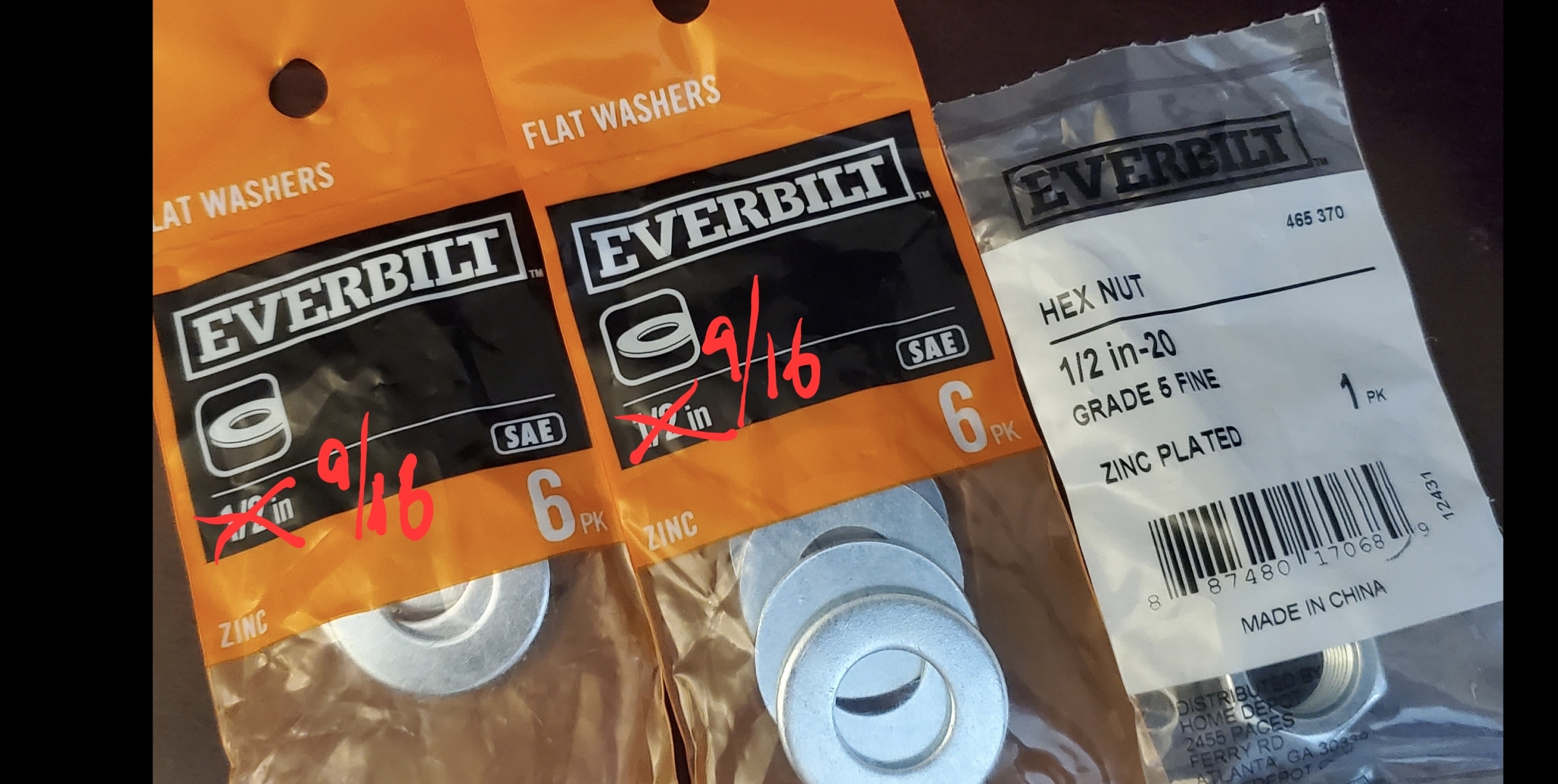

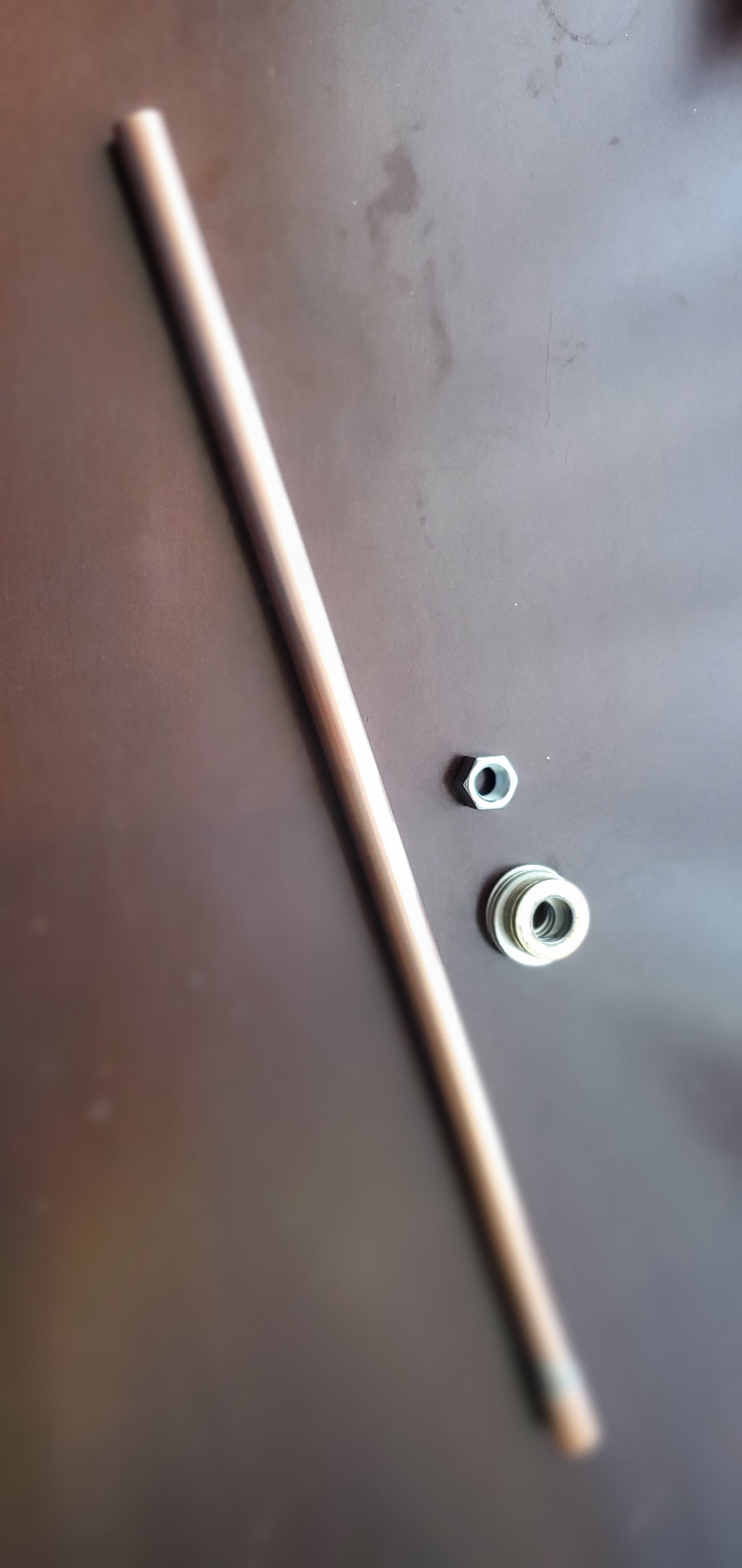

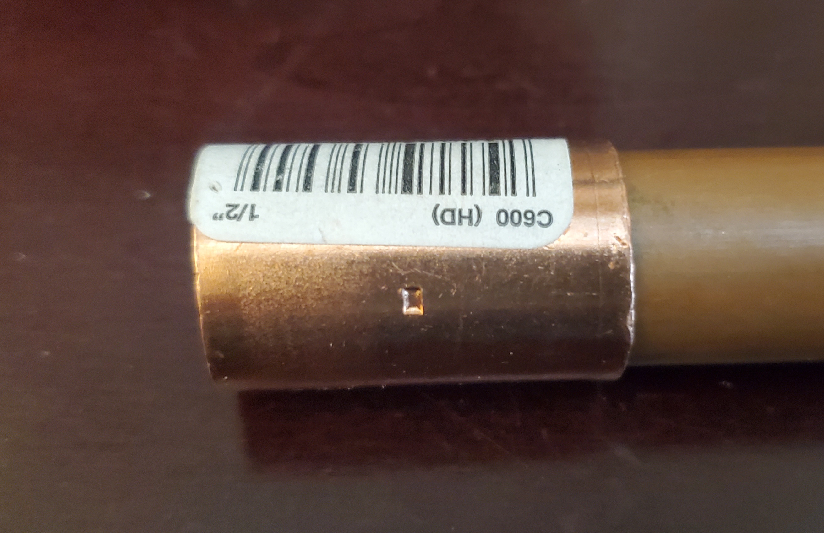

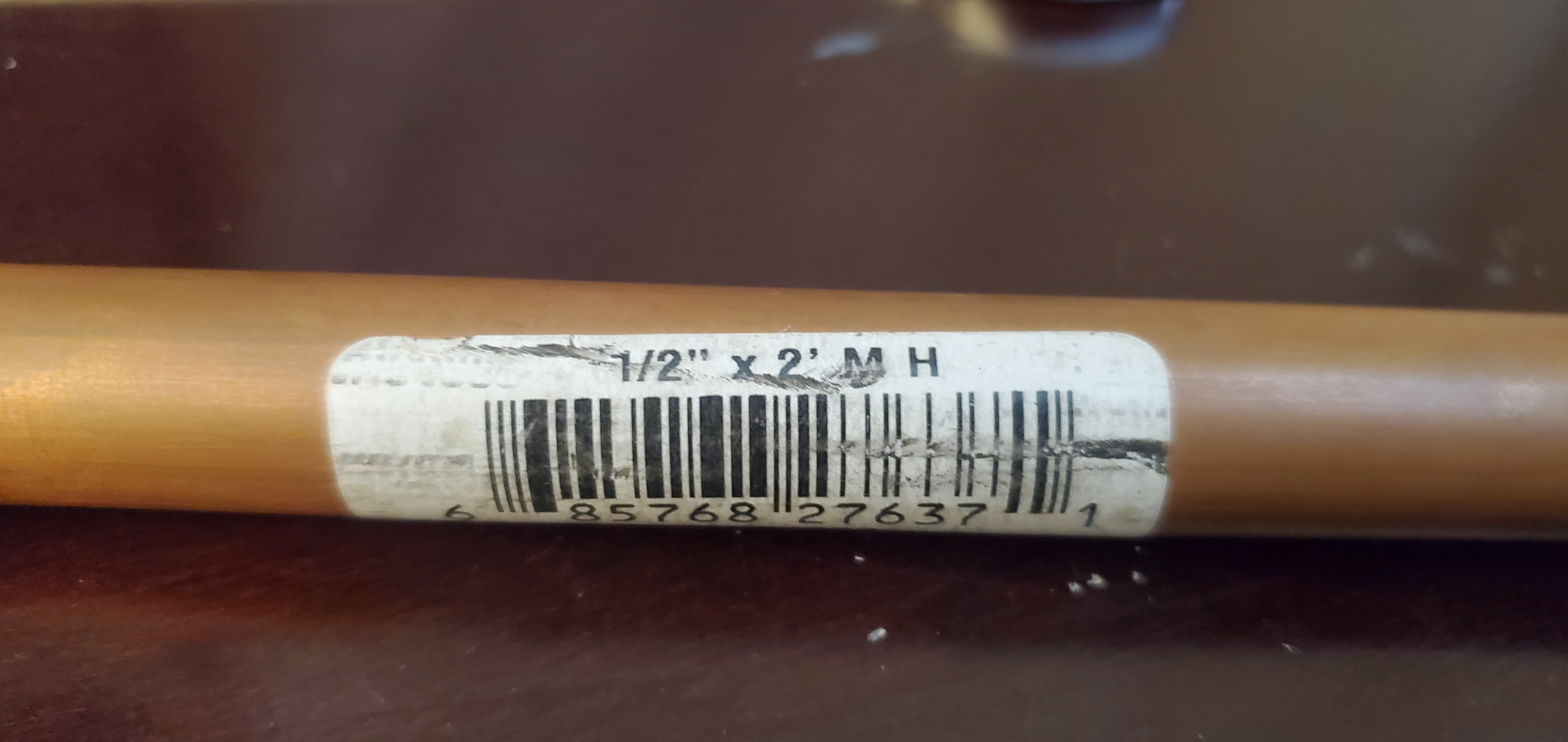

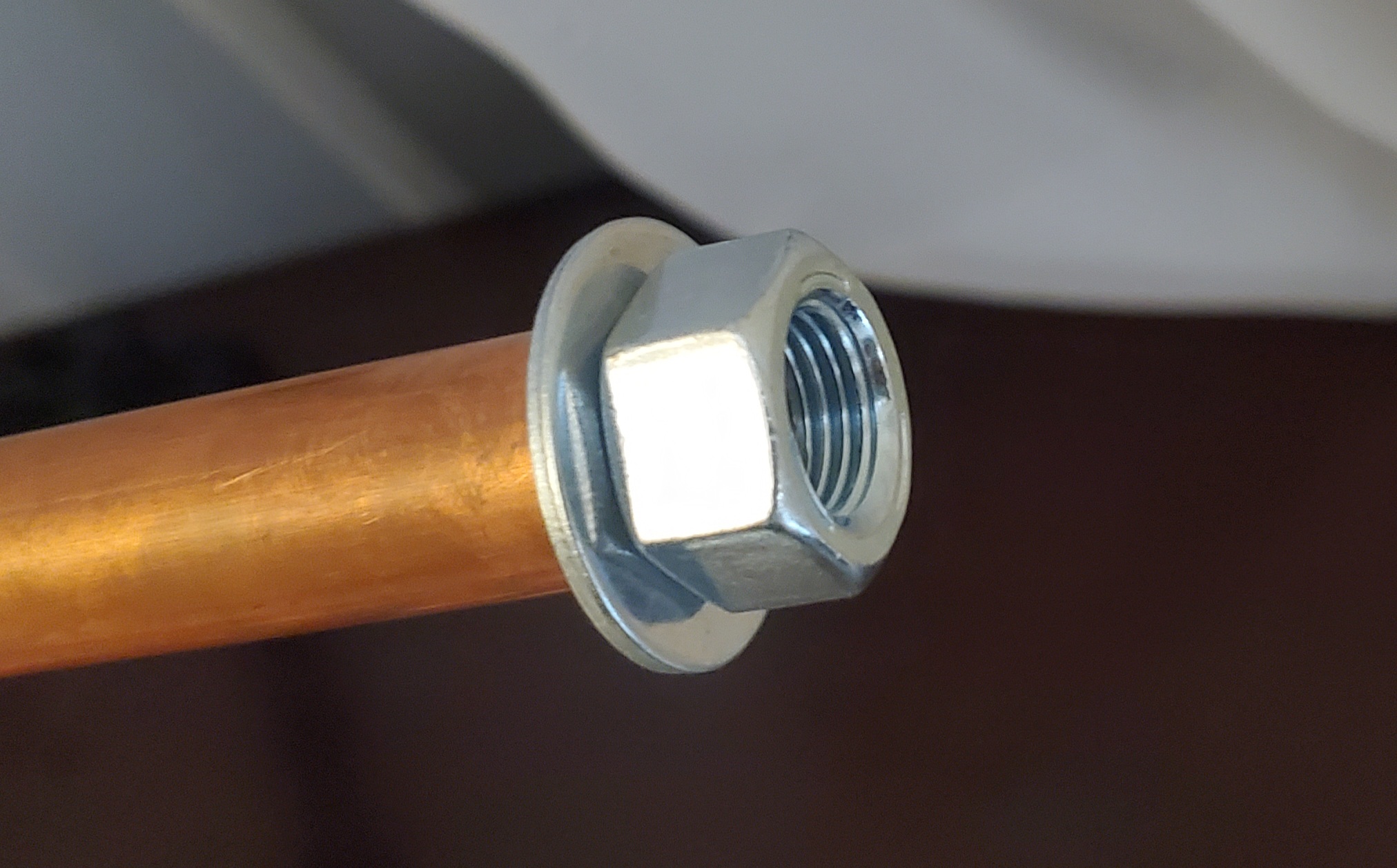

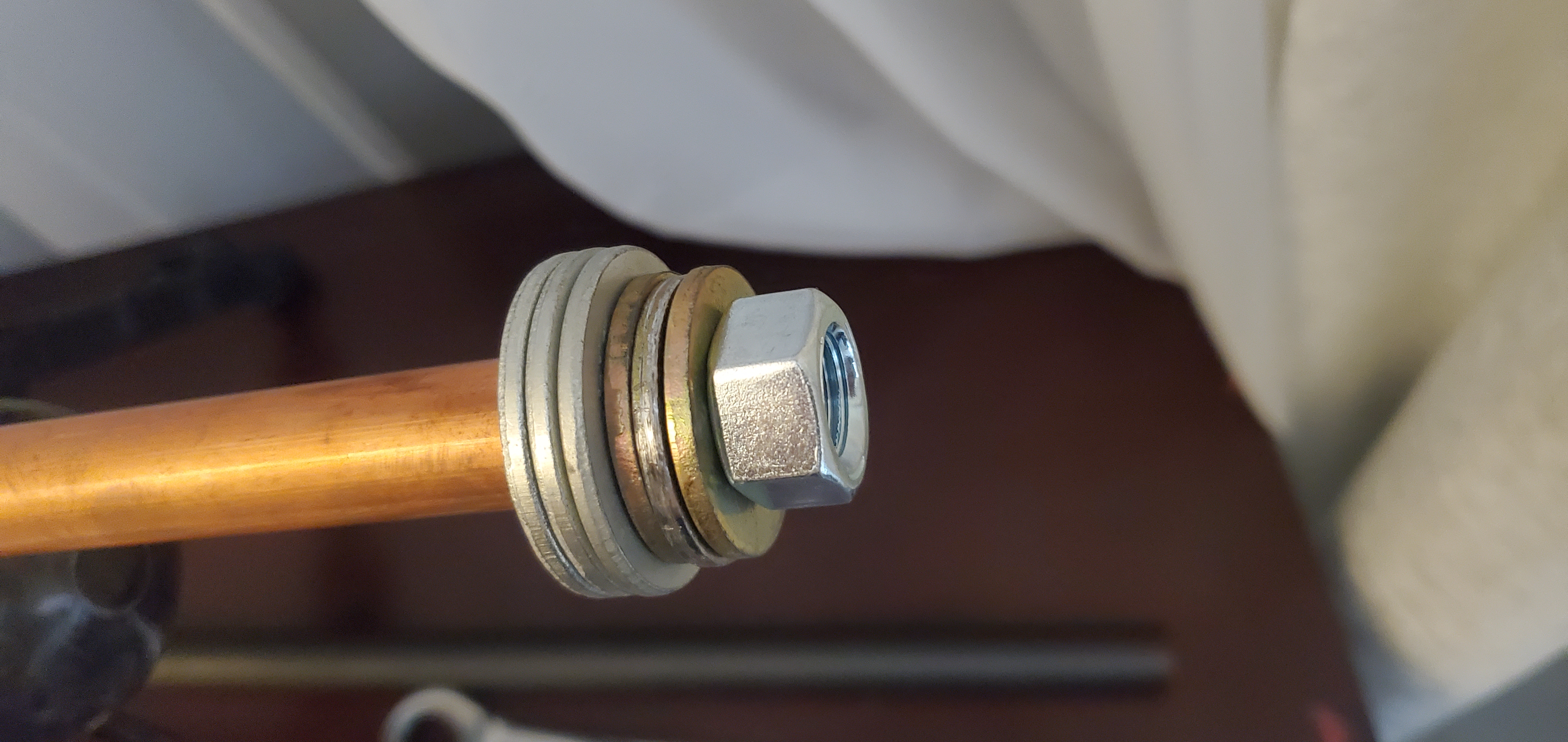

For those of you who have not run into this yet and have the powerblock with a o-ring in the powerblock itself. Or maybe you installed the oring and did not know what that could do. This is a way to remove the barrel without fear of overly man handling it possibly bending the barrel, barrel end, or damaging a moderator because you wanted to use it as a handle. This would be good to have a round if you already experience this in mild form where you had to do some tugging but it popped out. I will modify this post as I gather correct parts as I need this tool sitting around if I plan on leaving that oring in the Power Block. Source a 1/2 - 20 nut and metal tubing, I found some 1/2 copper pipe, also sourced a stack of washers.
Parts list for tool should you desire to go to store to get items and don't have in garage.
1/2 " copper pipe
One joint for said copper pipe.
1/2 " stack of 9/16 washers and a 1/2 - 20 threaded nut sorry I bought wrong washers. Make sure washers will slide down barrel but not the copper piping. I used a file to open up the washers a bit but if you buy 9/16 washers it should not be a problem.
Of course remove set screws as needed to remove barrel.
1. Remove shroud

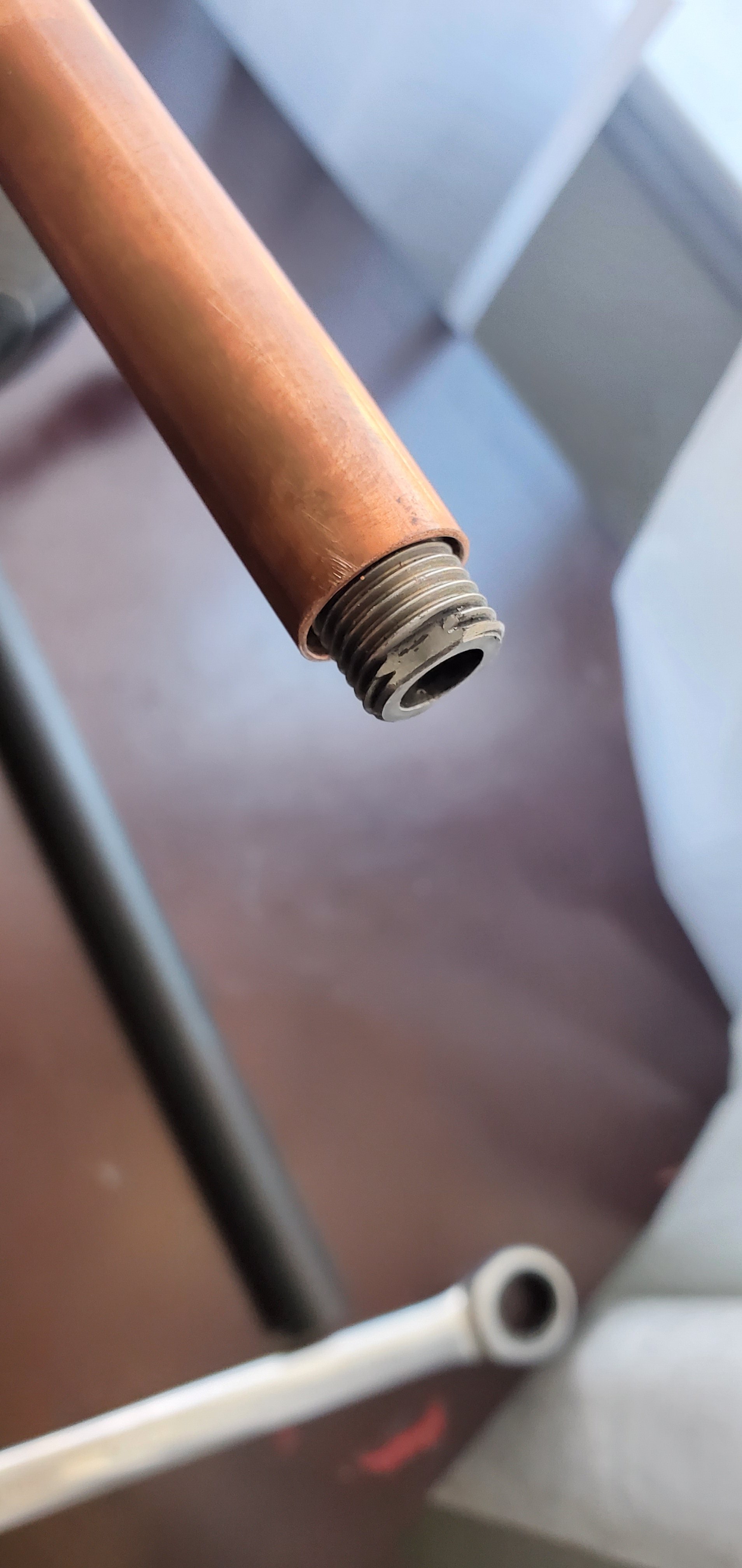

2. Solder joint to copper tube, this will allow joint to sit just outside the base just like the carbon tension tube does.
afterwards cut tube length and allow enough space for a washer and the nut to thread on to barrel.
3. Assemble tube washer and nut. Don't use your tensioner nut. Make sure there are least three threads that go into the nut.
4. Tighten nut until nut stops. Back off nut
5. Add stack of washers while still allowing enough threads for nut...
6.Tighten nut again until it stops.
7. Repeat until barrel comes loose.

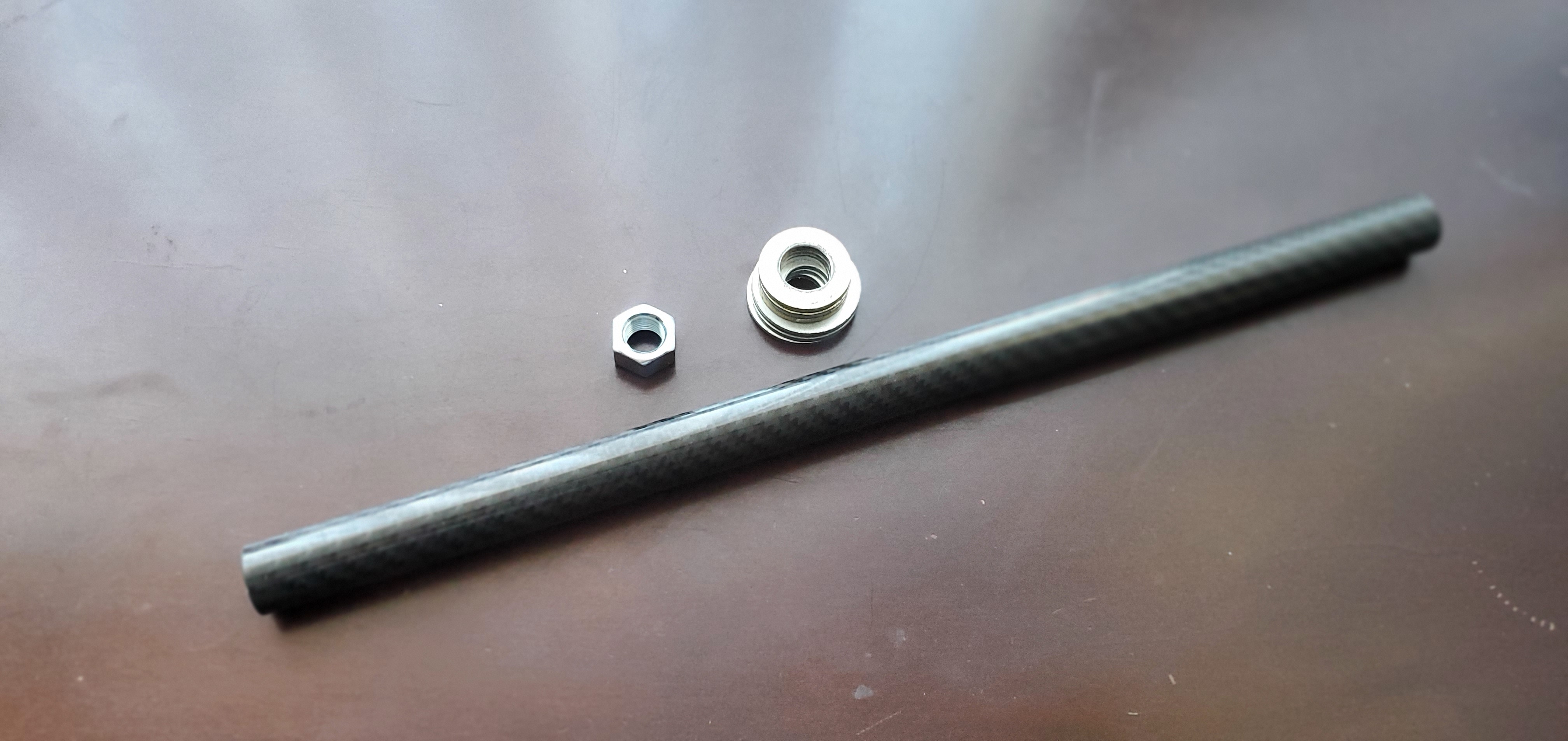

You may hear a pop as you pull the barrel out at the block by hand. But most likely just a hiss like this with the barrel puller that was just made...
It will end up like this for this tool.
Or this if you want fancy..
If you are a wimpy old man like me you will need this tool.
Allen

From what was mentioned earlier (I think it was this thread) that extra o-ring in the block is not necessary and not on the units smaller than 35 cal. I'm just assuming that the oring is there to help all the gases from the shot be used to help propel the heavier slug forward. But some extra gas does build up in between the orings and lock the barrel in place.
But to address your question. I don't remember seeing a exit between the two o rings.
