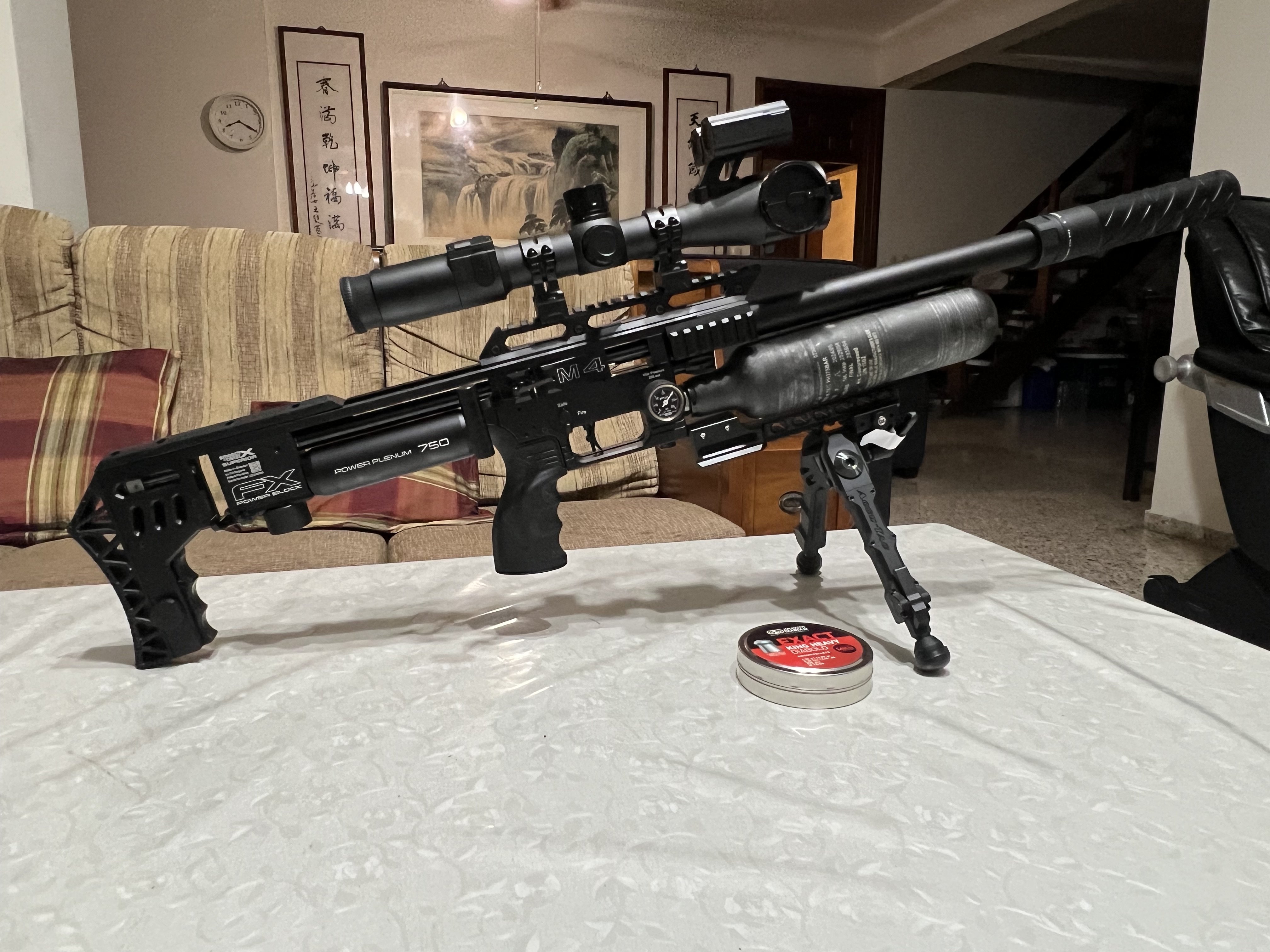

went to the shop, saw the last black .25 600mm in the inventory, knew then got to have it to stop the itch!!, anyway, have the shop to tune the speed to 920ft/s for the JSB king heavy 33.95gr that I am going to run in the meanwhile. Thank you all for all your helpful advices.
